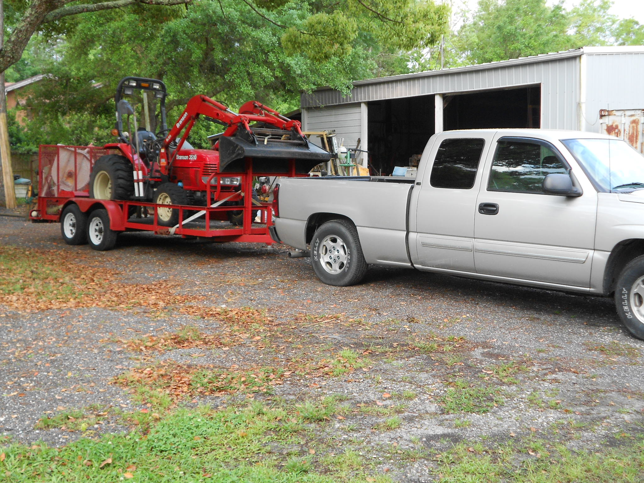

Once in a while I go through a test of the breakaway system, it goes about like this;
1) Get the rig on grass or dirt,
2) pull the trailer plug to simulate the trailer detaching from the truck
3) pull the breakaway pin on the trailer
4) drive forward a couple of feet and check that all trailer wheels have skidded, i.e. all trailer brakes were locked.
5) leave it like that for 10 or 15 minutes to check that the trailer's breakaway battery can hold enough charge to keep those brakes ON (legal requirement is 15 minutes).
6) pull forward again to see that the trailer drags its wheels.
7) Put the breakaway pin back in, reconnect 7 pin trailer plug, finish a normal circle check, etc., get on my way.
CHEAP ain't the way to go with trailers and trailer brakes, we have but one life, etc. and even ONE un-braked thousand pounds wiggling around on a little ball behind me is too much.
