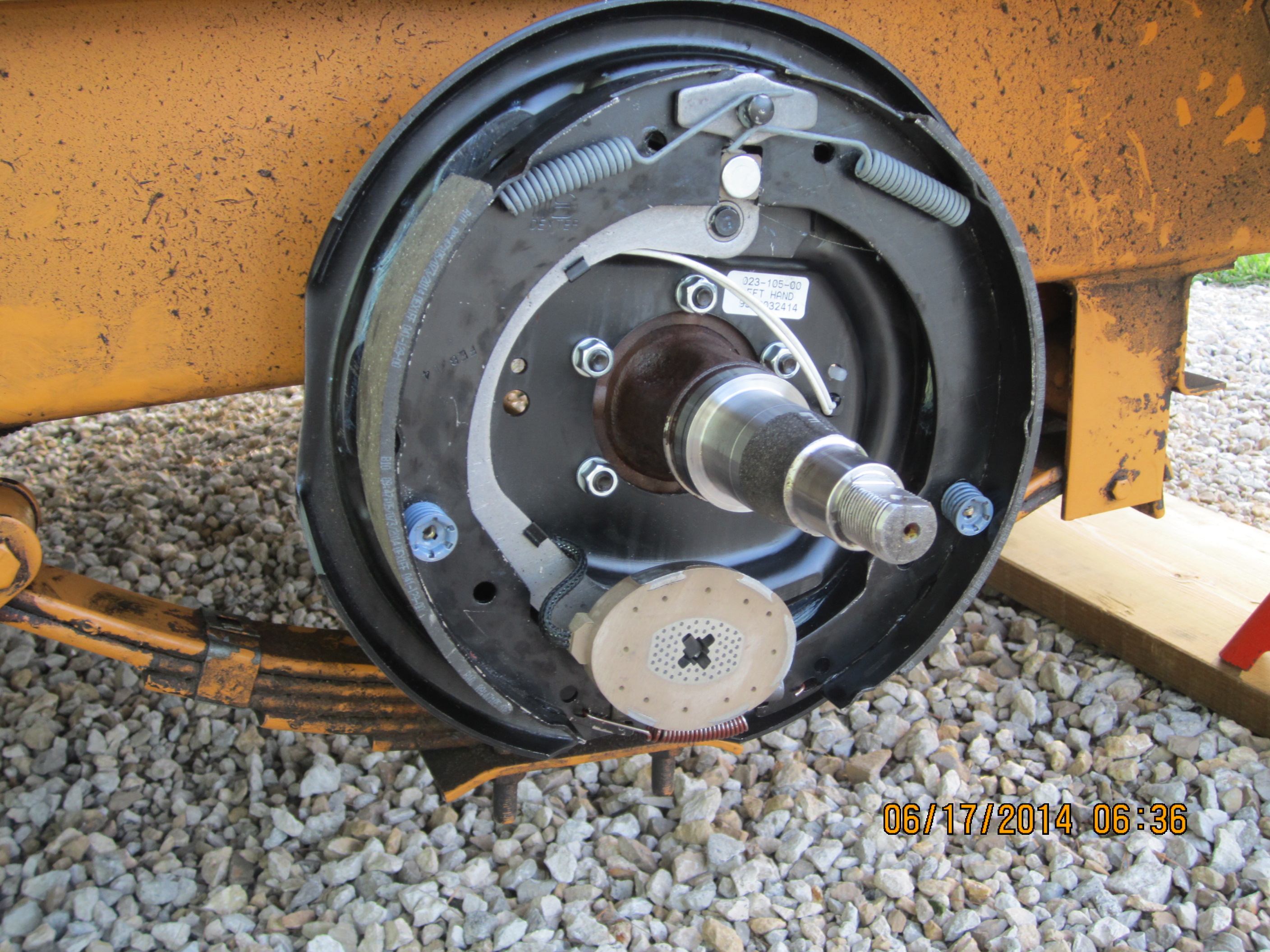

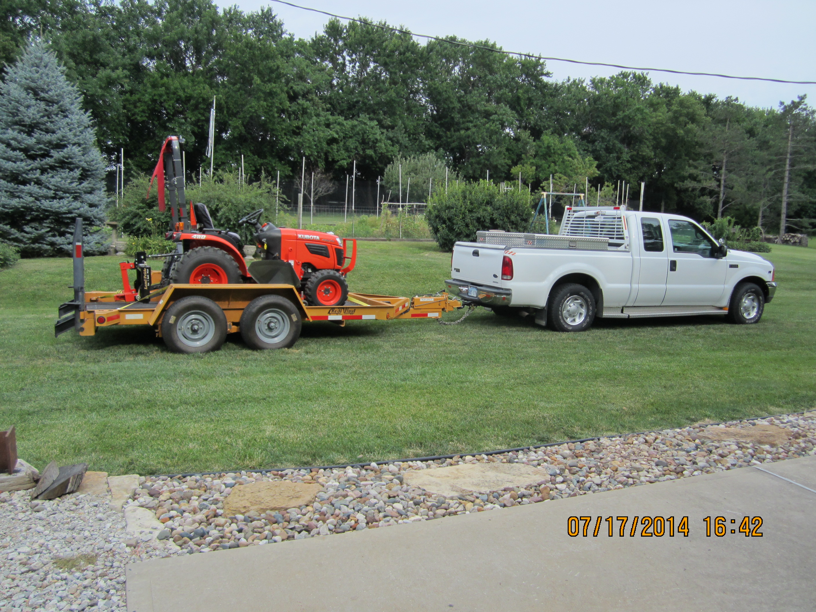

My 2006, 7500lb car trailer has never had the drums off and the brakes still work as new. The Tekonsha Prodigy brake controller make the trailer almost like it isn't there the brakes are so smooth.
I agree that drum brakes are old technology but with the right controller I would buy them again and not worry about it.

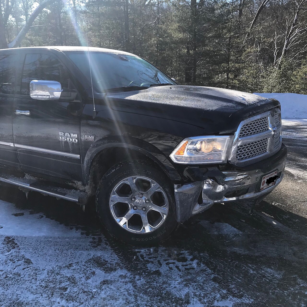

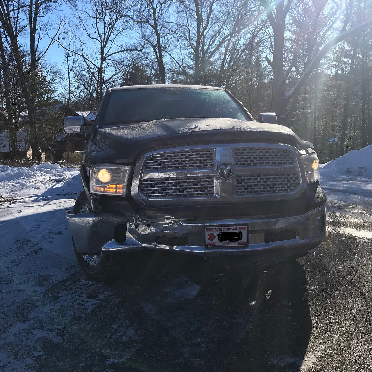

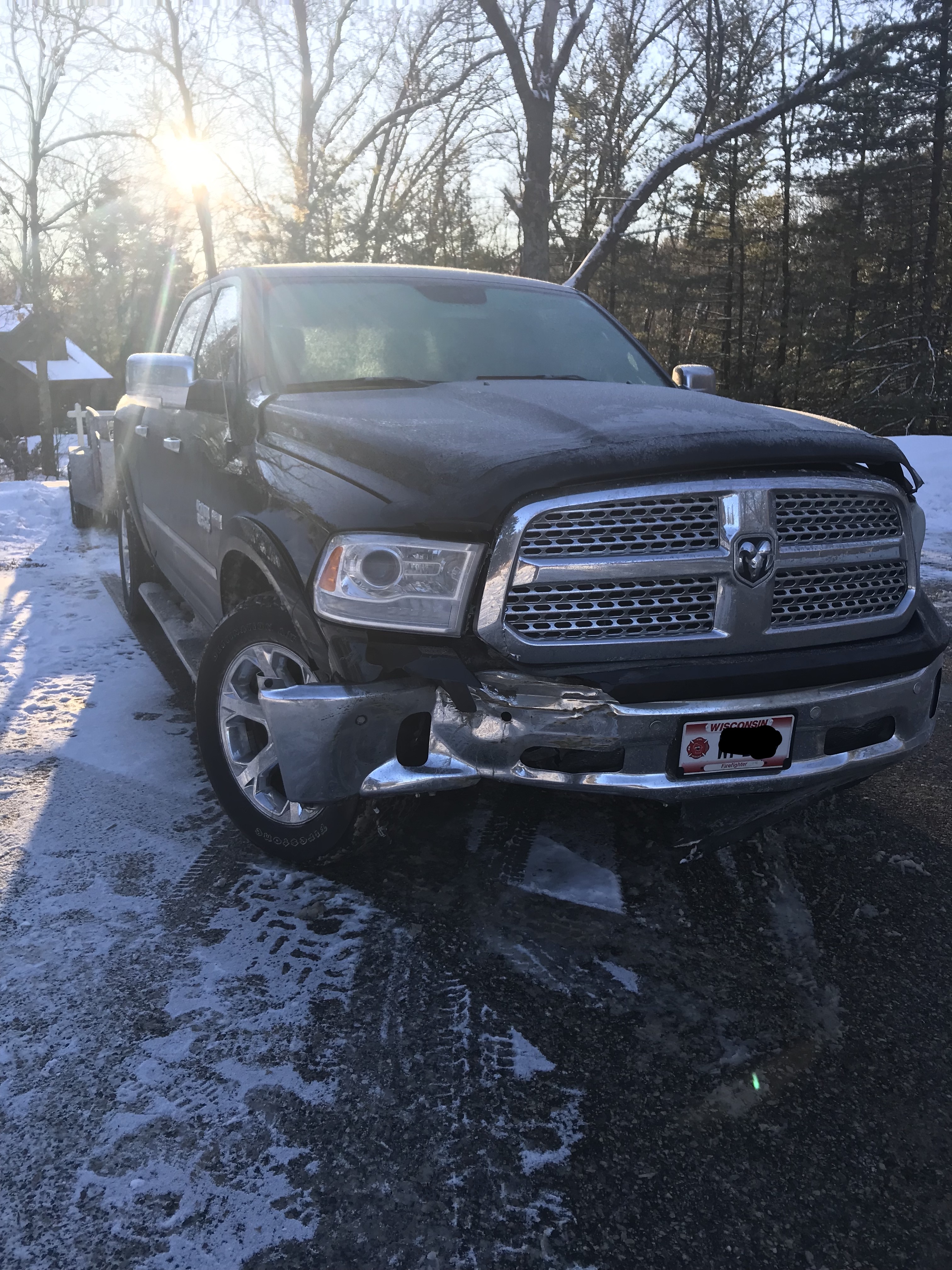

This last January 18th/19th we got our first round (slammed hard) with snow in Wisconsin... My brother (has his CDL and a Firefighter - drives big trucks etc.), came north from Madison area; family get together in Central Wisconsin. He was hauling a two place aluminum trailer / no brakes / trailer swinging like a pendulum; met the side rail on a bridge. Thankfully he was ok. Shutdown the I90/39 for a bit! Trailer totaled, truck (most likely) totaled - if you look at hood lines, truck tweaked - drivers door only opens 1/4 way.

Once a year or so I hit the grease zerks and check for bearing play. I spin the wheels while it's jacked up and listen for noises. As I said I have never had the drums off. I did adjust the brakes one time when the trailer was a couple of years old. It would probably be a good idea for me to pull the drums and check lining wear.
