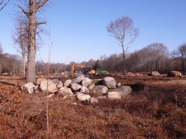

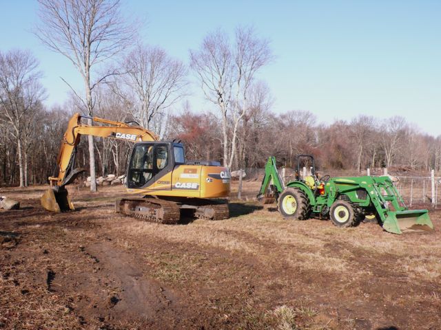

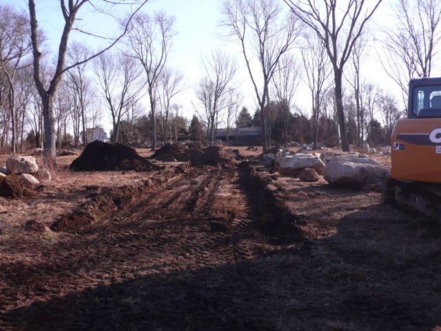

Some pics as promised in the next two messages. First pic of my JD5325 with the Case CX130B. Second pic is the rock garden. The piles were accumulated during a tree clearing a few years back. Third pic is road at subsoil level with rocks on side getting ready to be buried tomorrow. Later in the day today I moved more rocks to the staging area with the Case ex and my JD with a grapple attachment ....... Gary

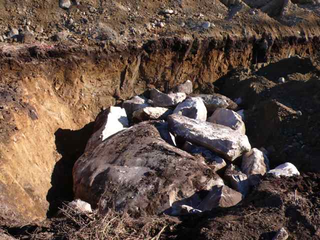

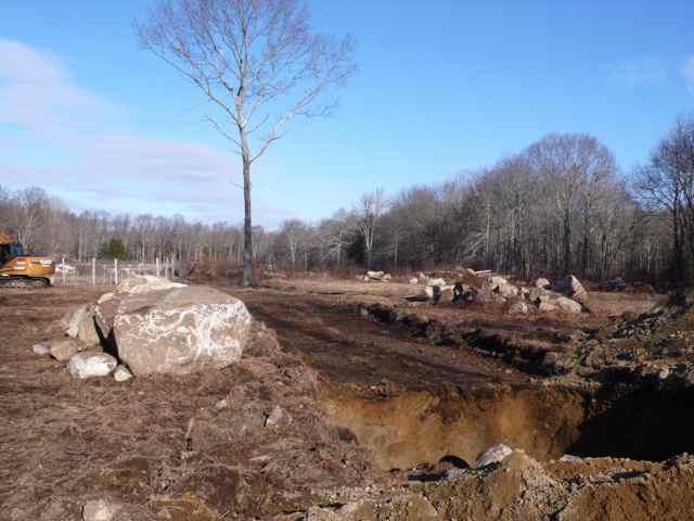

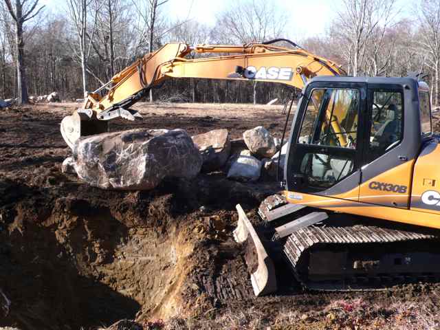

Update and a few more pics. Have been able to speed up the digging and the logistics, aka where to pile stuff. By end of today should be half done with driveway. Essentially I box a trench at 8ft deep and 15ft wide and drop/push the rocks in. The largest one went in yesterday...see pics. This CX130B excavator is using about 6 gallons diesel for 7hr day on mostly low revs.........Gary

If someone told me they didn't have time to do something because they had to go home and bury rocks, I'd think they were pullin' my leg. Obviously, in your case, that ain't true. You have got to be the only person I ever knew who buried rocks. I'm sure there are others, but you are brave enough to post pictures.;):laughing:

What's the trick to packing fill dirt around the boulders to keep the driveway from settling again and again over the next few years? Seems like it would be difficult to get a solid pack that wouldn't settle after rains.
Those are nice land scape boulders. Sell them off to the landscape outfits. Looks like a fun project.
Picker 77 - No real magic to it. I add subsoil back after each layer and the second layer of rocks get dropped to add some vibration. I do expect some settling over the next couple of years with rain. As it settles I'll regroom. In about 2-3 yrs time a house will be constructed at the end of the driveway and the cement trucks will pack it in more. After construction I will recut top, possibly roll, place geotextile, layer 2 courses of stone. I hope that does it. ...Gary
