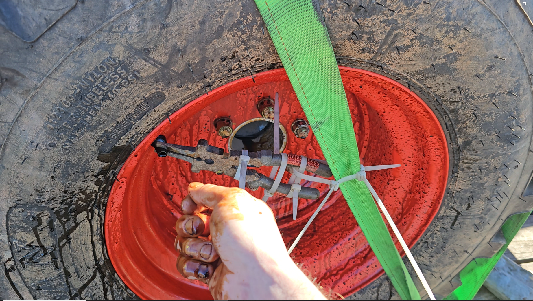

Watch me struggle with the valve stem cores blowing out. Rim Guard tire ballast is beet juice which can be corrosive to the glue that holds the metal core inside a rubber valve stem. If your tractor has rubber stems and is filled with Rim Guard I suggest you change your stems to metal.
Colby Valve XL is an extremely easy way to change or repair a valve stem without having to remove the tire. The Colby Valve XL is for 5/8 rim holes in larger equipment.
Colby Valve Permanent Valve Stem will fit any car, truck, SXS, and powersport vehicles with a .453 rim hole.
