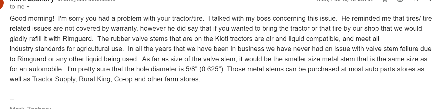

A while back I had both valve stems blow out due to RIMGUARD dissolving the cores glue in the stems and lost my ballast. I replaced the stems with Colby Valves and then I used windshield washer fluid to add tire ballast back. I paid $2.09 a gallon for the fluid in spring of 2024. You could also use engine coolant or antifreeze for ballast. I could not get RIMGUARD ballast anywhere close to me.

Unfortunatly I'm sure they are. Here is they reply I got about my issues. Credit to offering me to refill it but it doesn't sound like they care to fix the root cause.
to
   / DIY How To Add Tractor Tire Ballast Weight with video #10
That's a cop-out, for sure.
