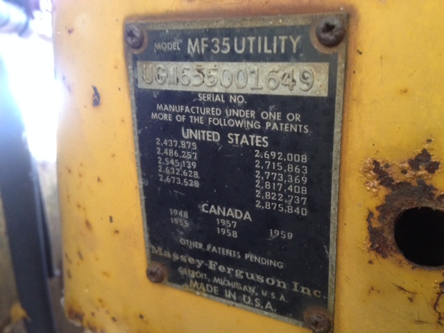

Edit: I can't seem to get the information on serial numbers on tractordata.com ( TractorData.com Massey Ferguson 35 tractor information ) to jive with mine. Weird. My guess is that it's a 1964, but I only suspect such because of other information I've come across online, none of which has to do with data tags.
Another question- are these tractors positive or negative ground? I've read both, and with as little info as I can find out mine I'd like to be sure before I try jump starting it/hooking a battery up. There are no battery cables on mine, the ground has been removed (though I think I see where it goes) and the positive has been cut at the starter.
Edit again to add more information. I've found that the first three digits of my serial number- UGM =
U utility
G gas (6:1)
M dual clutch

The serial numbers on some of the MF utility, industrial, and turf tractors are about impossible to use to find out what year model they are. When looking up parts for your 35 utility pay close attention to what serial numbers they are for (some parts are for before, and for after certain serial numbers). I have a serial number to year model list for some of the MF "yellow" tractors, I don't have any serial number to year model numbers for the 35 utility.

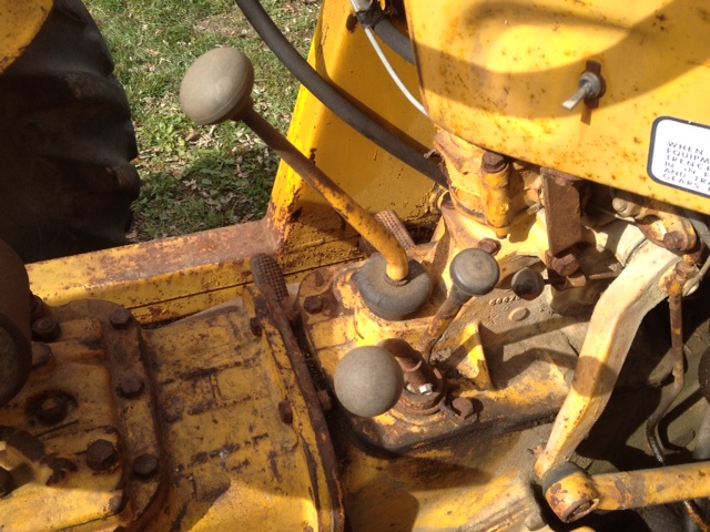

That's what I was beginning to find out, you just confirmed it. I've found a few other people on the web with variants of my tractor, but nobody can easily decipher the serial numbers. I'll keep digging, but in the meantime I'm guessing it's around 1964. Thanks for the heads up. I definitely don't want to be ordering incorrect parts. First on the list are new shifter boots to stop rain water ingress, getting it started, and changing all fluids.

Edit: aha! As user Central Vermonter indicates here:
http://www.tractorbynet.com/forums/...91-massey-ferguson-35-industrial-mystery.html
Central Vermonter said:
Okay, to add some more found information....
After referencing the production and serial number tables in my Massey Legacy-volume two I found that they list a 'turf special' and '35 utility' with these serial numbers:
1962 turf (gas) 656000001-656000105
1963 turf (gas) 656000150-656000614
1964 turf (gas) 656000615-656000892
1962 utility (diesel) 655000003-655000240
1962 utility (gas) 655000001-655000236
1963 utility 655000279-655001253
1964 utility 655001254-655001754
My serial#: UGM655001649
Confirmed 1964, and there were only 94 more produced after mine!

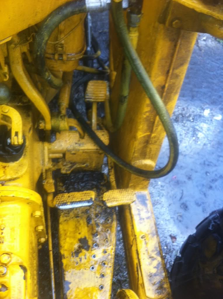

In this picture, posted by Ewgoetz in another thread, you see two pedals that your heel would sit on/near. Are those both brake pedals? (one for each wheel?) or is one of those a differential lock? I've got the same setup, that's why I'm wondering.

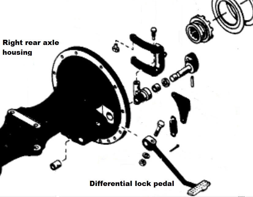

The two lower pedals are the rear brakes (left side, and right side), the little pedal up high is a foot throttle. Now I can add the 35 utility and turf numbers to my" yellow" tractor folder. For a differential lock there would be pedal on the right hand side kind of underneath the controls for the three point that you would work with your right heal (I hardly ever use it). To put a differential lock in your tractor it would be easiest to find a rear end with the lock as you would need a few parts, and a bit of work to add one on.

Ok that's what it looked like, but I'm new to all this and wanted to be sure. Thanks for clarifying! Glad those numbers helped you out too, I feel like I've given back at least a little bit now!
