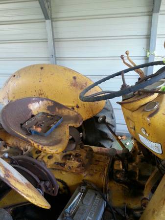

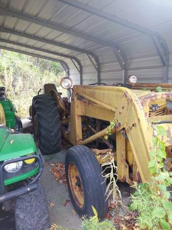

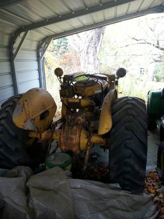

I'll get some pics up probably Saturday if all goes according to plan! In the meantime, i'll leave you with these three from the seller:
