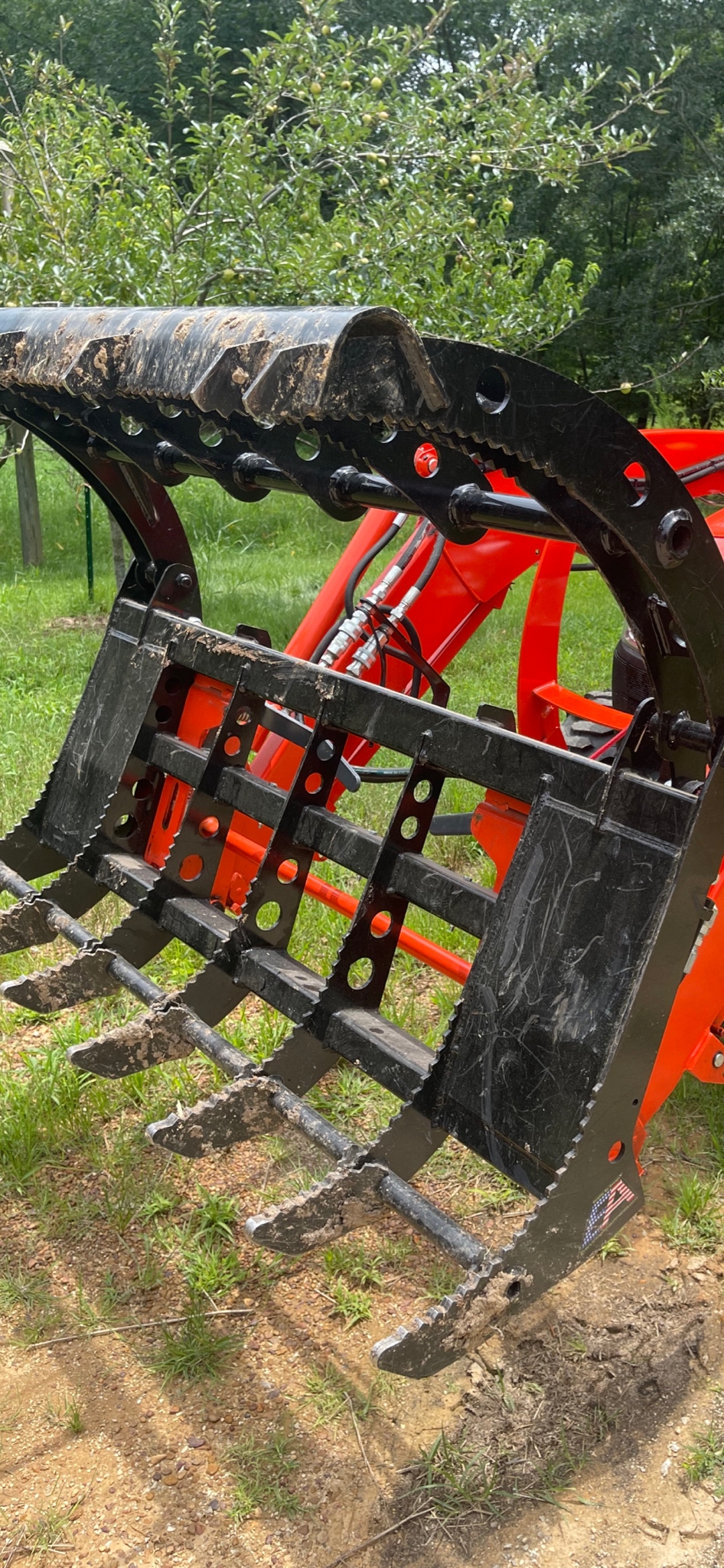

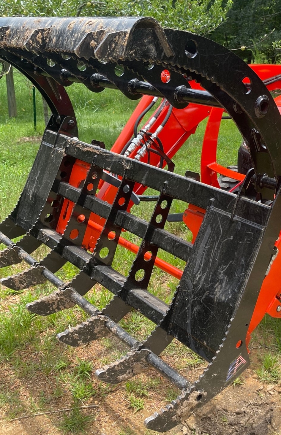

Pic of my year old wicked55
No hose routing issues
Cannot even see the hoses from the front of the grapple
I definitely wouldn’t want the hoses routed in a way that they could be damaged,
So if the newest version has the hoses routed differently, I would just re run them through the back tube..

So, as per my original post in this thread, the way those hydraulic lines are threaded through the holes in the lower tines of the grapple are not a potential issue?
Sooooo
LoL
Getting to the actual concern, and not the methodology of contacting a business.
I finally actually watched the video, it made it easier to see the concerns on the hose routing,
And I agree that it doesn’t look like a good idea at all.!!!
I currently have a wicked 60 on order, and I will contact them about the hose routing.
They used to be tucked into the back tube, and were protected pretty good.
I’m not sure why they are now going through the actual grapple tines, that looks like it is just asking for trouble.
Good eye on spotting it

Those hoses are routed through those holes to keep them out of the way during transit, and will be nothing like that when hooked to the tractor.
We still route all of our Wicked Root Rake Grapple hoses like this. 48", 55", 60", 66".
Totally concealed and out of harm's way.
The one in the video was still in its shipping arrangement.
Travis
