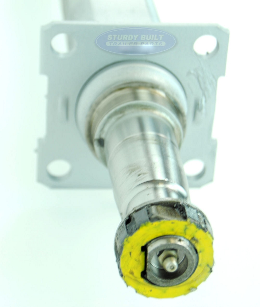

1 yard of dirt is about 3000#. 1 cu meter is about 1.25 yards, so almost 4000#, and depending on how much water is in it, it could be even heavier. You'll need a serious tow vehicle to move much dirt.
Here in the States, a trailer weighing 1500# is required to have brakes. I don't know the requirements in Costa Rica, but if you're on hilly roads, I'd sure recommend it regardless of the weight! It may be possible to add brakes without much cost depending on the axle. What you need is an axle with a brake flange. If you have that, you'll need a backing plate that bolts onto the flange and a brake hub (and the wiring), everything else is the same.
I'm pretty mechanical, so I could probably get some kind of brakes on there. What I can't wrap my simple little mind around is how to actuate them, be it electronically or tying into the cars brake system? I know electric trailer brakes exist but they don't seem to be readily available here. Maybe I'm asking in the wrong places but none of my mechanic buddies know where to get them.
