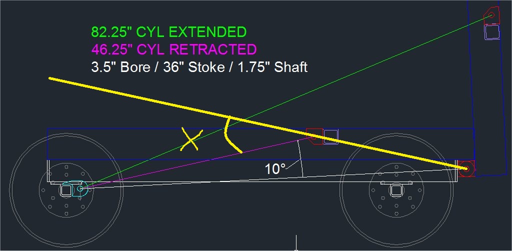

what about welding on a "u-joint" to the end of the cylinder rod. and the other end of the U joint to the bottom side of the frame for the dump bed.
then place another "U-joint" on bottom of the cylinder, and other end of u-joint on to the frame of the vehicle.
your not needing 360 degrees of rotation of freedom. but you are either tipping bed to the back. or to the sides.
360 joint would only be good, if you planned on tipping the bed directly back on one corner. but with only using a single cylinder. you would most likely have the entire bed and cylinder falling over on you.

go to harbor freight and get some 1 7/8 or 2 inch trailer balls and use a piece of pipe and cut out the female coupler not like its going to dump 10 tons of rock on a platform that size, most of the balls are all rated for 2k to 5k more than enough and not very expensive.
/ Dump trailer angle of the dangle #86
I like this idea. Some heavy pipe that has been chamfered would work well but you would need to put pins at each corner to secure it from coming off the balls. Then you pull any two pins and it dumps that direction. If you are dumping on an incline the deck might fall off though.

I included a picture of the running gear I recently bought from
the Marines. It is a $3200.00 unit, all mine for $225.00. They
use these for generators. Once the generator is offloaded
to probably a ship, the trailer is no longer wanted...
Anyone see anything NO GO about this?
Hey Artisan. You didn't mention, but are you just planning to strip the running gear off of that wagon and add them to a new frame or perhaps move the front wheels back toward the rear wheels and replace the wagon tongue with a fixed trailer tongue? If you are planning to build the dump box on the wagon frame as-is. then I would be concerned about the hinged tongue. When loaded it would travel fine, but once you have the deck up and dumping toward the rear a heavy load may lift the front axles off the ground without a fixed tongue there to support it. Even a side dump might be a concern without the triangular toungue to help stablize the trailer since that might pivot sideways and jacknife the trailer to your tow vehicle.
If you are moving the front axle back bolting it to the I beams next to the rear axle, you will want to be sure the new trailer tongue height is going to allow the trailer to stay level when attached to your primary tow vehicle, since there is no suspension and if the trailer is not level you will be putting most of your load weight on one axle instead of distributing it evenly on both.
Maybe your plan is to move both axles to the back and use leaf springs?

Gotcha. Well then since you currently have another project on the go anyway, you may want to take some time to ask around specifically about if anyone has made a dumping wagon. I haven't done it myself, but I see the potential for the hinged wagon tongue to present issues when you are dumping a large or heavy load. The I beams and axles look heavy, so there would be a good bit of weight at the front end to counter balance it, but at the least I would be looking into some calculations to see what weight is going to lift those front wheels off of the ground. It will depend on things like how far behind the rear axle you put the dump box pivot point (the closer to the rear axle the better), how heavy the front end of the trailer frame is, how heavy/high the dump box is, the angle of the dump (maybe have the cylinder top out at 45* instead of going for >50* when fully raised), how heavy your load is, etc.
It may still work fine, but you will want to know what the load limits are going to be and what design things you can do ahead of time to help keep the front wheels on the ground when dumping. Just my thoughts. Hope they help. :)
