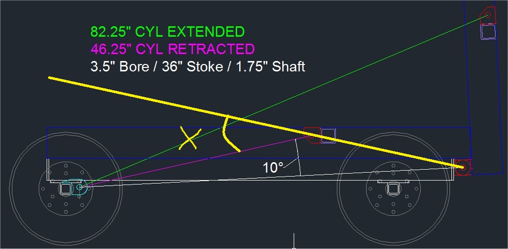

So I started drawing trying to take some of the suggestions into account.
Well, what I could remember.
This cylinder is under 200 bux and I can drive to get it.
The blue bed frame is upp'd to 6" tall to give me more angle of teh dangle and
I now clear the top of the tires.
The lower cyl mount at the axle is drawn as if attached to said but if I do this
I will beef that axle up w/ maybe a .5" thick piece of angle plus a
strongback on the front perhaps, "OR" ..we'll see.
I do not loose any ground clearance this way.
It pretty much is as simple as I can keep it.
"IF" the 10* is ok and "IF" the cyl is strong enough
The trailer is drawn to scale exactly.
All parts drawn exactly to size.
No finals here, still hammering it out.

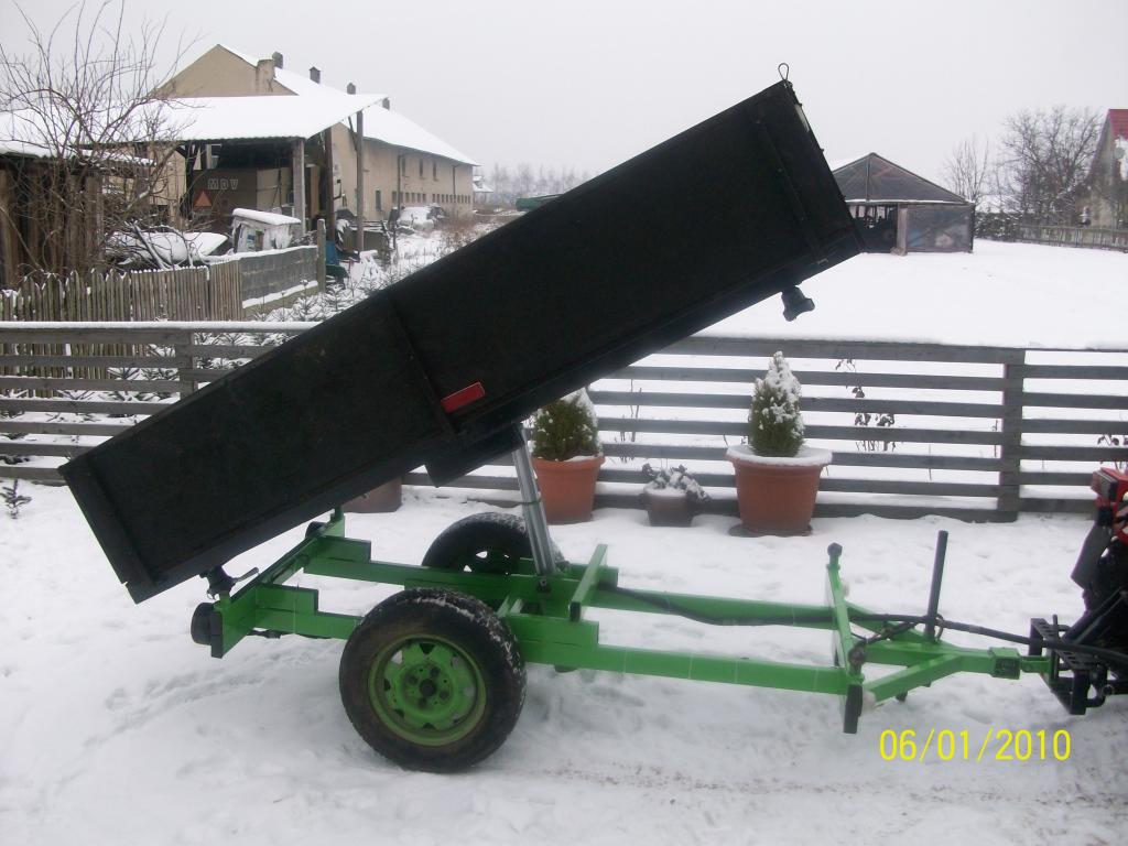

Mike I hope your ok w/ this... For him-haw sake here is how Mike did his
w/ the ball x ball telescoping $6.00 cylinder! SIX BUX!

Looks better but still not quite what I need to say if it will work.
You need to draw a line from bed-frame pivot THRU the cylinder-bed pivot and measure THAT angle to the cylinder. THAT is the effective push angle. See diagram trailer.jpg
Also, what is the length of the trailer? And how far forward is the pivot? (IE: where are you pushing on the bed at). It looks like you are a little behind the midpoint. But I need to know exactally (or close) where it is so we can calculate how much it will dump assuming a load of x pounds @ midpoint.

Okay...here goes some numbers:
3.5" cylinder @ 2400psi is going to give 23,000lbs of force.
Now to figure out how much of that is in the UP direction.
With a 25* effective cylinder angle, you have 9750lbs of force in the vertical direction.
Now to figure what that equates to at the center of the bed...
With a 82" bed, the center is 41". And you are pushing with a force of 9750lbs 30" forward of the rear pivot. So that would equate to a 7100lb lift force at the CL of the bed. BUT...keep in mind that the weight of the bed is raised too. So that gets deducted from the 7100lb capacity to get a true dump force.
But even so...I think that should certainly dump anything you could get on that size of a trailer.
I trust your drawings and angle-of-dump measurment so I wont go into that.

Also, I forgot to mention that you need to take into serious consideration that you are going to be pushing on the front axle and on the trailer-side mount with 11.5 tons of force. You need to make them VERY stout given that you are pushing smack dab in the middle of them.
Heres something to ponder about (and draw up in cad...)
Move the front axle back a bit, and drop to a 30" cylinder. Use two of them mounted to the frame-rail on the trailer side and out closer to the wheel on the axle side. You could then drop down to 2" cylinders. Dump angle would be a little less, but it looks like with the 36" cyl you have about 85*, so dropping to a 30" should still give you in the 70* range.
Doing this you wouldnt have to build the mounts like a tank. Each cylinder would push with ~7500lbs force for a combined 15k force. On a 25* angle, that would be about 6500lbs in the vertical direction:thumbsup: so still pleanty to dump. And a 2"x30" cylinder is $110.

So MIKE from Poland has really got me reeling here.
A 3 way tipping trailer is off the chain cool, I mean it
really can be usefull.* These "underbody" telescoping,
trunnion mounted in a gyro swivel w/ a swiveling top
shorty cylinders are the bomb. How much money does
this stuff cost is the next thing I look at just so I cover
all bases before building anything.
I did not know where to get the 3-way-tiling corner
"Balls" but BCP, a man of many productive searches
FOUND THEM at Leisinger Deutschland GmbH: Unternehmen . I registered there
and wrote the firm asking for info on there smallest
units, the KL45's.
*My plan is to make a trailer lower section that dumps,
and then perhaps have a few different attachments
I can mount on it.
Maybe a dirt dump, a log hauler, a platform for an
AutoCrane, etc.
If all 4 corners are "Balls" and if all 4 corners could be
unlatched it would make for EASY top section swaps.
