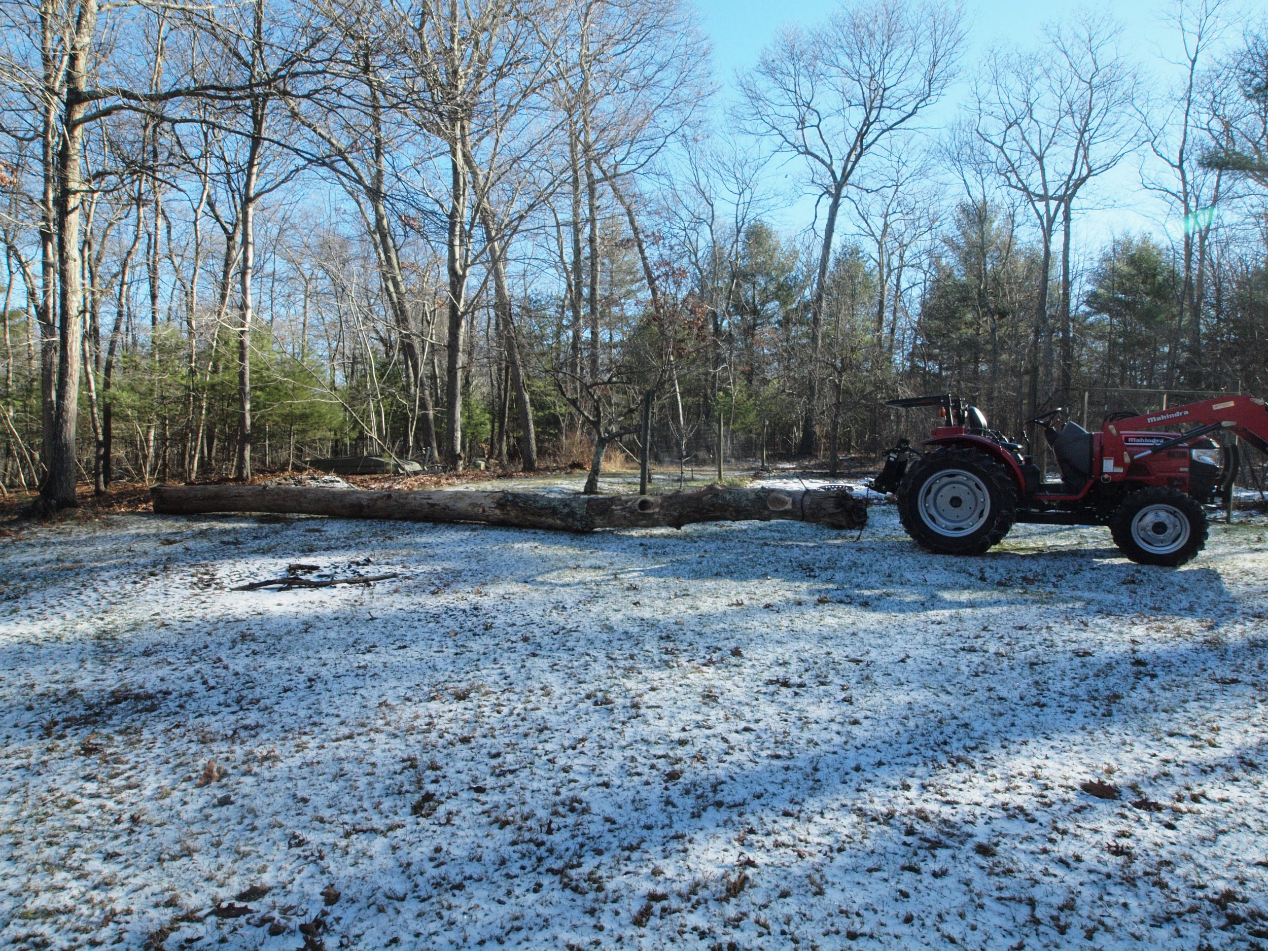

Why? I am always amazed when I find I have done things wrong my whole life without ever having a problem.
Like people saying you should never use the 3 point draw bar to pull stuff?
That's all I pull with because it raises the tree off the ground preventing snags.

Exactly what they're made for.
I guess one would have to see them in action to be secure with their workings.
The ones shown seemed to be a little deficient in the sturdy column!
   / Drawbar pulling question #43
especially with the size of the tractor they are on, maybe if it was a bx.
   / Drawbar pulling question #44
I would agree w this.
They would have to be built accordingly.
a fel goes a log way to mitigate front end lift when pulling.
