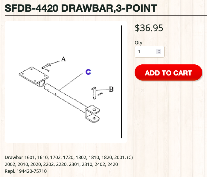

If you have the tractor's original fixed (not three point) drawbar installed, pull from the rear of it, like the factory's engineers designed it. They knew what they were doing. No more drawings needed.
If not, get one or copy it.
Bruce
I have the original, similar to the drawing. After looking at posts here, especially the drawings from the engineering textbook, I am more inclined to turn the bar sround. I'm still gonna make the drawings to scale to figure out the forces on the bolts.

do not turn the bar around. Y1 is still not zero technically you could still flip the tractor if you could get enough traction even with the drawbar backwards. as the wheels lift your attachment point will raise instead of lower than the theoretical Y1 will become the rear axle where the chain is bending . A fixed drawbar extending behind the rear wheels is the safest bet.
