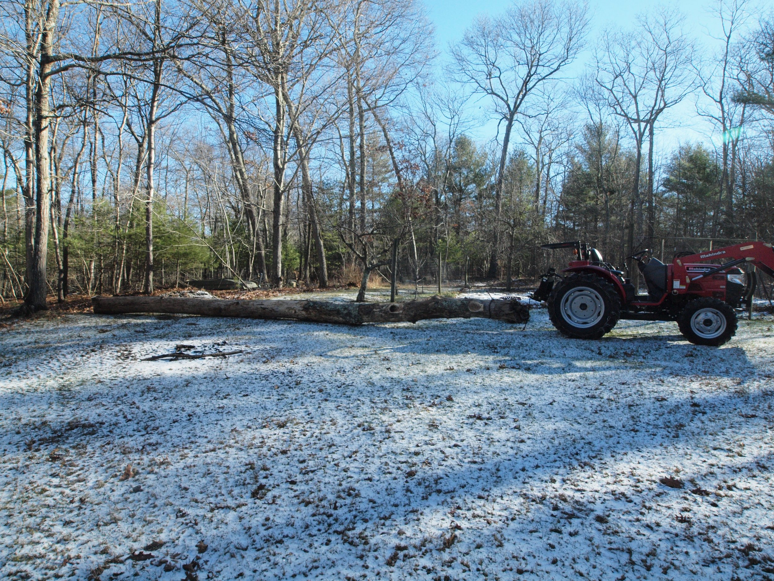

ETPM, use the factory drawbar for safty. The geometry of the drawbar(NOT 3ph mounted) is set so that even the front comes off the ground you DON'T fip over backwards. As the front goes up the drawbar rotates down and becomes a lever stopping the tractor from flipping all the way over.
This was graphically shown in a practical demonstration at Massey University Ag Dept tractor saftey course. It is scarey if you are on the tractor and spectacular if you are watching. To lower the front without damage reduce the power slowly to avoid slamming the front axle into the ground.
LASTLY the Tutors were very blunt about attatching the chain to the top link pin and pulling from there. DON'T, you can flip the tractor before you can react.
Log Towing: cut a 30 degree(approx) shamfer all the way round on the butt end of a log to reduce dig in. Old loggers trick
Dig In: set up the 3ph so you can lift in the event of a dig in and then lower 3ph so there is no lift for most log towing. I did this on my MF135 to haul out thinning logs and it was effective.
