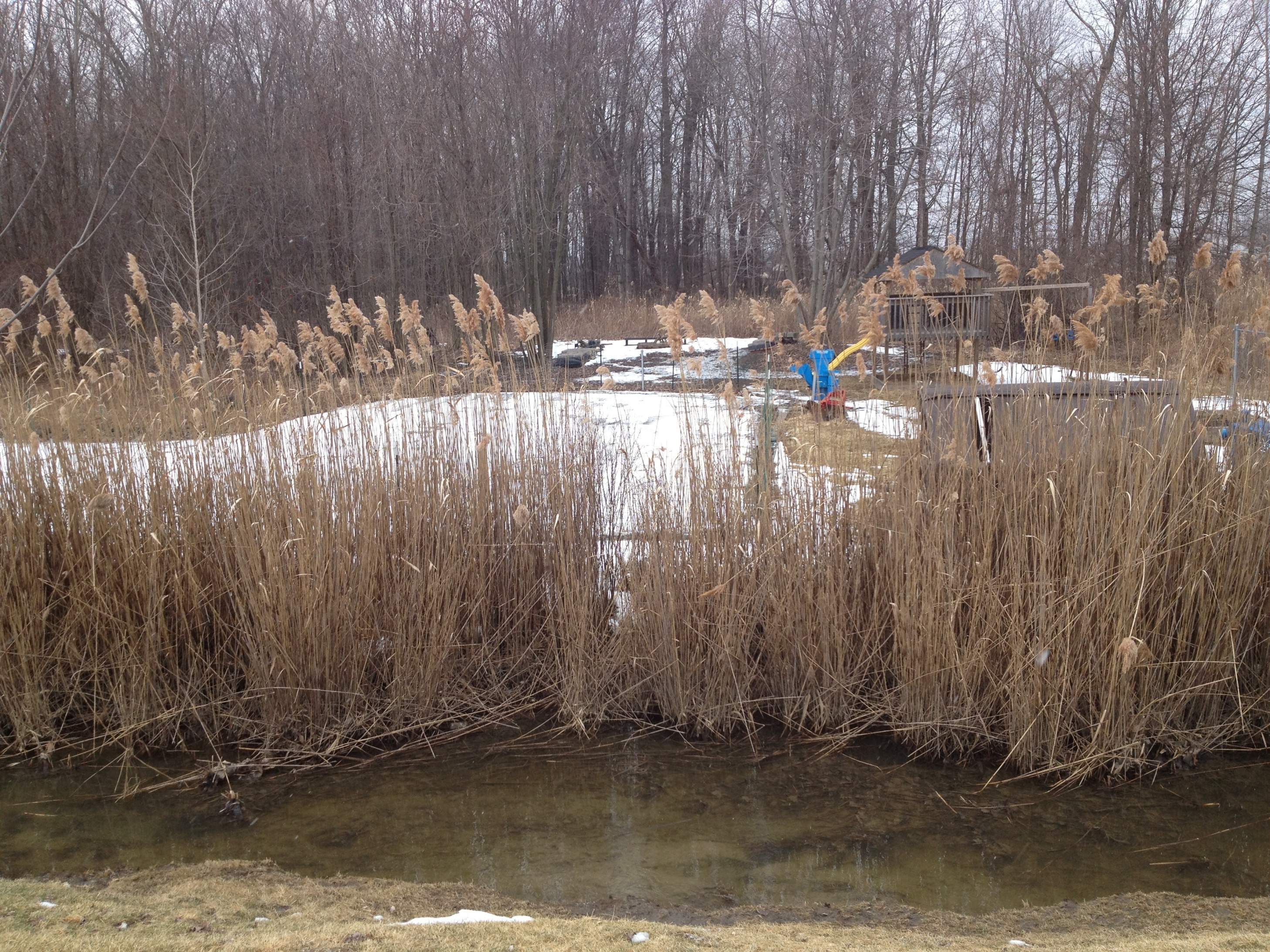

image.jpgFossil Farm, you might be on to something. Is it the water pressure from the creek holding the surface water up until the creek goes down? The garden never floods from the creek but it doesn't drain off after a heavy rain for a couple days either. I think I'm going to split the garden in two. The front high half I'll sub-soil and the creek half I'll mound and sub-soil. If the furrows drain well this season I'll go back to just planting on the ground. Here's another picture from today of what I'm dealing with.

You could dig a hole with your backhoe, say at one end of the garden about in the middle of its width, and find out where your water table is. If the hole pretty much fills with water and stays at that level, all the subsoiling in the world isn't going to solve the problem of saturated, water-logged soil. Neither will drain pipes that are laying in saturated soil with no place to drain to.
If you have to garden in that spot, which I would say is unfortunate to begin with, then raising the garden is the thing to do. Either using hills, mounds, fill or whatever. One problem I see is that your garden is going to wash into the creek little by little and that will be accelerated by improving the slope for surface drainage. Your top soil fines and nutrients are going to go in/down the creek.
If the MI DEP/DNR will let you get away with it, or issue a permit for it, I would dig a pond that the ditch flows through and use the spoils to build a raised platform to garden on. You could save the topsoil to the side and put that on top of the platform when it's done. It's probably a good way to get in trouble, on the other hand, you are too close to the ditch to begin with for disturbing soils and if someone wanted to be picky, you will be in trouble for that too.

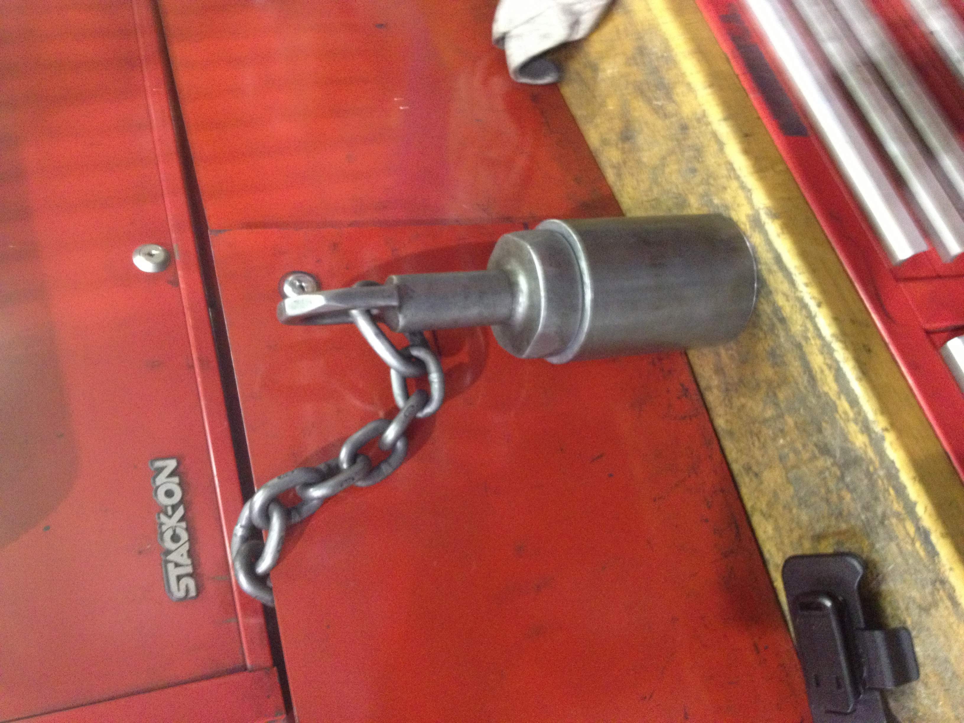

Yeah, I know its a bad place for a garden but I have no other place to put it. A buddy told me to subsoil and plant pumpkins for the kids and watch it for a season. The front 50' is always fine, its only the 30' closest to the ditch. The drain commission told me I could do whatever I wanted with the water in the creek but I couldn't change any of the elevation. How long of a chain do I need on the mole? I was walking down the isle here at work and somebody broke a parallel lift and threw it in the scrap hopper. I think its a great start for a mole. It has a 3/8" chain on a 3-1/2" dia. shaft. I cut a piece of 4"dia.x6", tapped a 3/4-10 hole in the back. I'll have it welded up tomorrow. I'd like to put more of a bullet on it but I'm not going to worry to much about it.

Oh well, that's a shame really. I could see a nice duck pond and winter ice skating there. :) As it is, you will adding to the nutrient load (phosphorus and nitrogen) in the water and adding silt build-up to the ditch. I know the regulations are well-intended, but they sometimes rule out the best land-use solutions it seems. Here, you would probably have to maintain an undisturbed vegetative buffer within 50' of the creek.
