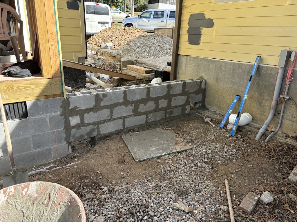

Laid my first block wall. Went well, mixed the perfect amount of mud and got it done before the mud went bad. I was going to do Quikwall but they had me running across town to find it. So I said screw it, let's do it the old fashioned way! Now I can say I have laid block. Yeah, I know, some of my joints are too close. I laid them out dry, thinking I was going to do quikwall, but when I added in the mortar it changed things up and moved my joints closer together. It will all be stuccoed so it will disappear.
I ended up going with 6" rigid. It wasn't that expensive at all. I forgot to get a picture before I started slinging gravel. But it is going to work well I think. I bought a 12"x12:x17" plastic catch basin from HD. I was planning on making one out of concrete but this one has a nice cover and plastic strainer that goes inside. I poured a concrete block for it to sit on so I could get it the exact elevation I wanted to take the water from the driveway. I screwed it to the concrete with neoprene washers and siliconed. I didn't to want it shifiting around until I get it backfilled.

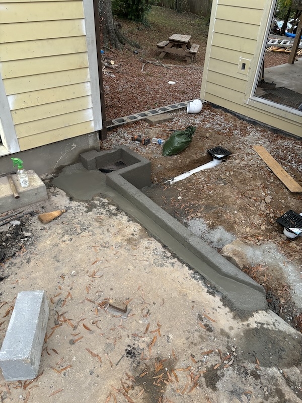

Well I am getting closer to closing this hole up and putting this behind me. I formed and poured the curb that will catch all the water coming from that side of the property and send it into the catch basin and into the backyard via the 6" pipe. Still a few things to do but this is a BIG step, as LOTS of water moves through that corner. I gotta say it was a PITA to form this and pour this but I am pleased with it. It is untested but I have been watching the behavior of the water in this location for 9 years and I am quite confident it is going to perform the task exactly as I planned it.
I was planning on using pavers in that flat spot between the curb and the door. I have decided to switch gears and pour a slab there. I just want this to be a one and done project. I think with the drainage and a slab water will never be an issue there. So far I feel good about it.
Because there is such a height discrepancy between the slab height and the door I have recently decided to make a wooden deck that is essentially even with the door. That way you take 1 step over the concrete curb and you walk into the house. I will probably make it in 2 pieces so every 5 years I can move it and clean out underneath it. Does anyone see any other solutions to this area. I need to solve 2 issues, the water that will fall in that 8.5'x9' area and not having to step up and over a bunch of curbs as you walk in and out of the house. I am only 50 but we plan on being here for a while yet. I am trying to incorporate as much infrastructure that will allow us to age in place.
What would you do here? Any other ideas are welcome! Hoping to get this wrapped up this weekend. The weather has cooperated wonderfully this fall but the winter rains are coming!

AND I'm done!!! PHEW! Glad to put that behind me! 32 bag pour mixed with an electric mixer. Supposed to rain Tuesday, excited to see it in action. Eventually when everything else on this project slows down I will make a deck that will allow us to walk straight into the house without a step.
