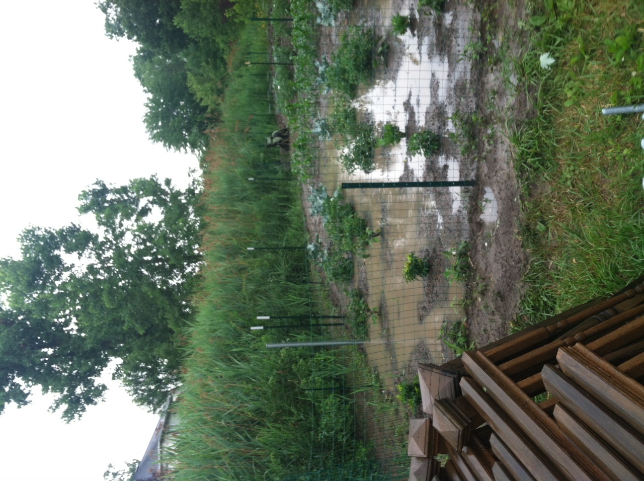

I need a little help on the best way to drain my (40'x80') garden of excess rain water. I've had the garden 5 years, the first 2 were great, so many vegetables I couldn't give them away fast enough. One was ok but the last 2 were a total loss. I have a rain water drainage creek at one end of my garden. My brother told me to put some 4" socked perforated under the garden but I'm concerned about running it over with the tiller in the spring when the ground is wet. Is it better to mound the rows or put some sort of drainage? I can pretty much do whatever needs to be done. I've got a Ford 3000 & 4400 with a BH, 60" tiller, 60" box scraper, middle buster, back blade, PHD, 2 bottom plow and a small set of disc's. If I need another tool to get the job done I'll buy it, I just want it fixed once and for all. One last question, I have access to all the free horse manure I want, is it to late to add it to the garden for this season? We're about 2.5 months before I'll plant. Thanks in advance. Here is a picture of what I'm working with, the creek is at the left of the picture hidden by the Phragmites that have taken over everywhere around here these last 10yrs.

The big question I have is how much lower than the garden is the creek, or is there somewhere else you can drain to.

Believe it or not the creek is lower by about a foot at its highest, that's standing rain water that won't run off. There's clay under the little bit of top soil I have. I got in there with a shovel for a couple hours and was able to get most of that standing water off but it was to late. It was looking great in the begining but everything drowned except the corn. I thought of hilling/mounding but I like to go between the rows with my 12" walk behind tiller once a week to take care of the weeds. If I could make mounds 5' wide 10"-12" high I'd do that but I don't know where to start. Could I put the tiller on a steep angle and plant on the sides or put a trench to the creek between the rows? I'm kinda reaching now, I'm not sure what would be best but I have to try something. There's nothing worse than putting in all that work just to have a heavy rain take it away.

Well, ideally the drainage pipe you put in should have its outlet above the water level in the ditch. When the ditch is full, that is when you need the drain to work the most. So, that doesn't give you enough depth to keep the drain pipes from being frosted and heaved. If I am seeing it correctly, drainage pipes aren't going to be a very good solution.
Maybe you could build up the height of the garden on the side opposite the ditch to create a gently sloping surface for runoff. 1/4 to 1/2 inch per foot should be enough. If your garden is 40 foot wide, 1/4" per foot would need: .25" x 40 = 10 inches. So, if you can raise one side by 10-20 inches, it should drain the surface water to the ditch. If you use sand, which is plentiful in MI, mixed with your existing top soil to raise the garden, and add organic material to that with the horse manure compost, it should help a lot.

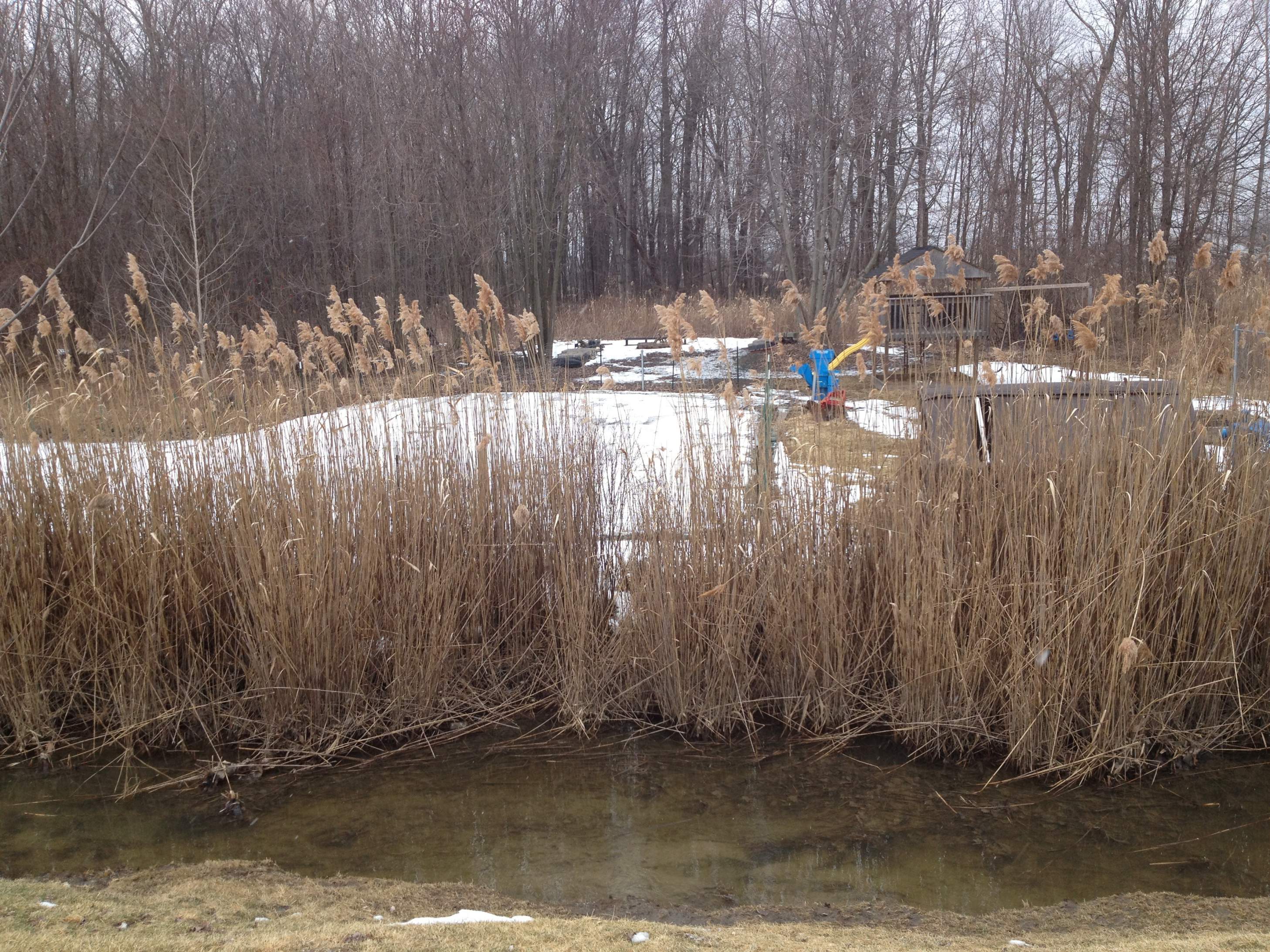

From you're description, the garden is in the "flood plain" of the small ditch next to it. Same as a river system, just on a smaller scale. You will not be able to drain the groundwater out any lower than the water level in the ditch. If that is where you want the garden, raising the beds above the existing ground level looks like your best solution. Just depends on the drainage area the ditch drains if it will continue to be a problem in future wet years.

image.jpgFossil Farm, you might be on to something. Is it the water pressure from the creek holding the surface water up until the creek goes down? The garden never floods from the creek but it doesn't drain off after a heavy rain for a couple days either. I think I'm going to split the garden in two. The front high half I'll sub-soil and the creek half I'll mound and sub-soil. If the furrows drain well this season I'll go back to just planting on the ground. Here's another picture from today of what I'm dealing with.

You could dig a hole with your backhoe, say at one end of the garden about in the middle of its width, and find out where your water table is. If the hole pretty much fills with water and stays at that level, all the subsoiling in the world isn't going to solve the problem of saturated, water-logged soil. Neither will drain pipes that are laying in saturated soil with no place to drain to.
If you have to garden in that spot, which I would say is unfortunate to begin with, then raising the garden is the thing to do. Either using hills, mounds, fill or whatever. One problem I see is that your garden is going to wash into the creek little by little and that will be accelerated by improving the slope for surface drainage. Your top soil fines and nutrients are going to go in/down the creek.
If the MI DEP/DNR will let you get away with it, or issue a permit for it, I would dig a pond that the ditch flows through and use the spoils to build a raised platform to garden on. You could save the topsoil to the side and put that on top of the platform when it's done. It's probably a good way to get in trouble, on the other hand, you are too close to the ditch to begin with for disturbing soils and if someone wanted to be picky, you will be in trouble for that too.

Yeah, I know its a bad place for a garden but I have no other place to put it. A buddy told me to subsoil and plant pumpkins for the kids and watch it for a season. The front 50' is always fine, its only the 30' closest to the ditch. The drain commission told me I could do whatever I wanted with the water in the creek but I couldn't change any of the elevation. How long of a chain do I need on the mole? I was walking down the isle here at work and somebody broke a parallel lift and threw it in the scrap hopper. I think its a great start for a mole. It has a 3/8" chain on a 3-1/2" dia. shaft. I cut a piece of 4"dia.x6", tapped a 3/4-10 hole in the back. I'll have it welded up tomorrow. I'd like to put more of a bullet on it but I'm not going to worry to much about it.

Oh well, that's a shame really. I could see a nice duck pond and winter ice skating there. :) As it is, you will adding to the nutrient load (phosphorus and nitrogen) in the water and adding silt build-up to the ditch. I know the regulations are well-intended, but they sometimes rule out the best land-use solutions it seems. Here, you would probably have to maintain an undisturbed vegetative buffer within 50' of the creek.
