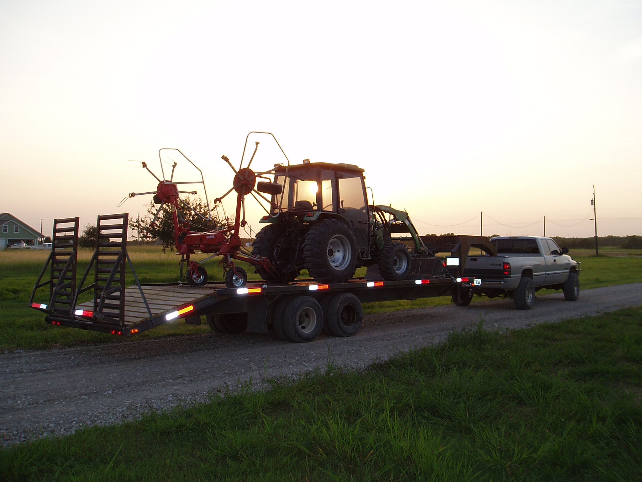

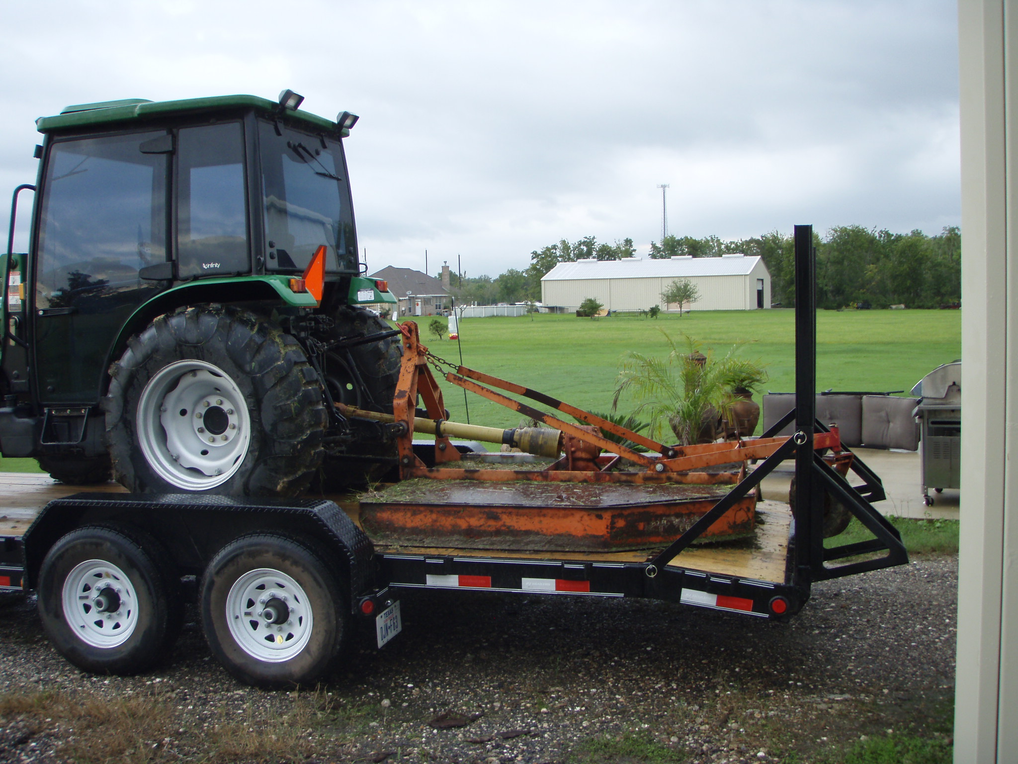

My 24' PJ car hauler has a 2' dove tail on it. I like it, sure helps with loading and unloading things. I have never drug the back end of my trailer yet. Where I live everything is flat.

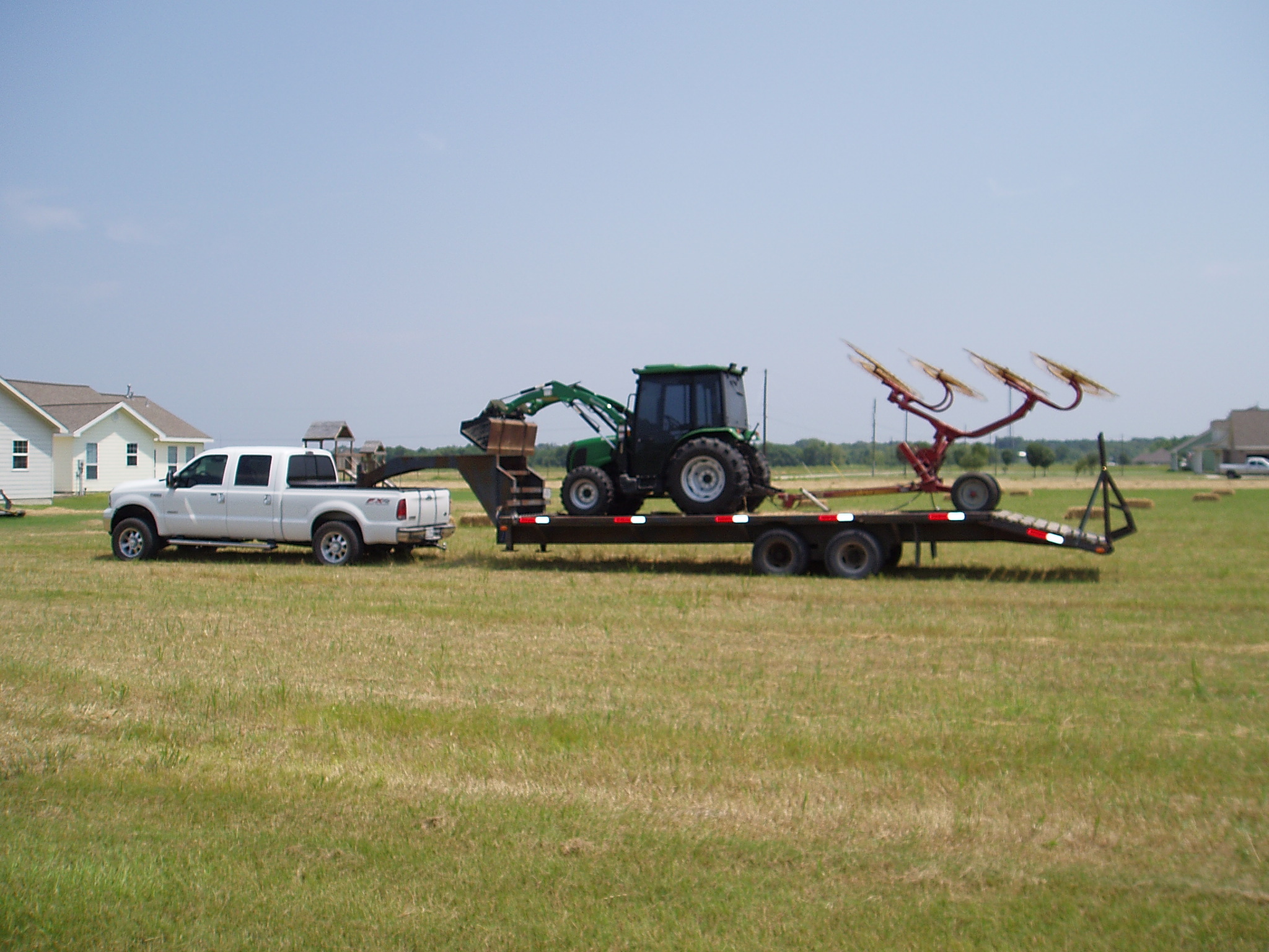

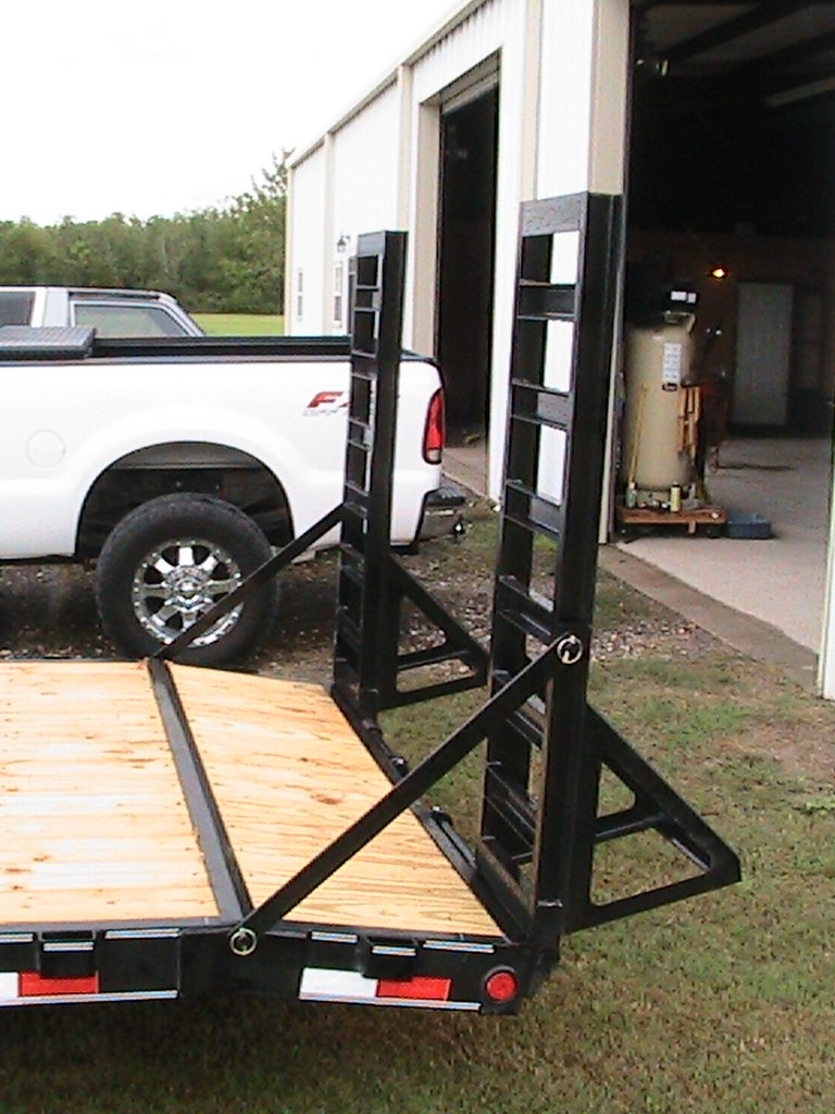

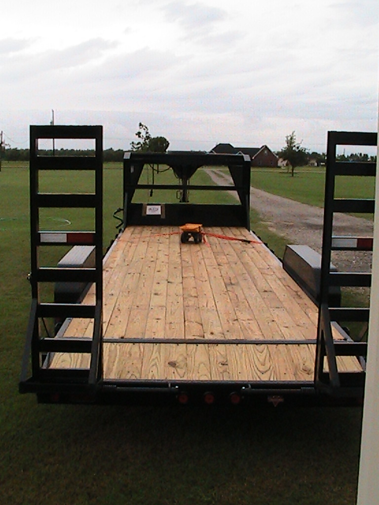

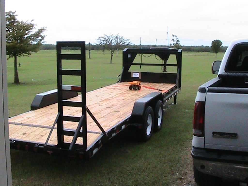

My older trailer was a deck over type with no dove tail. After time and things hanging up we cut the back of the trailer and made a dove tail on it. After we did that, I was able to drive my tractor and hay equipment on with no problems. We made our ramps 4' fold up type. This trailer was much more useful after we built the dove tail on the back.

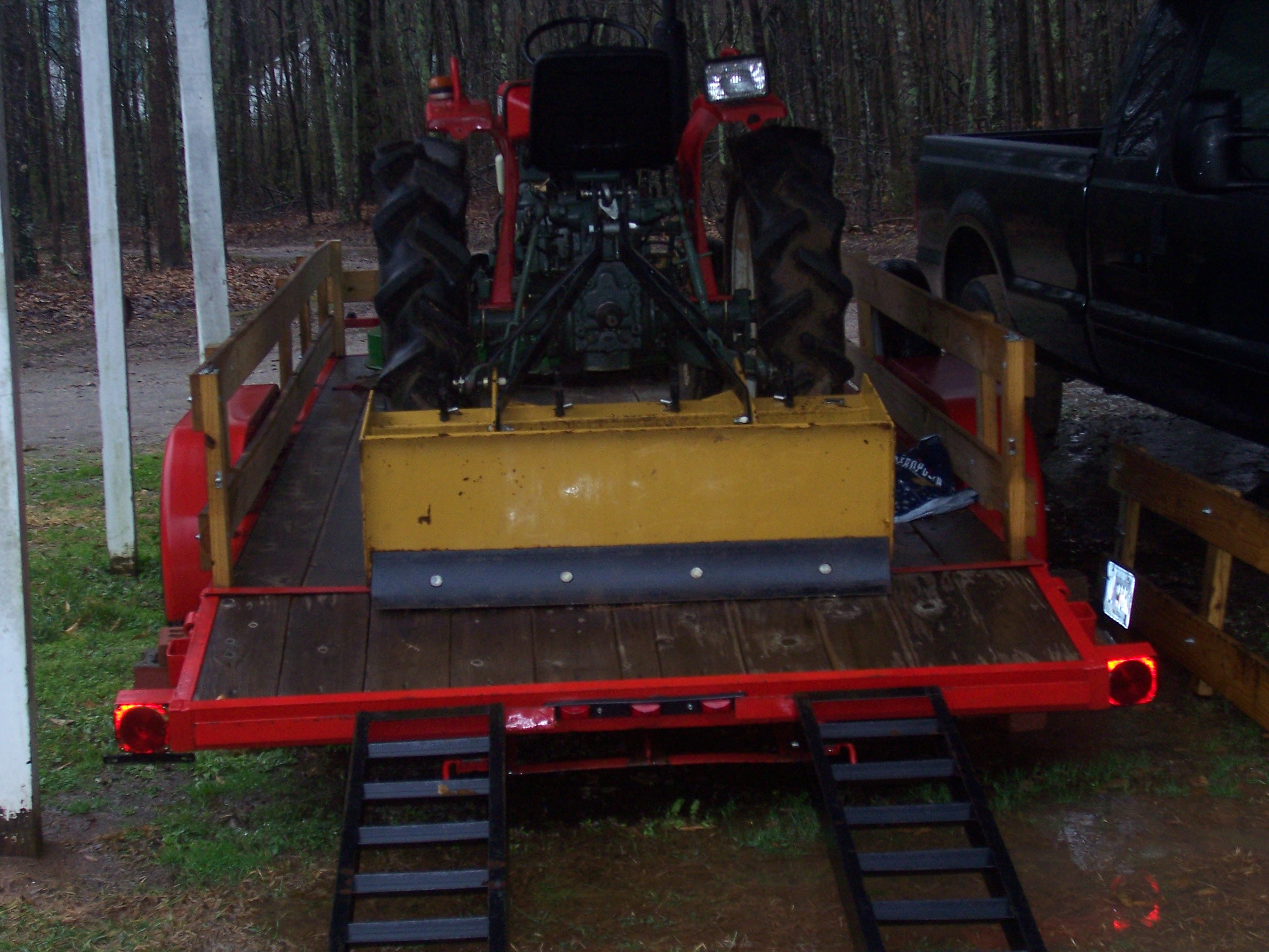

/ dovetail a 22'er or not? #10
Here a pic of how low mine sits and if you look you can see were my ramps go. Great for loading low profile cars. I'm in NE Ga. so it's pretty much flat so Haven't had any problem with it.Had it 4yrs. and used it weekly so I don't think the racks would hold up to much of draging.
