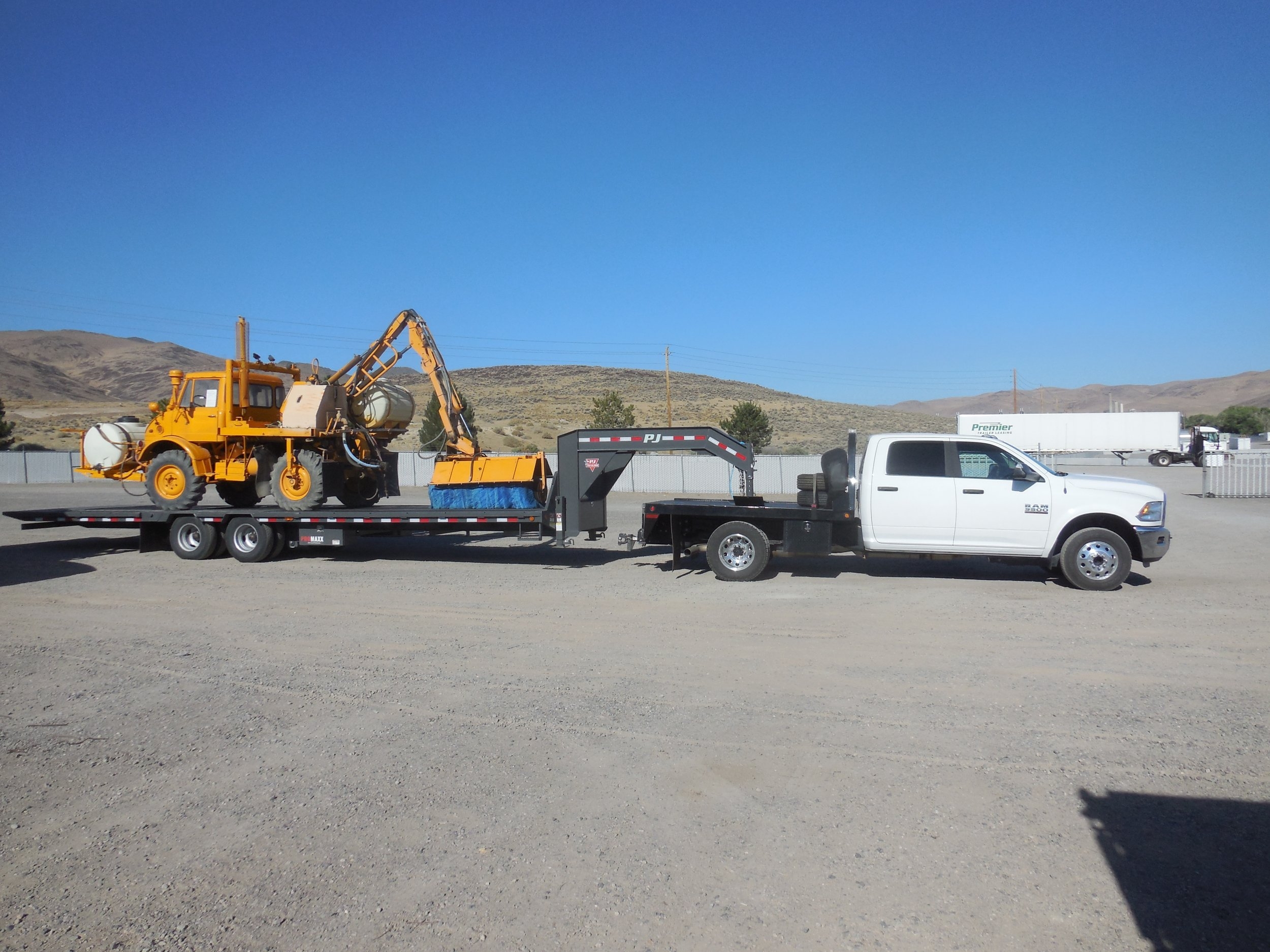

In my case, I'm perfectly legal with the 14,000 lb. GVWR, and my longish (32') flatbed trailer is rated at 25K. Yep, 39K CGVWR and just fine on a regular license.
Now, had I still been in CA that would've been an entirely different story. Have snuck in there twice and got away with it (flatbed alone means stopping at the scales, which I didn't) but not pushing my luck again.
With this load I was maxed out, and probably then some, but never had to enter CA.

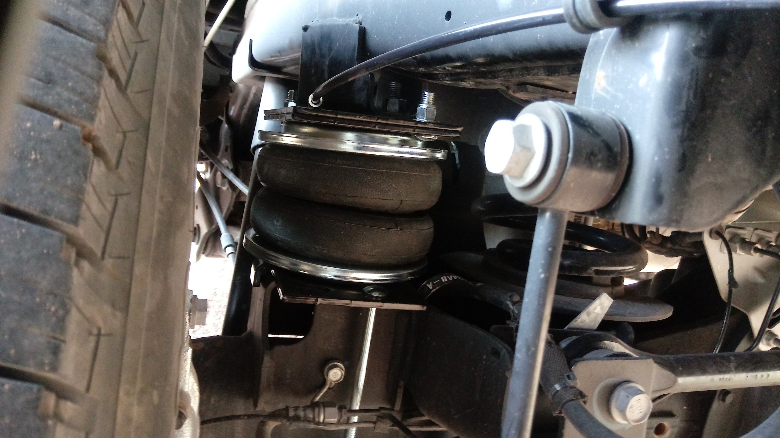

A Ram 2500 is basically identical to a 3500, except for the rear suspension and the mandated 10K max GVWR, so I wouldn't worry too much about the weight.
There are always air springs in case the rear sag is a problem.

What bags did you get? I'm thinking about a set for my 2014.

Those look like they may limit axle articulation, do they?
In theory they might but not for my use. Say If I were rock climbing. I almost always have a gooseneck dump attached so I need the capacity and stability.

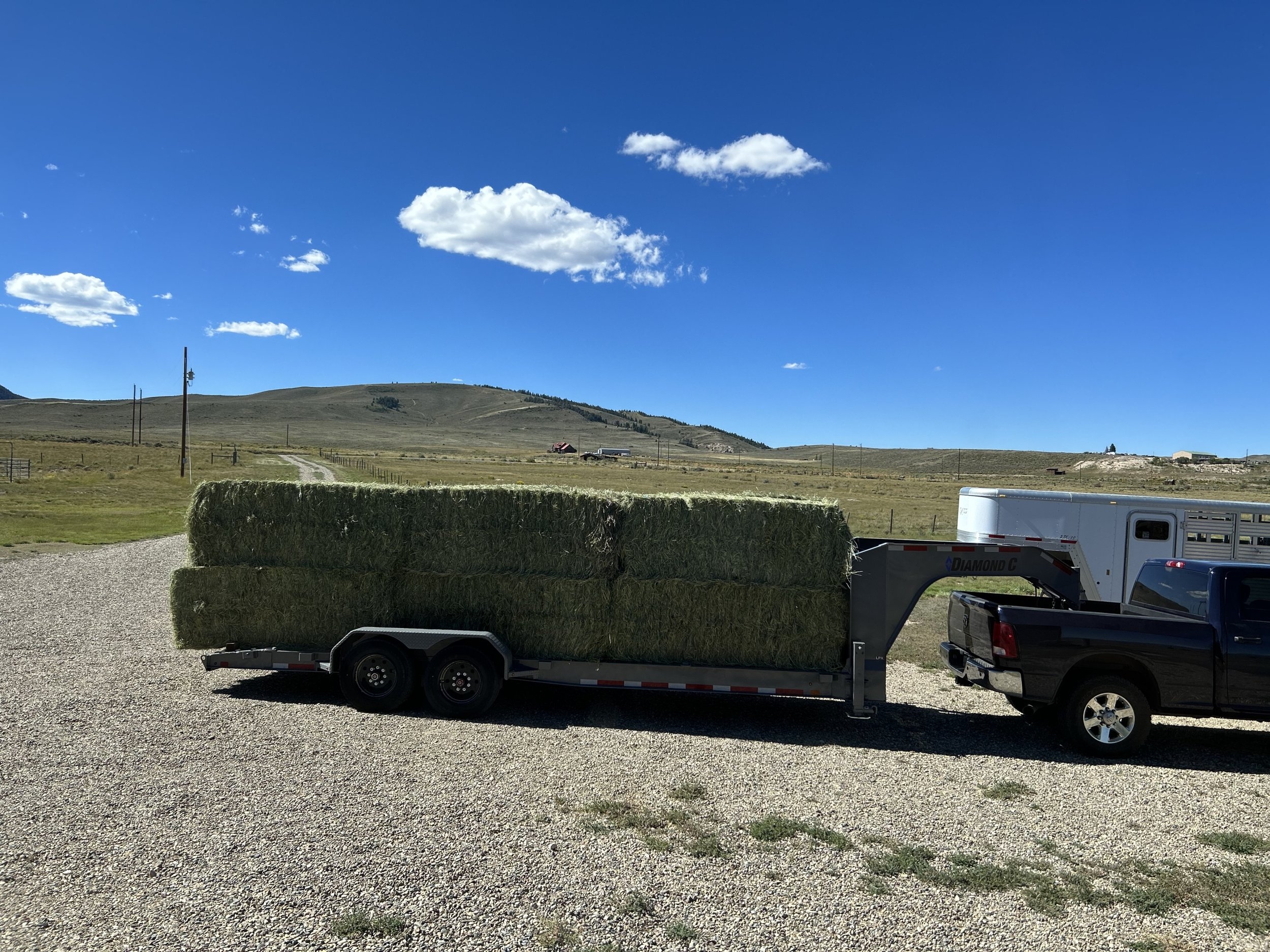

I like my diamond c GN it is 20’ with 2’ dove. Low deck and my equipment goes on it no problem. I just don’t trust bumper pulls with 14k loads pushing 18k all in. last week hay pickup…View attachment 822183

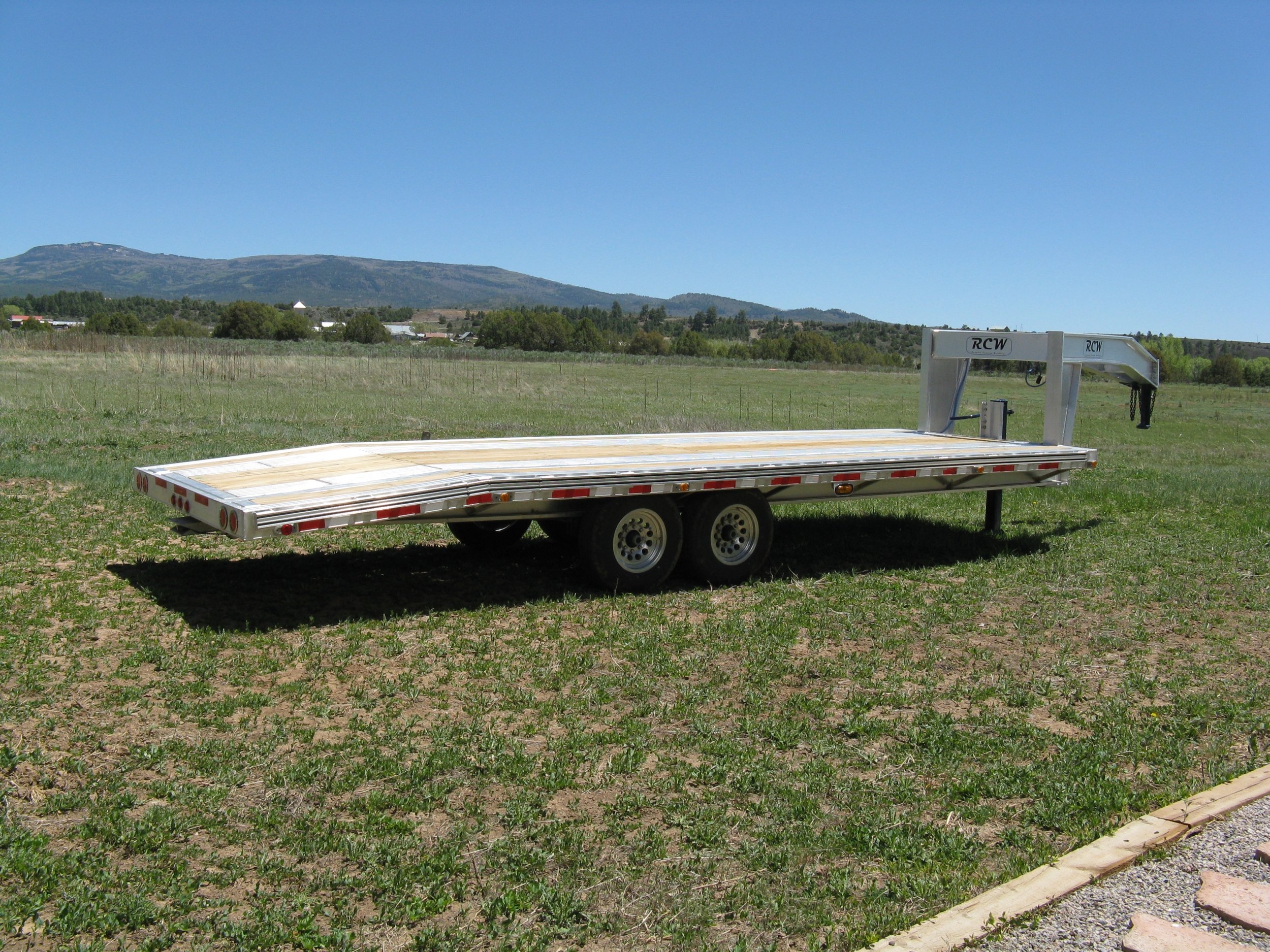

I'm trying to decide on the length I need. I think 22' (20' flat & 2' dovetail) is about right to allow for positioning to balance the load and maybe carry a second implement.
However, if I switched to a gooseneck would a 20' trailer be long enough as the loader bucket could set on top of the gooseneck hitch? I found a 20' gooseneck (18' flat & 2' dovetail) for sale somewhat local to me.
I would think you would be fine with this trailer. The shorter it is the less weight will go on the pin. Pretty sure your tractor will not overload the truck loaded all the way forward. The rear attachment will help offset the pin weight.
My Loadtrail is similar to the D/C pictured. 22' + 2' dove, 14k. If needed, the fenders are removable to load a wide load, then reinstall them. I tow all my trailers with a 2500 '01 Dodge or '21 Ram 2500.

@nisaacs s 100% correct. I can pull the fenders if I need extra 4-6” width, then re-install them. But my 75C fits between the fenders no problem and the bucket can set on the GN. Then I can load it with my bush hog still attached.
