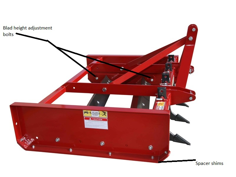

I believe the adjustments actually serves 2 purposes.
1. Allow for wear as some have said.
2. Allow just the blade section to be replaced if damaged by rock etc. Otherwise a bend here would junk the entire attachment.
I'm sure there are other advantages related to assembly labor, like being able to mount the blades before the blade frame is attached to the main frame.
I would add having scarifiers is a really nice feature. Feeding the blades loosened material will make them more effective at getting to level faster.

I've had both, you want adjustable cutting edges. I currently have an EA and it's lack of adjustability is a point of frustration for me. They work much better when you can adjust the cutting depth. Also the cross tube part of the frame isn't high enough above the leading cutting edge so it plugs up easily.
Everyone is going to tell you to just buy a hydraulic top link, that does not solve the problem.

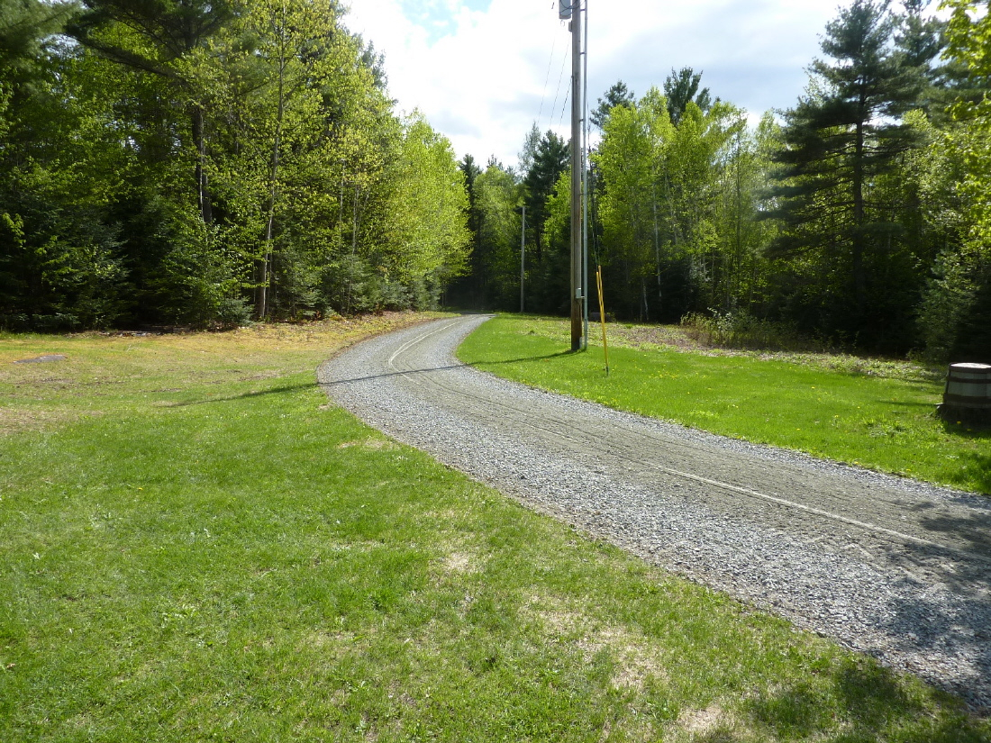

This time of year my mile long gravel driveway turns to concrete. Over the 40+ years it's been here - the wind has brought dust, volcanic ash, etc onto the surface. All combine to make a VERY HARD surface. It's soooo hard - you can smoke the tires on your car and only leave rubber marks.
If I use my LPGS without the scarifiers - even at 800# the LPGS will have a tough time "breaking" the surface and doing its job of smoothing. One pass with the scarifiers down just an inch or so is all it takes. Most of the time the LPGS is used to fix shallow pot holes.
First pass with scarifiers down an inch or so. Second pass the scarifiers are down enough to stir up the very bottom of any pot hole. Then a few passes with the tractor to pack everything down.

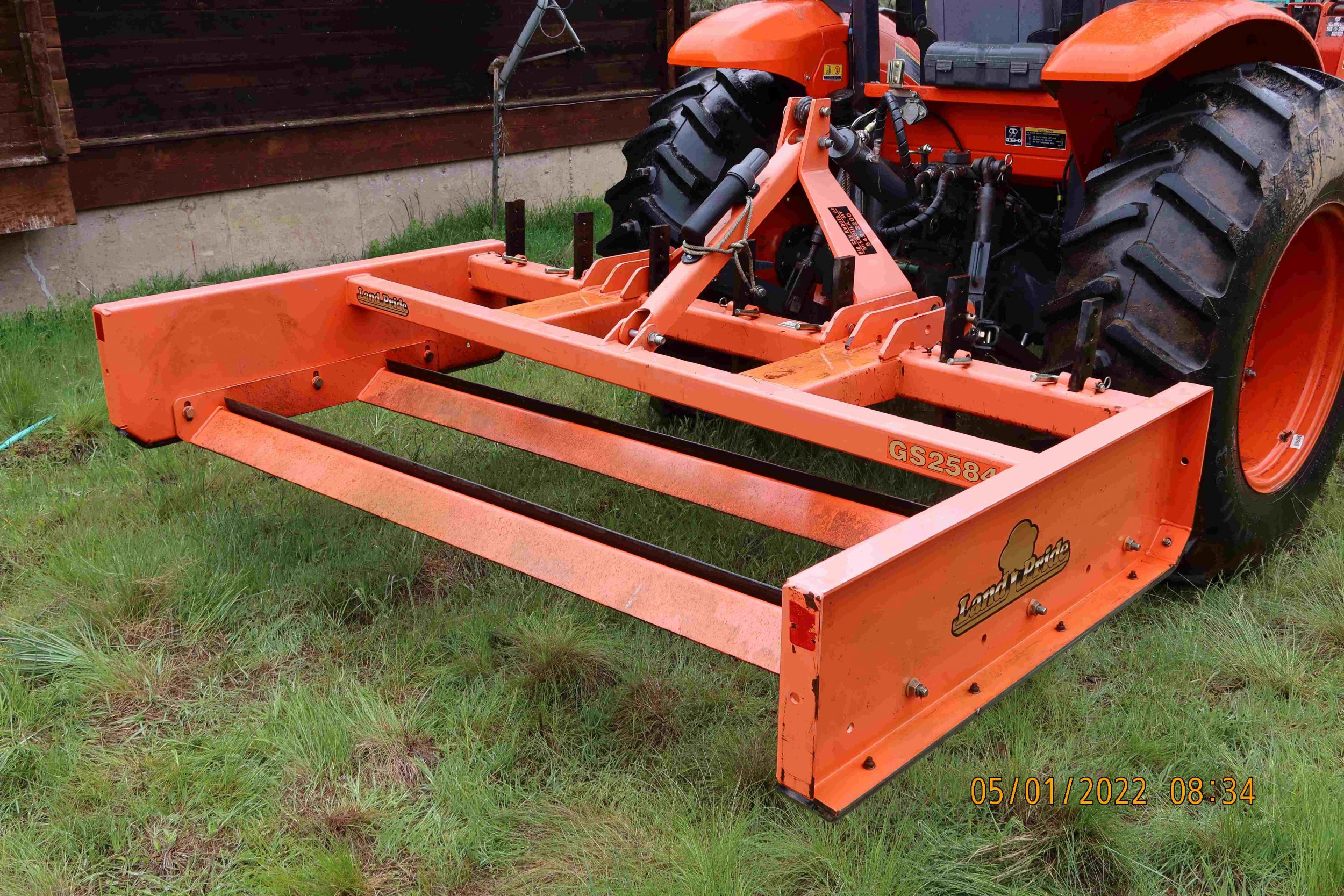

I have a Landpride GS2584 with scarifiers and adjustable blades. I have never once adjusted it and I have never once found the need for scarifiers.
I ended up buying a heavier duty grader made by Road Boss because I managed to bend my Landpride.
The Road Boss doesn’t have scarifiers, and has never needed them. It also has adjustable blades and although I haven’t adjusted them, I like having the option, because it is set rather aggressive from the factory considering my small tractor and HD land plane.
I do believe I will use the adjustability of the blades at some point, and I would recommend getting something adjustable. However, if you find a good deal on a used one that isn’t adjustable, don’t pass it up just for that reason, it’s obviously not a critical feature.
The difference between the Road Boss and Landpride is VERY noticeable! The Road Boss works considerably better in hard pack and I like the longer sides. It also has a lifetime warranty, and is built much better.
Landpride 846lbs vs Road Boss 1,100lbs
The Landpride is no slouch, but I was disappointed in how easily it was damaged. I know that a lighter duty 1584 would be very disappointing for my uses.

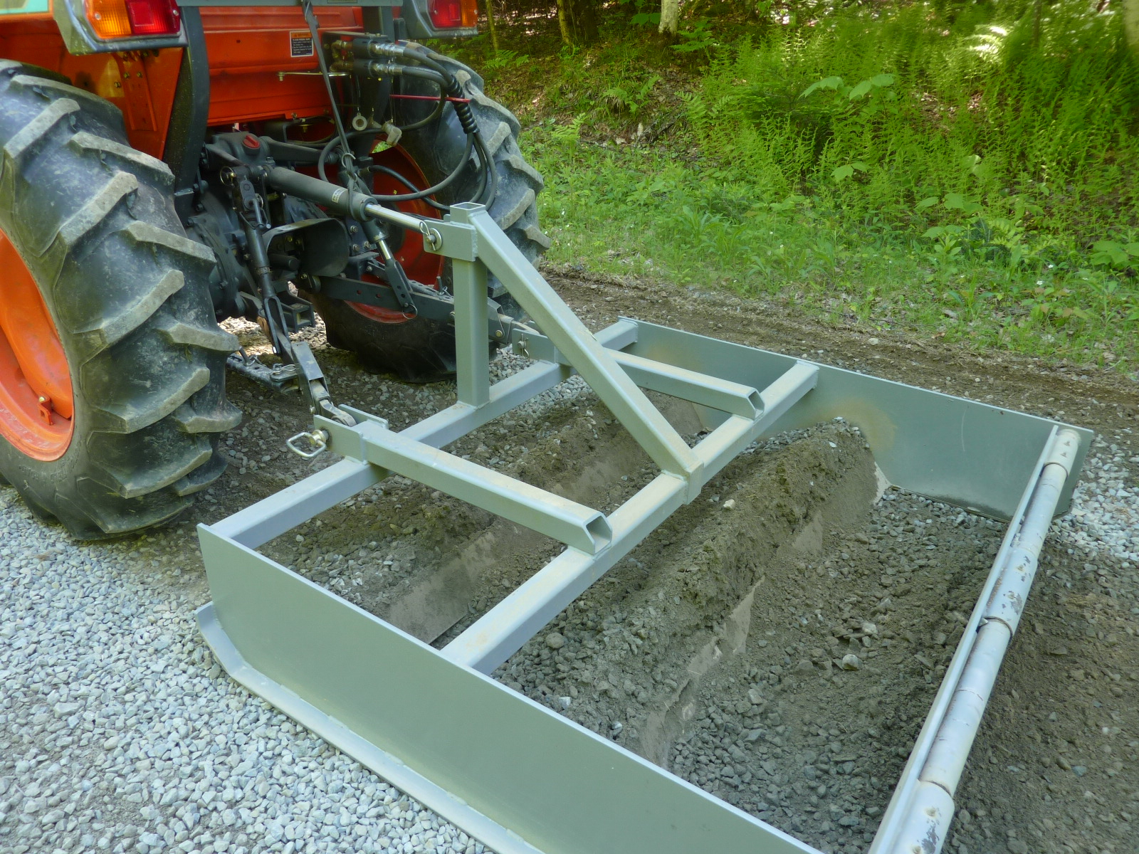

I have a land pride 84 inch model. It has 2 fixed blades. Honestly I'm not impressed with this attachment for road maintenance. It tends to dig deep and both blades angle towards the same side, resulting in a lot of material being thrown to one side. I would have liked to see opposing cutting edges and some type of depth control like hydraulic wheels or such. I disliked it on the road where a box scraper works wonders, but it works wonders in the soft dirt for weed abatement... meaning it shears all small growth and leaves a rockfree patch of dirt flat and clean. Immovable rocks embedded in the earth play havoc with this device, kicking it up and leaving a mess.

Strange - my Land Pride GS2584 does not move material horizontally - not at all. SCOOTR - if the blades are digging too deep - adjust them. They ARE adjustable to cut shallower.

Same. I got a back blade for crowning, No matter how i tilted it or tried could i get my LP land plane to move material sideways. The only thing that worked was doimg a herringbone pattern & lifting the 3pt in the middle to dump a small pile. Then comming back down straight to smooth all th small piles into a crown. It worked, but was really slow. Land planes just dont move material sideways even with 2 blades angled the samr way.

A grader, back blade or snow plow is nearly vertical. The blades on a LPGS are usually 45 degrees or so. Not enough vertical face to push material sideways.
Angle on an LPGS is there so the blade hits a lump or ridge in 1 spot. More weight bearing down on 1 spot cuts. If it hit a ridge straight on it would likely jump or bounce & not cut.

SCOOTR - it's like FALLON said. It's all in the design of the implement. The land plane is designed to cut the surface and have the material move up and over the blade. The rear blade is designed to cut the surface and with the tall blade - the material CAN move horizontally. Providing you have your rear blade angled.
The blade on the LPGS is not tall enough to contain and move the material horizontally. At least, not much of the material.
