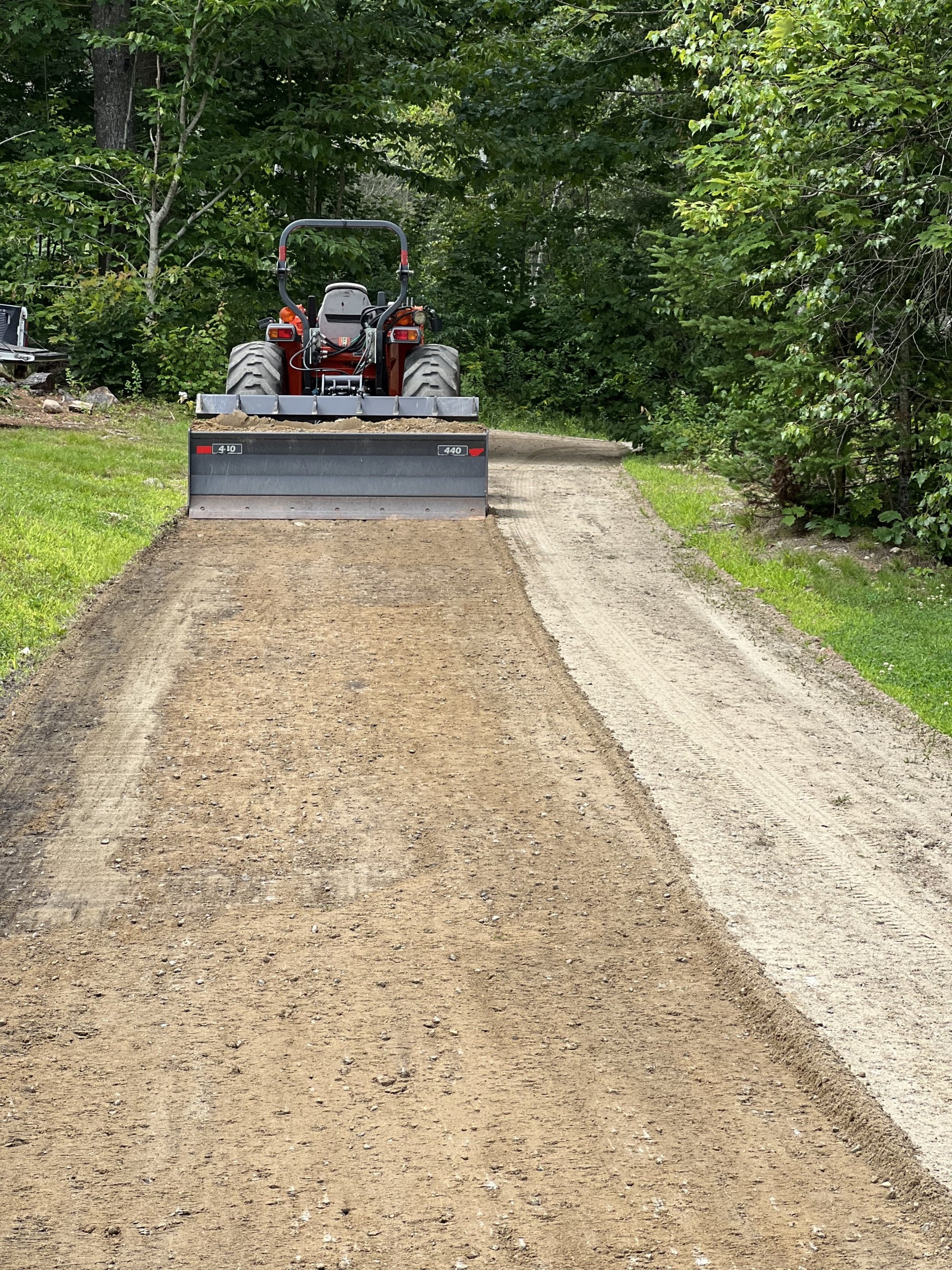

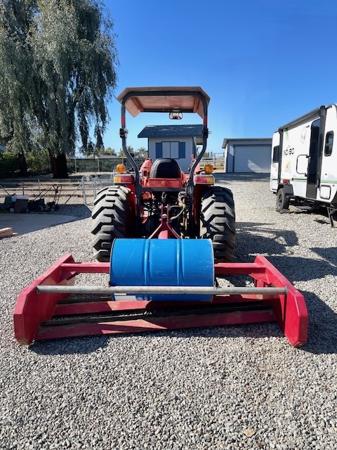

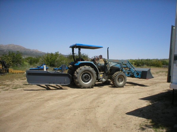

All I can say is that I have 4 different implements that I can use on my over mile long drive. A half mile is shared with 4 neighbors and often has wash boarding. I have what I consider above-average operator skills. All of these implements range from 800lb - 1400lbs. For general road maintanance, I can get the same results with any of the 4 implements. I easily complete this task in less than half the time with the LPGS (land plane) vs the box blade, rear blade or landscape rake. They each accel at certain specific tasks.
Unlike most people, I do not consider the LPGS a one-trick pony, but that is another topic. It excels at road maintenance and I can't even imagine not having it for this task after having used one.
Heck, I have 2, a 7 footer at 1400lbs and a 5 footer at 800lbs for my smaller tractor.
