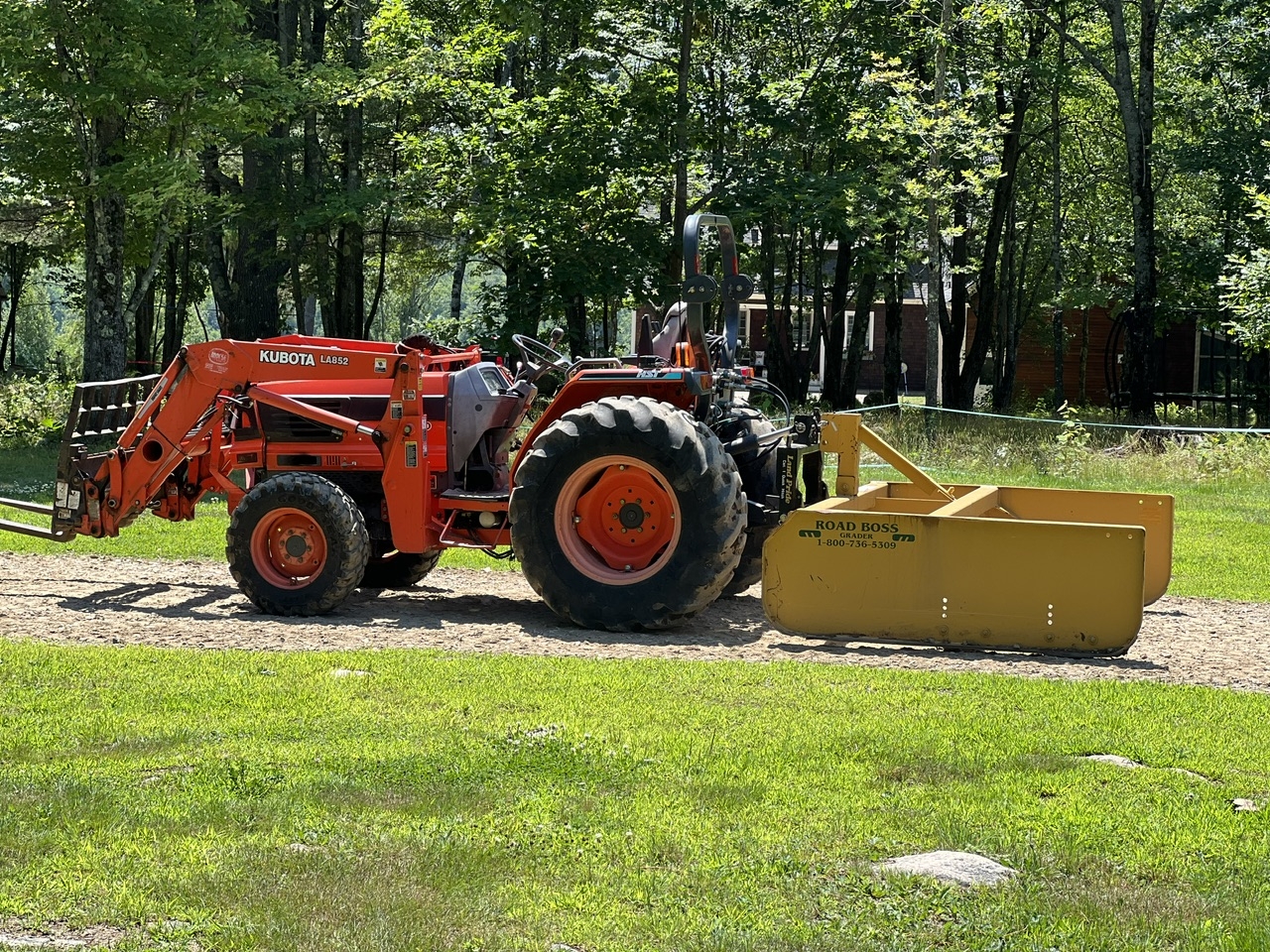

The sides on my 7 foot LPGS are 22" tall and 8' long. With the right moisture content (perfect for packing down) the DG (decomposed granite) that my road is made of clearly does not just flow over the cutting edges. But as shown, piles up and carries more than a cubic yard of material to be dispersed as needed. Now this is with the implement suspended at skid height. My cutting edges are 1/2" below the skids.
Moisture content changes how the implement is used-controlled immensely.
I typically do not need to reshape my road, this is simply keeping it in good shape.
When I need to move or shape the ground, I have other tools for those tasks. :)

Matt, you have what is probably the best LPGS currently made. Keep it and use it as-where needed. Even if you prefer the box blade, keep the LPGS and use as needed. I use mine for many other grading applications other than my roads. ;)
The voice of reason Brian :) I think this is exactly what I'll do. I think yet another reason I use the box blade almost every time, is because it's almost always on the back of the tractor, so even as easy as it is to drop it and pick up the land plane with the quick hitch, it's just easier to use what's already on the back as it is. Regardless, it never hurts to have too many implements laying around...

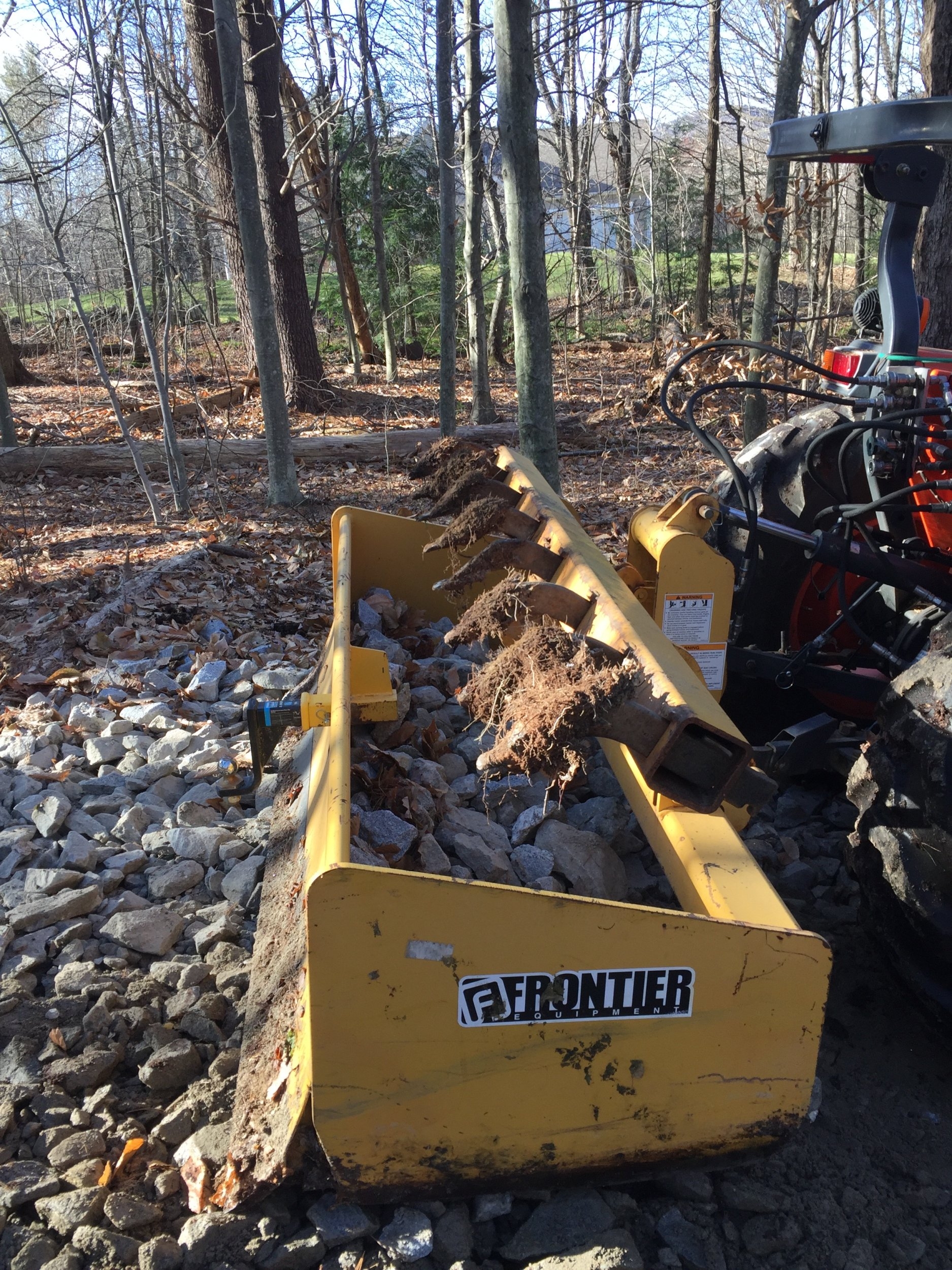

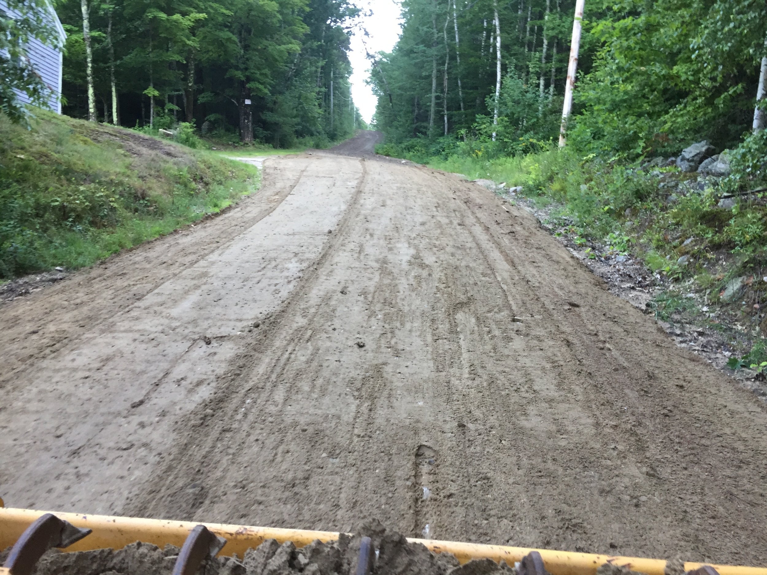

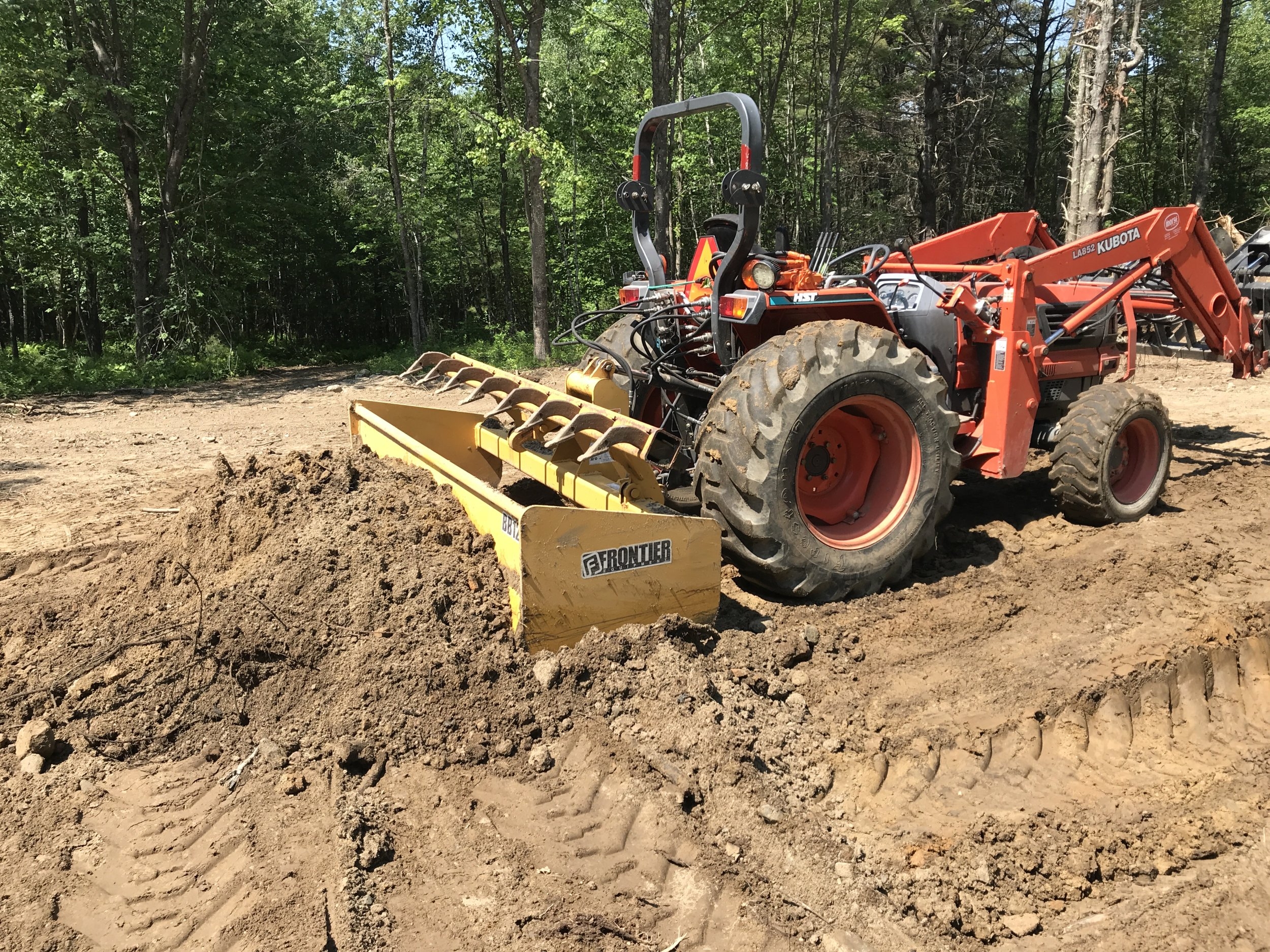

Do you have a box blade? In some cases, especially longer undulations of rolling hills, I've found it more useful to rough up the whole section with the rippers on the box blade, then carefully/slowly use the back of the box blade like a "bulldozer" in a sense, by operating in reverse and keeping the height at the same level. Of course, you want to be mindful how aggressive you are, as you "can" be more likely to bend your 3 point arms using it in reverse (I've never bent anything, but the almighty internet says I will every time).

Good lord man, I can't even dream up a nicer dirt surface to work with. My ground is the polar opposite of that beautiful flat surface! :D

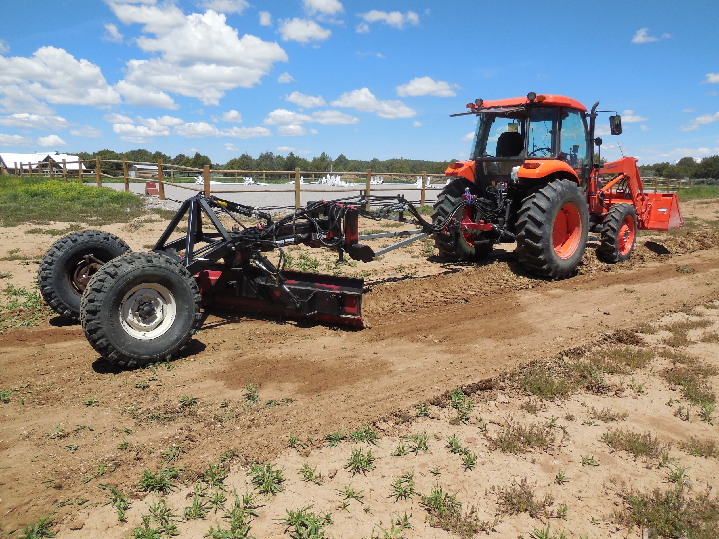

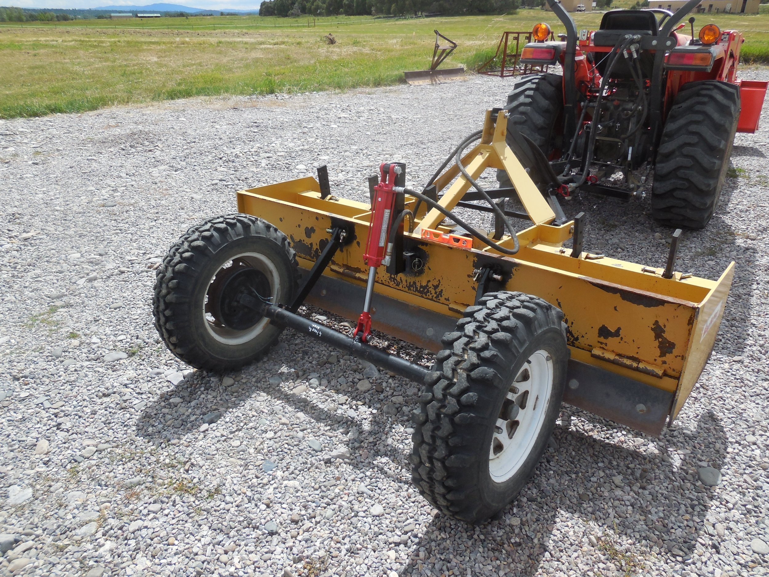

Something like this? Everything is pinned or bolted onto a regular box blade, and with the receiver tube on the tongue I can use whatever length 2" square extension I want. As long as I have enough hose length.
Also converted a 3-way blade to a puller version, using the same basic concept.

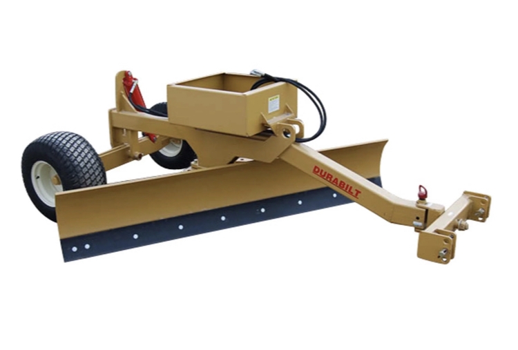

Yes, i did think of doing that and still might because its simpler and would accomplish basically the same thing. I have seen a couple pics of the thing ive described but i dont have them on my phone apparently.
You could think of it as like a pull type grader frame except instead of a permanently affixed grader blade, it would have a taller profile and its own 3pt linkage so that it could be maneuvered over any 3pt implement that would fit under it. So like this, but taller and with a longer tongue.

One disadvantage with my box blade version is that whatever grade the tires are at is what the blade will create. In other words, it can be tricky to make a 2% grade if the tires are at 3 or 4 degrees when beginning. That's one reason I made the 3-way blade, which can be adjusted accordingly.
Also, I cut down the trailer axle on the box blade a bit too much. With the narrow track width it sometimes wants to start hopping from side to side. Added 2-inch wheel spacers, which helped a bit.
With a regular blade, as in your photo, keep in mind that the effective width of the blade at max angle dictates how wide the axle can be.
Anyway, except for some hoses, couplings, and one cylinder (for the box blade), everything came out of the "stuff pile". On the blade, the cylinder for the offset was repurposed to lift the axle instead, even using the stock hoses.
