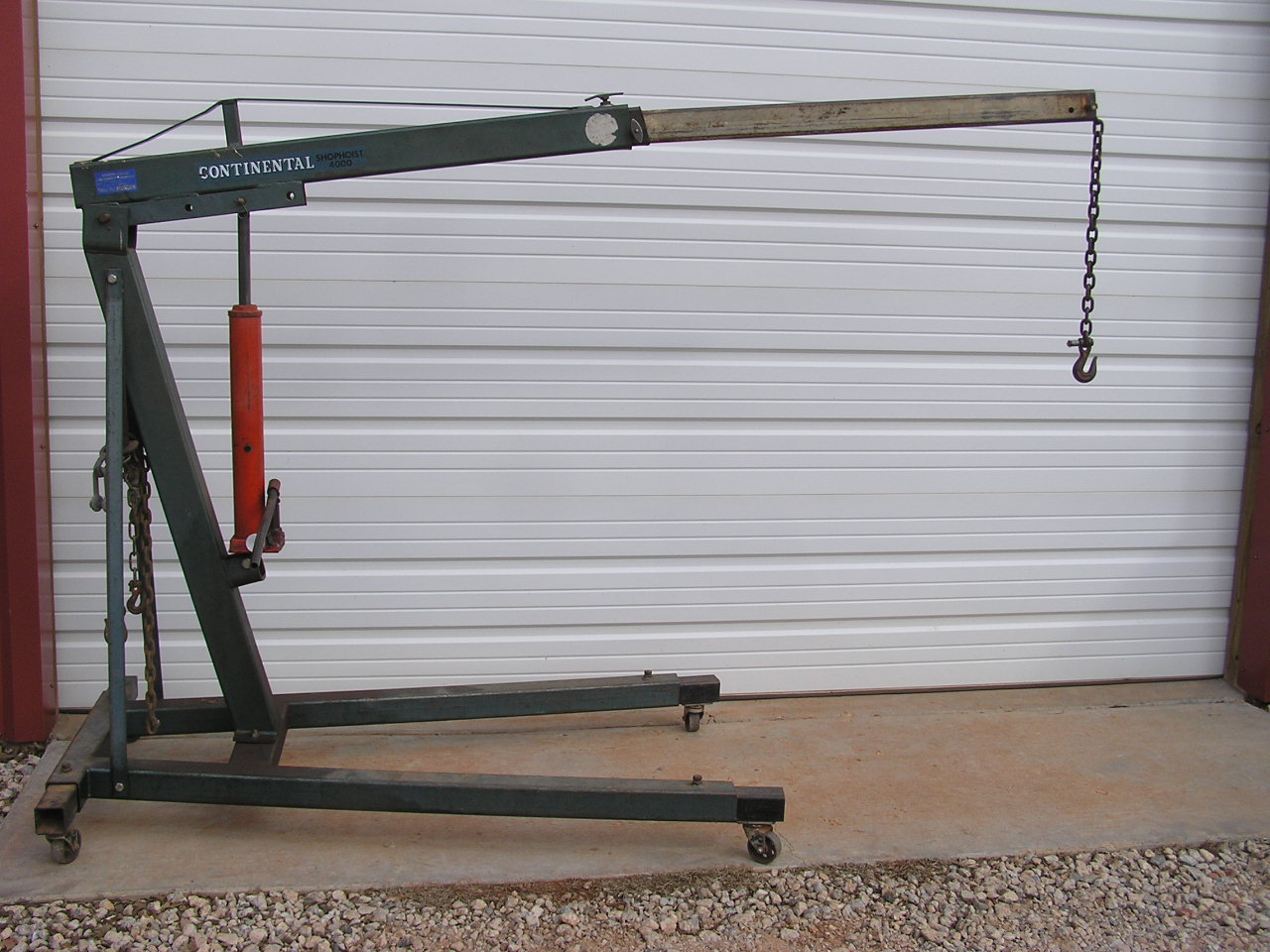

For stability's sake it wouldn't hurt to widen the stance but I'm certainly not equipped to remount the wheels myself (especially with 550 to 600 extra lbs of ballast each).-------------------
An engine hoist or shop crane would make it doable. :thumbsup:
tis what i use to mount / remount tires.
it does help to have second person. to hold tire some when putting bolts back on. and to simply stabilize tire as it gets moved.
it can take a couple tries letting tire down re-adjusting straps and lifting tire back up to get all the bolts to align up for you.
if you are not willing to do it yourself. see about them just bringing a unit to you and work at your place. it should be a fairly quick job without to much hassle.
most agriculture / industrial tire shops that come out to deal with tires should already have some sort of crane / boom on there truck to deal with stuff.
