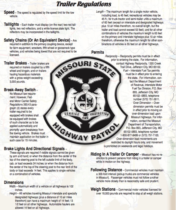

So does this mean a 20T or larger pintle hitch or bumper pull trailer hauling a dozer on it doesn't need brakes?
The trailer brake requirement law in MO doesn't make sense to me.
I agree. I think they are about the only state that doesn't require brakes at all (other than for HAZMAT or 5th wheel trailers)
If the trailer becomes detached while towing, it is no longer considered part of the combination, therefore gets treated the same as if it was parked. the question that I asked my insurance was if the trailer becomes detached from my truck while towing down the highway, is the trailer still covered under the vehicle insurance policy, and was told no. this same question has been discussed with other people that I know, and was told the same answer by their insurance also. I know it is a grey area, but comes down to if it becomes unconnected is no longer considered being towed.
Is that for liability (damage to others), or collision (damage to the trailer)? On the liability side, that it one reason why I carry a large umbrella policy.

In spite of what RANDYT claims,..... LIABILITY coverage DOES extend to the trailer from the towing vehicle, if the trailer should become detached, while being towed.
Umbrella coverage is a very good idea, but, you must also have underlying minimum liability coverage (specific to the terms of your particular umbrella), before the umbrella coverage will actually kick in.

Right or wrong, do you really want to find out the hard way.
/ Do I Need Trailer Brake? #88
It is not necessary to find out the hard way or assume a particular opinion is factual.
Hardly a complex question. Anyone wanting an answer could contact their agent or carrier´s personnel. Different carriers may give different answers.
