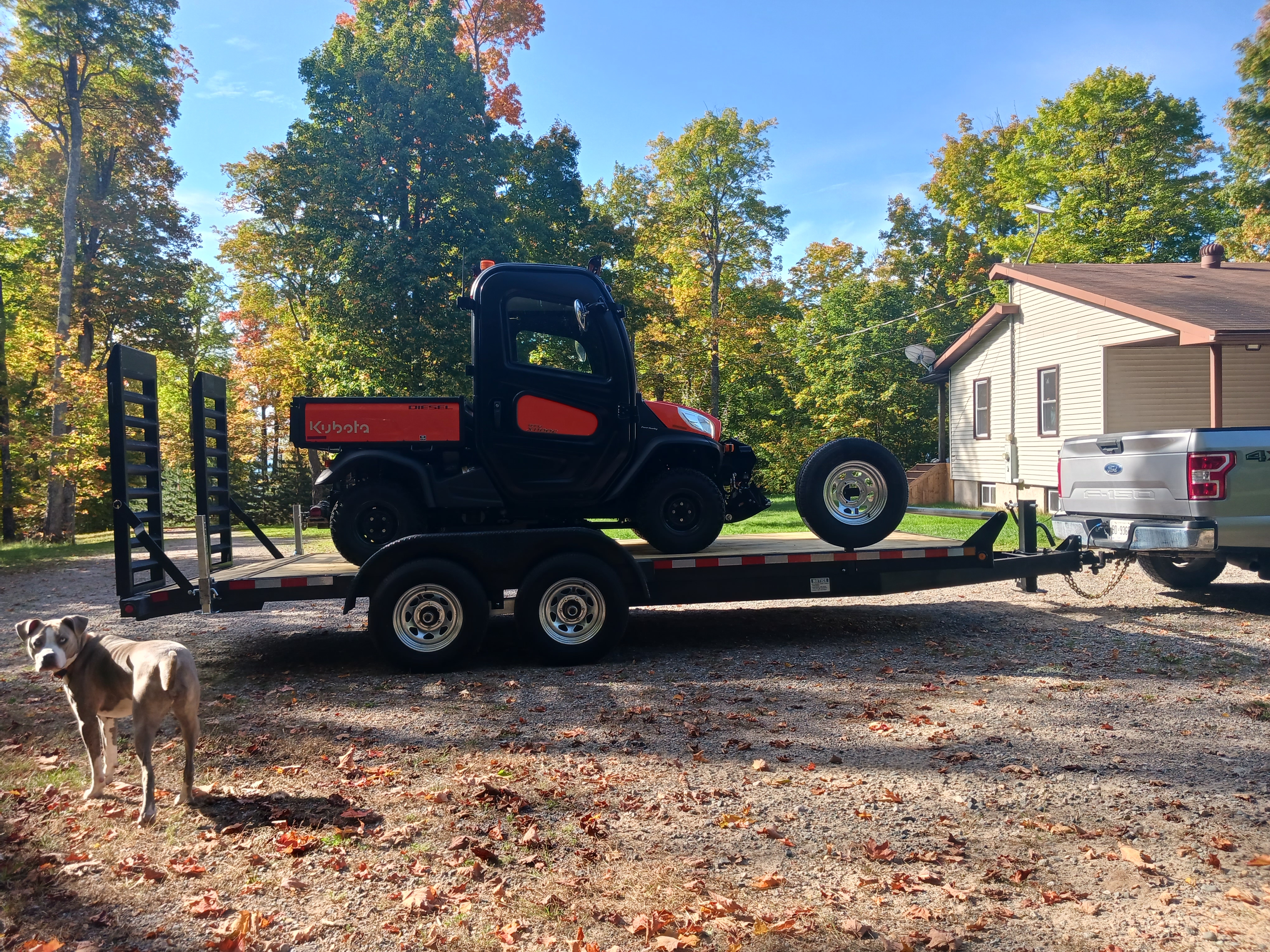

Finally got my new trailer. Couldn't be happier. Canada Trailers CE718-10K
Build quality and components are fantastic!
Tongue and front is done in a stone guard coating, 12,000 pound jack, rear jack legs, 5200 pound axles with brakes on both axles, Dexter hitch, galvanized rims and the suspension is all greaseable.
The aluminum trailer was nice looking, and light, but I was tired of having to go to the welding shop every time I towed it.

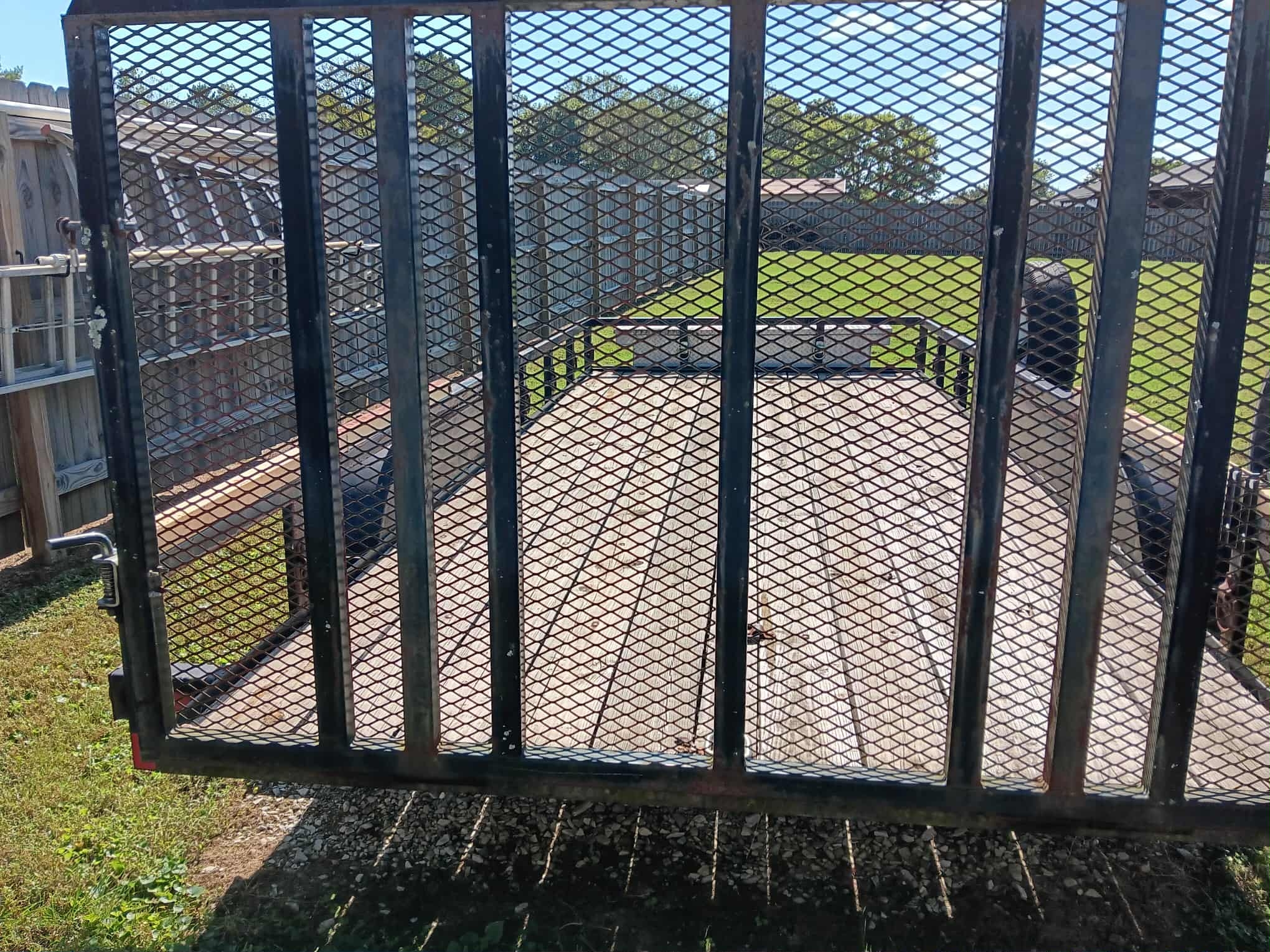

My steel trailer has that type ramp gate with expanded metal. Angle iron frame but 2x2 square tubing for support beams. When I bought trailer, I removed ramp and took to a friend that has welding shop and had him add an extra 2x2 support between the ones already there where my tractor wheels go when loading and unloading. 19 years later with a 4500 pound tractor and still looks like new with no caving or bowing, has acquired some rust though like yours.
/ New Trailer #6

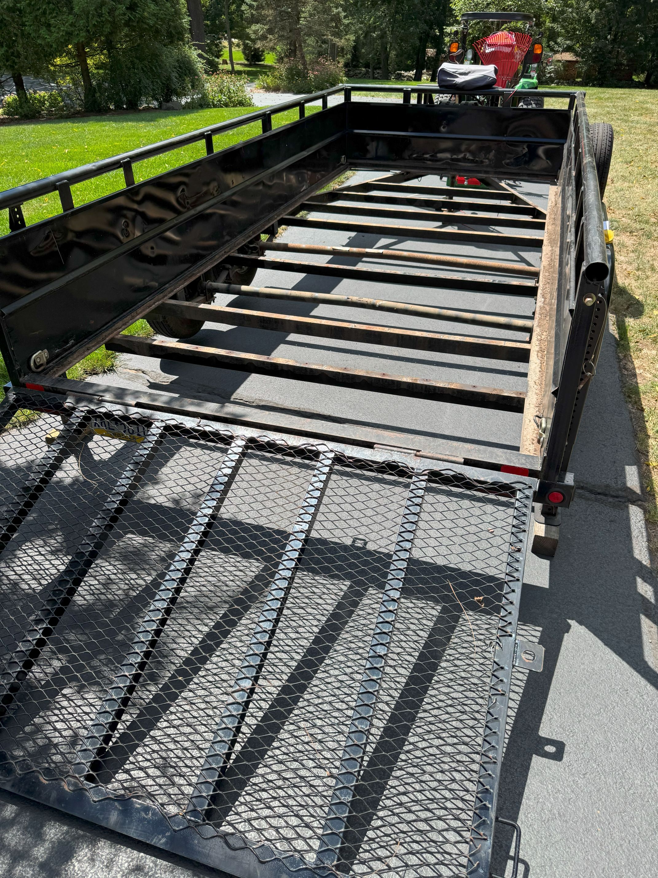

Interesting idea! Mine is 2" square tubing covered with expanded metal, and the tubing runs vertically:
My plan was to run pieces of 1/4" x 2" flat stock on edge, horizontally between the vertical 2" square tubes. With it tack welded to the expanded metal in a few spots along its length, it should be as resistance to flexing across its flat direction as if it were angle, but without the added air resistance that comes with blocking off another large fracton of the openings.
I never even thought of running more angle or tubes in the same vertical direction, but I suppose that would even better support the tires, which are forever landing between the existing square tubes.
And yeah... I know my trailer is missing a floor. I took this photo in the middle of a deck replacement job. :D

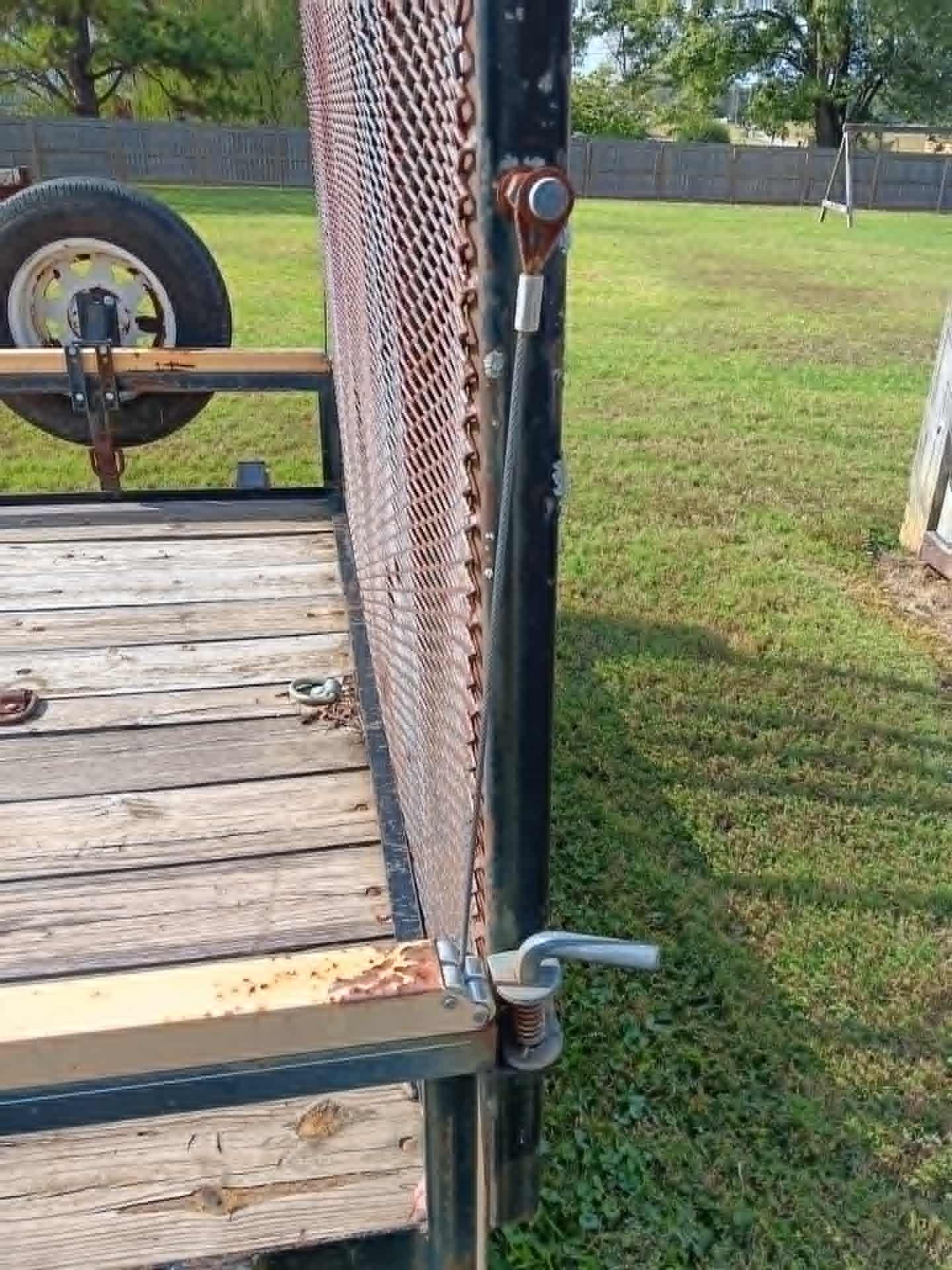

Never had the gorilla lift disconnected but they use a shoulder bolt to connect to ramp. Don't think it would be very convenient to bolt and unbolt on a regular basis. Was envious of the OP's alum. ramp also.
/ New Trailer #11
Maybe replace it with a bolt and then use a hitch pin to remove it.

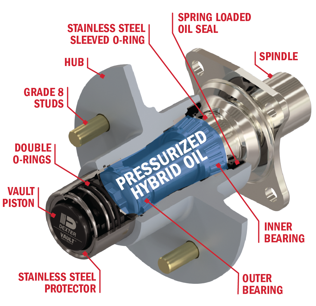

I think maybe you have EZ Lube confused with Dexter's proprietary system, which adds a second seal to the front end, and so it's like a Bearing Buddy. The Dexter does pressurize and can blow a seal, but not EZ Lube, as one end of the bearing assembly is wide open... only a dust cap that's removed while greasing, and which holds no pressure.
Neither system requires guess work. You pump EZ Lube until you see clean grease coming out, and you pump Bearing Buddies or Dexter until the spring compresses, stopping before the plunger bottoms out against a fully-compressed spring. The trouble is that too many people don't know this, and over-pressurize the Dexters or Bearing Buddies, causing the problem you found... seals blowing out. EZ Lube prevents this.
EZ Lube:
Dexter:
Disassembling hubs to manually pack bearings with grease certainly works, there's nothing wrong with it if you have time to burn. But I'm not going back to that, when there are options today that are better in every possible way.
