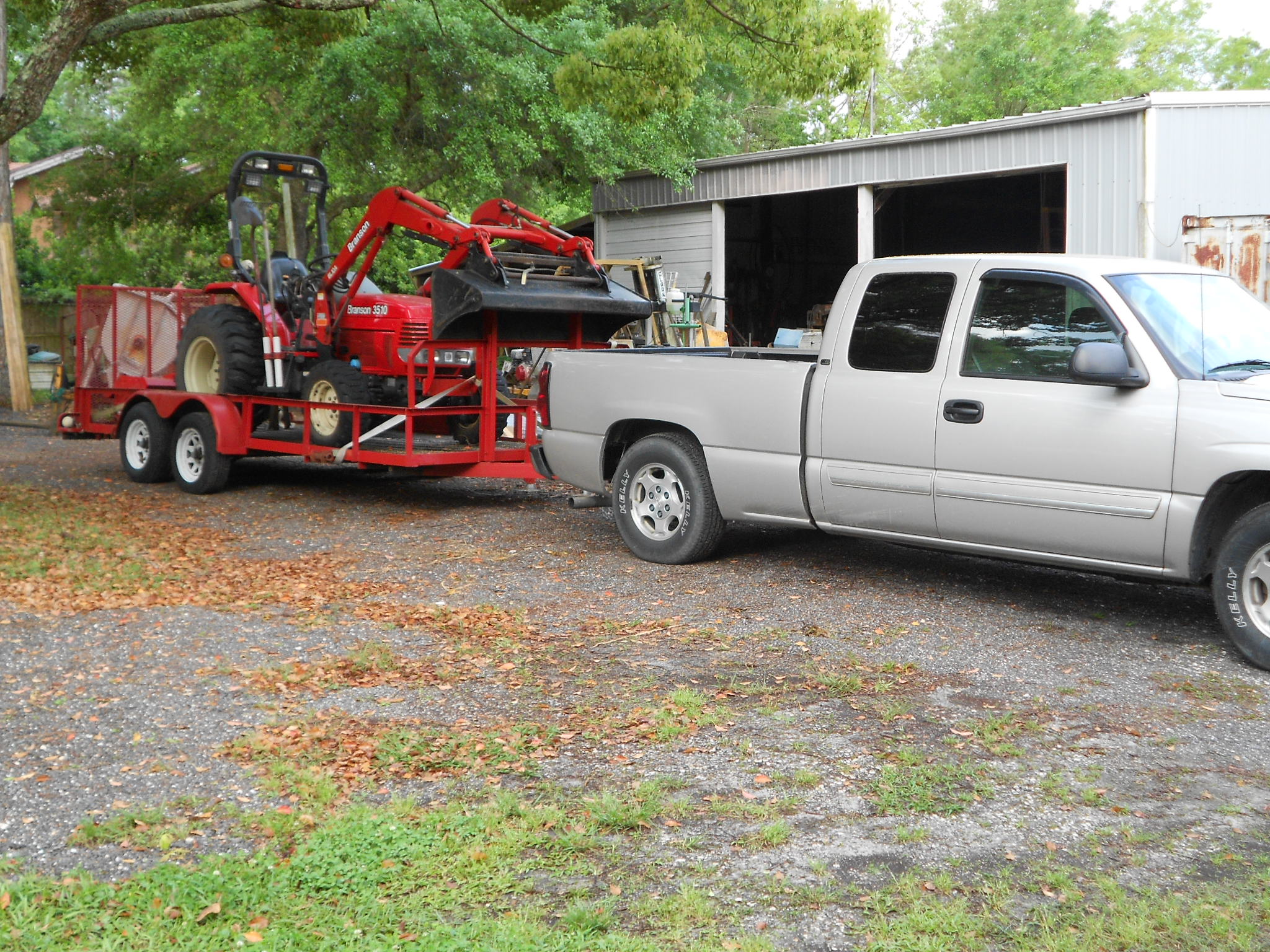

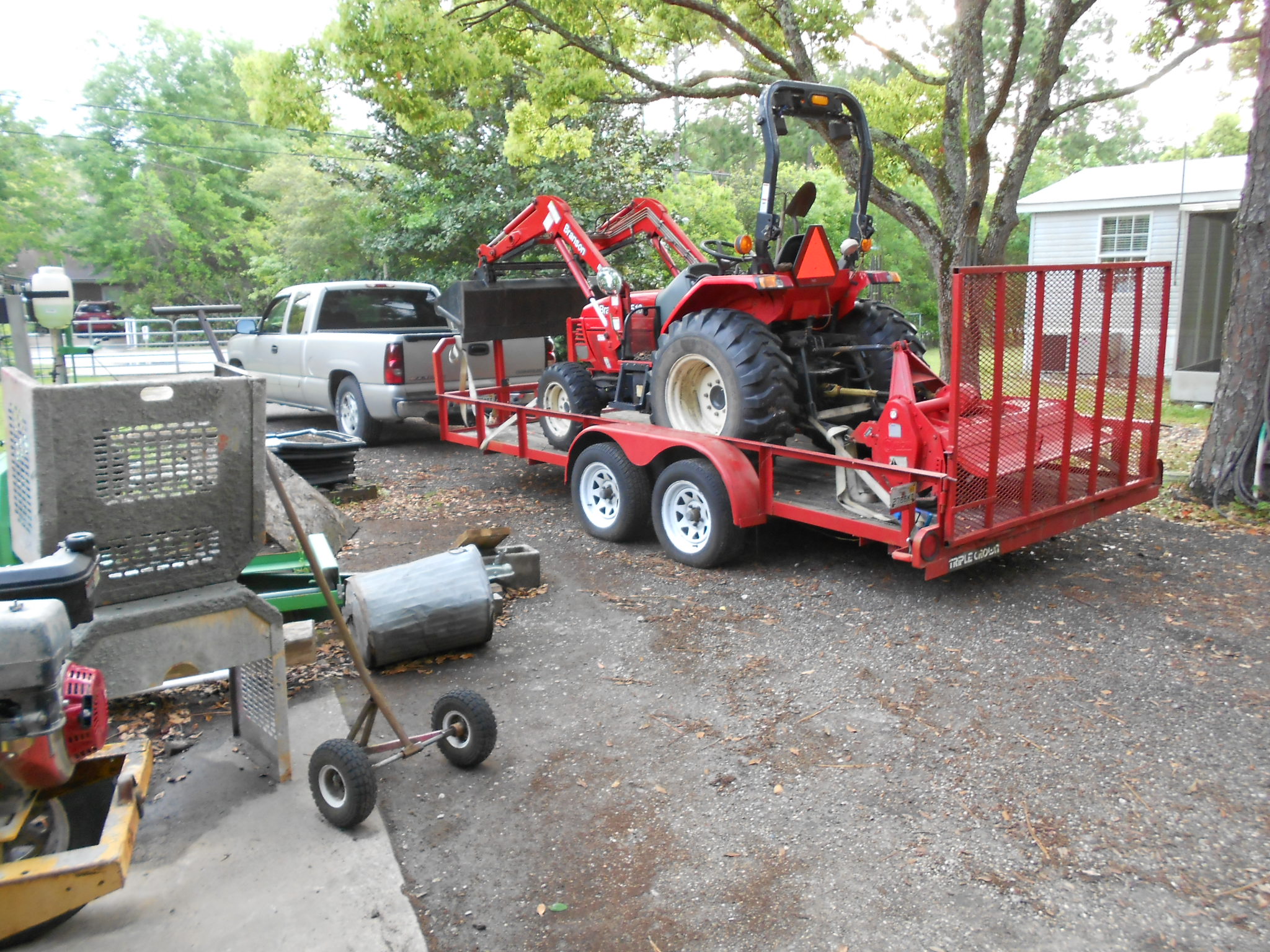

Exactly. Here in NC, the Legislature passed a law that allows bicycles to no longer stay to the right. Last year while pulling my 18' tandem loaded with Mahindra 5035, 4n1 bucket with Leinbach gang harrow attached, I come around a curve on the two lane rural road and meet four bicyclists. The two in the rear were far to the right, while the two idiots in the front were taking the whole lane. With a car coming, I had to lock up the trailer brakes for the idiots and they cussed me till I was out of sight. Stimw hit the nail on the head, the roads are full of idiots and they will get you killed. Emphatically yes, hook up the trailer brakes, pull the wheels, clean and check pads and wiring inside wheels.
