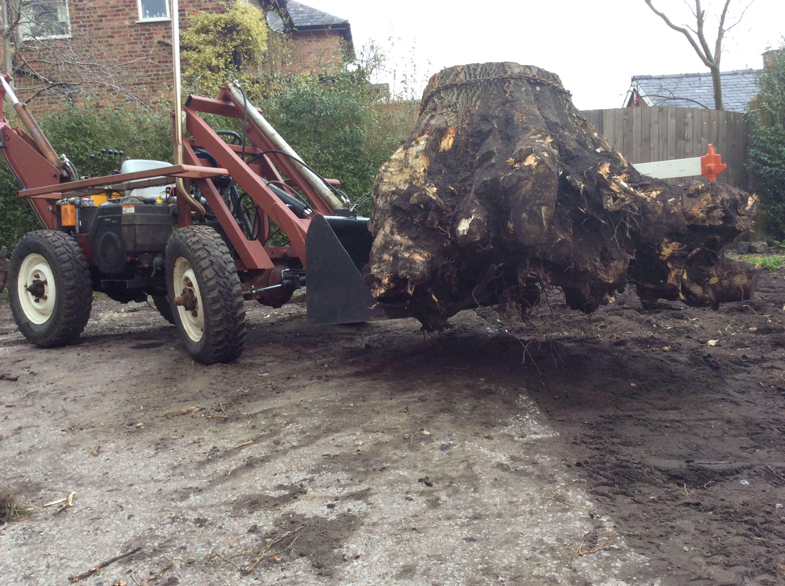

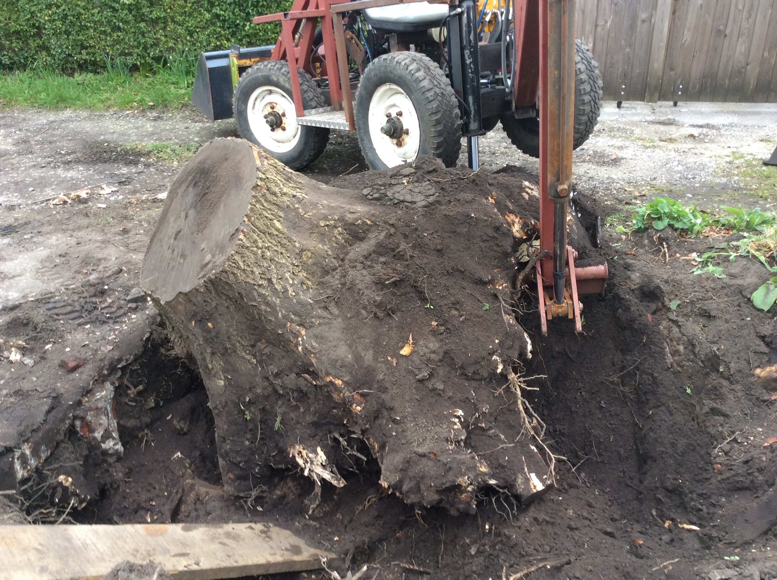

The house was built around 1865, the two big Ash trees that we had felled last summer due to rot were clearly over 140years old. Counting the rings on the stumps certainly makes you think about past events.
I was hoping to find all sorts of buried treasure around and underneath them when I dug them out but all I found was a perfume bottle and a beer bottle stopper. Oh and parts of the base of an old wrought iron fence that had been absorbed by the roots. That really took the edge off my axe!

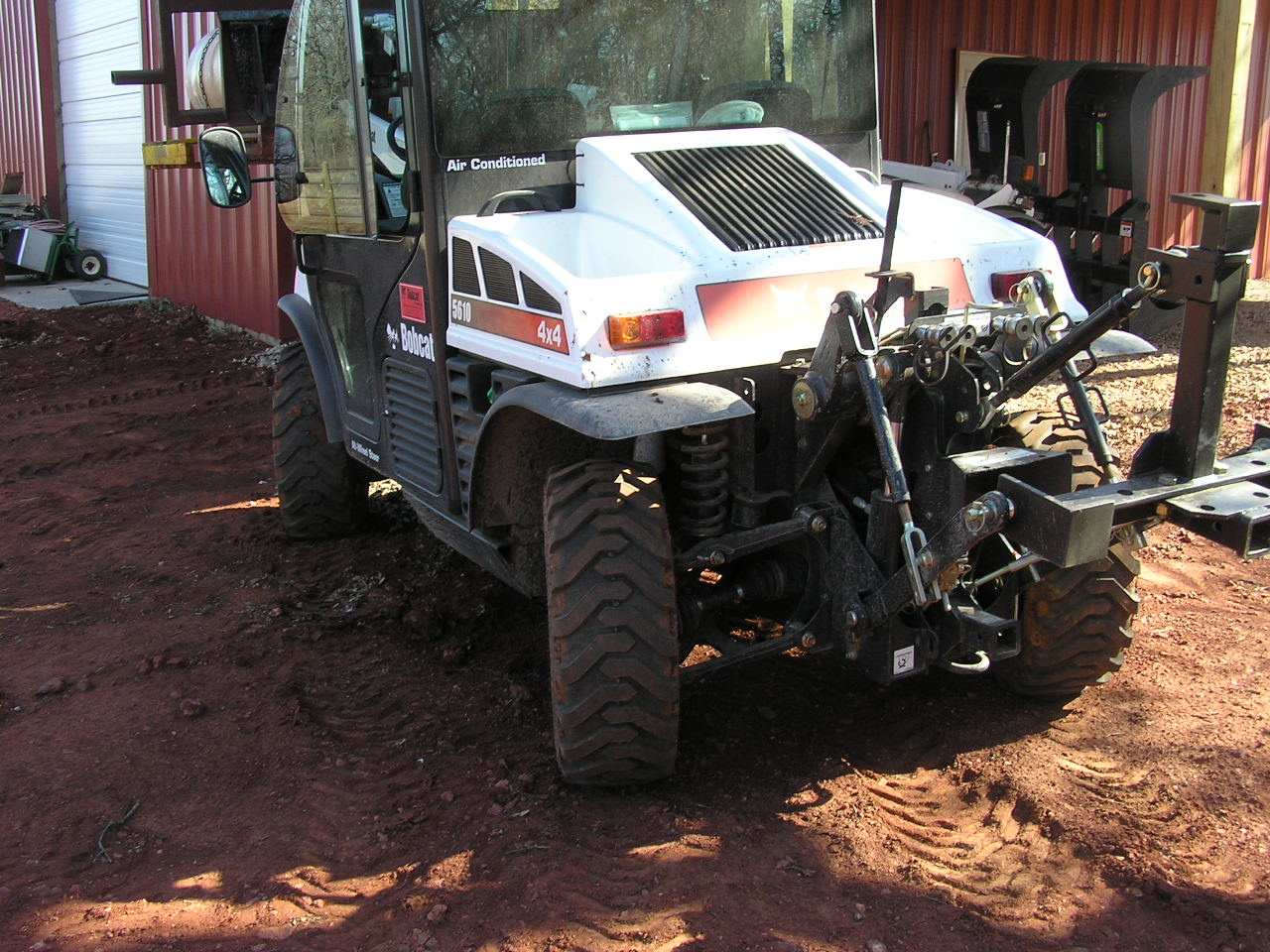

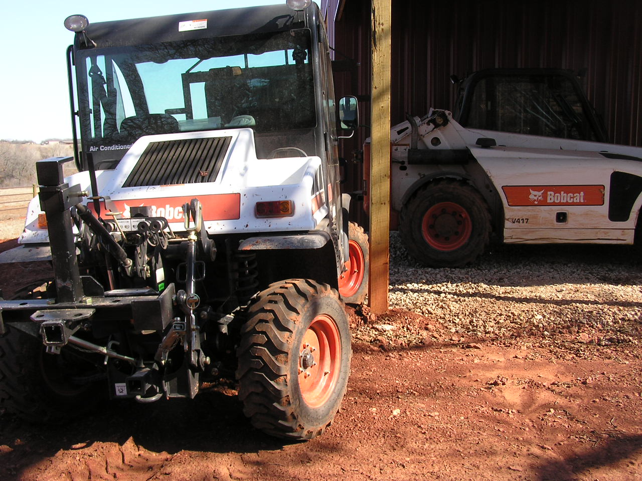

Crab steering is very useful and does not affect stability:
   / DIY Mini Digger #87
Like the concept of that 5610, but the price and complex nature of the machine kill the aspiration of ever owning one of those.
I do have an entire Jeep cj5 with a bad frame I bought this fall for the fiberglass body. But I don't know if I want to get into a fab project of this scale.

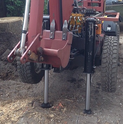

Yes it surprising, the tyres (OK tires) seem quite tough until the back hoe gets pulling under a big root.
Unfortunately I didnt plan the layout very well and ran out of room by the time I got to thinking about the outriggers. The leg rams sit within the two vertical channels and really should have been spaced as wide as the wheels but it would be a major job to start again. So the plan is now to have horizontal extending legs each side mounted on pivots behind the rear differential and spanning out diagonal as wide as the wheels with the rams bearing down on them at mid point. The rams move in a fixed plane up and down so the legs will have to extend (telescope) between the fixed pivot end and the ram mounting point. That is a job for the summer when I strip it down for fettling & paint.
Here is a photo of what it looks like at the moment, the rams are over kill but I picked them up cheap!
outstanding work and build,:thumbsup:
here is a idea for the outriggers , hope it makes sense lol
its way out of scale to your pic lol,
thanks godbless
