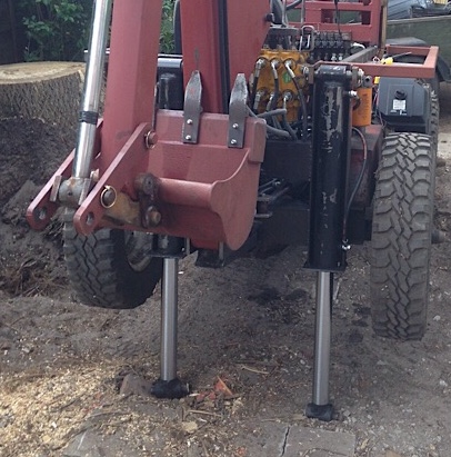

/ DIY Mini Digger #75
Impressive work! Another purpose of outriggers on a backhoe besides stability is to reduce the stress on your rear axles while digging, and remove the bounciness of your rear tires.
/ DIY Mini Digger
#76
Yes it surprising, the tyres (OK tires) seem quite tough until the back hoe gets pulling under a big root.
Unfortunately I didnt plan the layout very well and ran out of room by the time I got to thinking about the outriggers. The leg rams sit within the two vertical channels and really should have been spaced as wide as the wheels but it would be a major job to start again. So the plan is now to have horizontal extending legs each side mounted on pivots behind the rear differential and spanning out diagonal as wide as the wheels with the rams bearing down on them at mid point. The rams move in a fixed plane up and down so the legs will have to extend (telescope) between the fixed pivot end and the ram mounting point. That is a job for the summer when I strip it down for fettling & paint.
Here is a photo of what it looks like at the moment, the rams are over kill but I picked them up cheap!

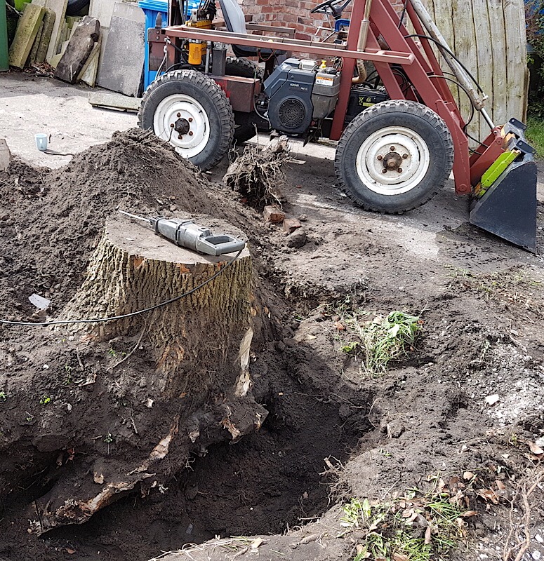

This is what I was using it to dig up yesterday...
