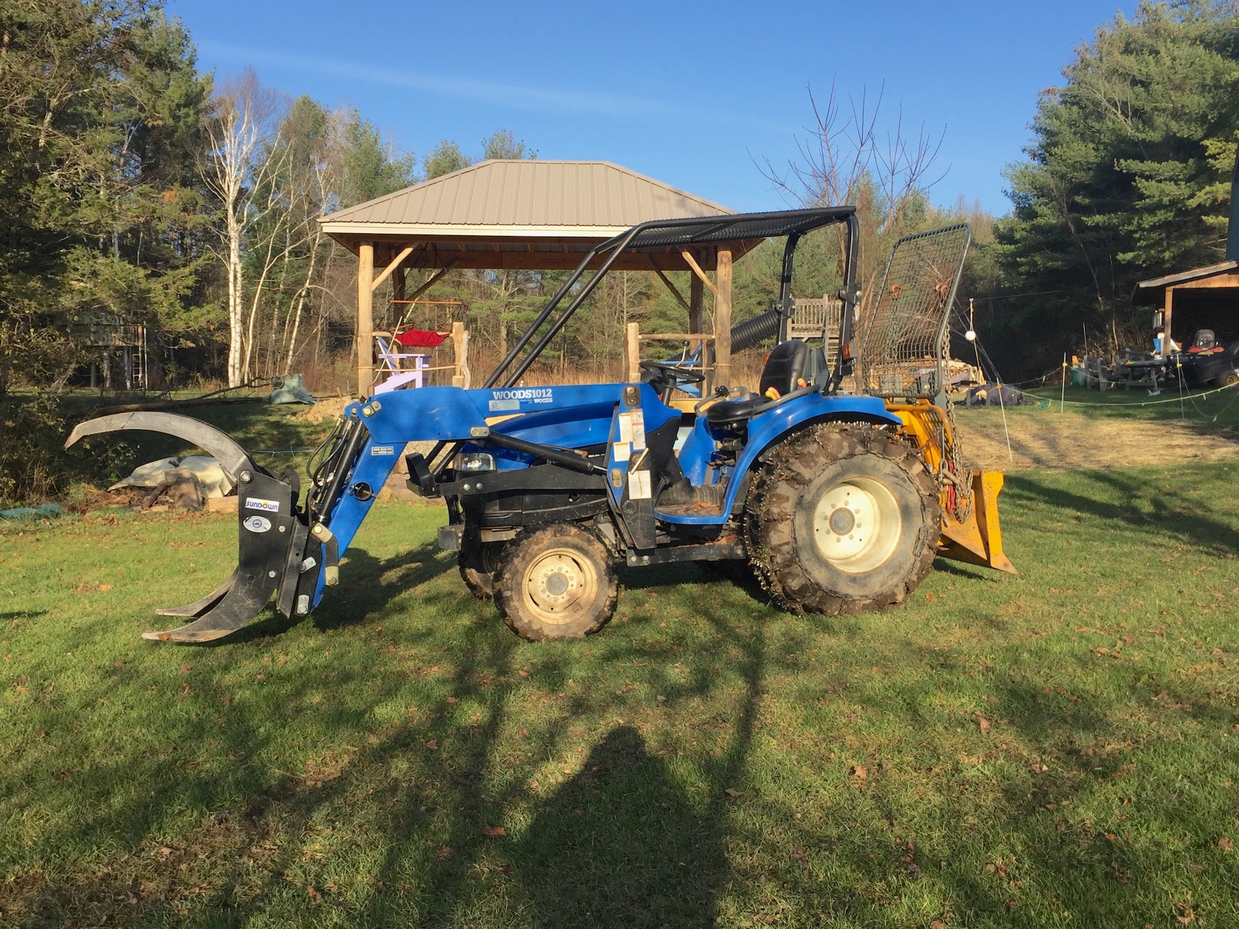

Well said John. I see in your profile you have limb risers, I think that is a heck of an idea and once I get the front part of the cab back on I will probably add them. I have to build some ROPS and a top from the windshield frame to the ROPS.
Here are a couple of shots of my little tractor in "Logging Mode". You can see the limb risers. Now that I have them, I don't know how I got along in the woods for so long without them. There is also a belly pan underneath, attached mainly to the backhoe subframe, with a separate extension going forward and up one side a bit to protect a hydraulic filter (it comes off by removing 2 bolts, for easy access to the filter). The limb risers were designed to clear the hood in front, so I can still pop it up for service.
(I used to know how to make these pictures display bigger, rather than as a thumbnail, but have forgotten how to do that)
Things I might change in future, or if I were doing it again:
  1. I probably should add some uprights going from the loader frame rear posts up to the front of the FOPS structure for added strength (on the other hand, I'm trying to protect from falling branches, not dropping a whole tree on the tractor). I could still do this, just hasn;t been a priority.
  2. The limb risers come down almost to hood level in the front. I probably could have come straight up for a bit, even with the top of the brush guard bar that is a part of the loader frame, and then angled back. I run with the loader frame and bucket or grapple installed all the time, so I guess it doesn't make much difference - the loader arms already stick up higher anyway.
  3. I will eventually add grill protection (expanded metal?) to that brush guard that is on the loader frame (probably right after a branch punches a hole in the grill). Haven't thought about how I want to do that to still maintain easy access under the hood.
  4. the "roof" is expanded metal. I thought having some upward visibility would be a good thing. I still like the upward visibility, but getting the shower of needles and fragments down my back when I drive under a cedar tree is not exactly a welcome event. I may replace it with solid metal (maybe leaving a bit of expanded metal exposed for the front few inches so I can see a bit of what is going) or perhaps add a sheet of plexiglass over the expanded metal.
  5. I've considered a full cage structure around the operator as I've seen on other woods tractors around here. I'm leaning against it at this point. If this were a "hard core" logging tractor, I probably would (but in that case, I would also have a significantly bigger tractor).
Disclaimer: I did not do this work myself. A fab shop just a couple miles down the road from me did it (I don't trust my welding enough when safety and extreme durability are concerned). I've seen the modification work this guy has done for pro loggers and farmers. He is a genius at what he does. He came up with most of the design thoughts on this, including things I wouldn't even have thought to ask for. It's great having someone to assist in the design who has done a number of these over the years.
To the OP: sorry for the topic drift.

John that's a great looking setup! I love it, hope to someday get me a nice tractor (4x4)
Here's a thought on your roof, put some Lexan over the expanded metal, best of both worlds.
