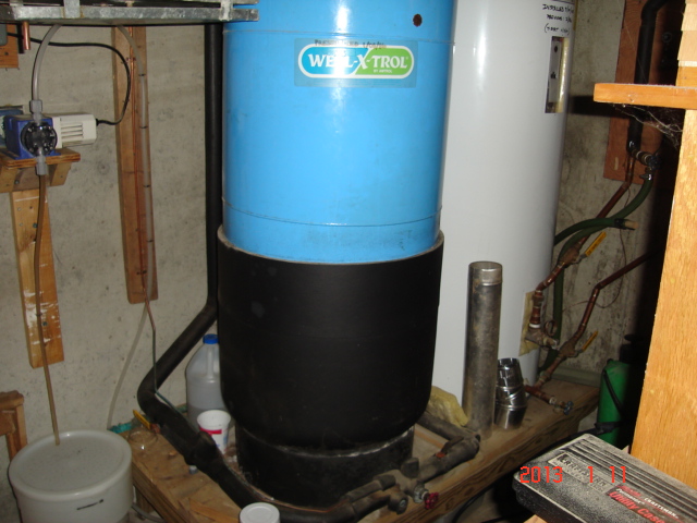

Both the stripping and the Armaflex should be available through a refrigeration (or perhaps restaurant) supply house; I used to work with the stuff all the time (previous lifetime).
Armaflex insulation is very good stuff, available in both tubes --for piping-- and sheets. Here's what I did to my extra-large domestic water pressure tank, to keep it from sweating in the summer; worked very well:
