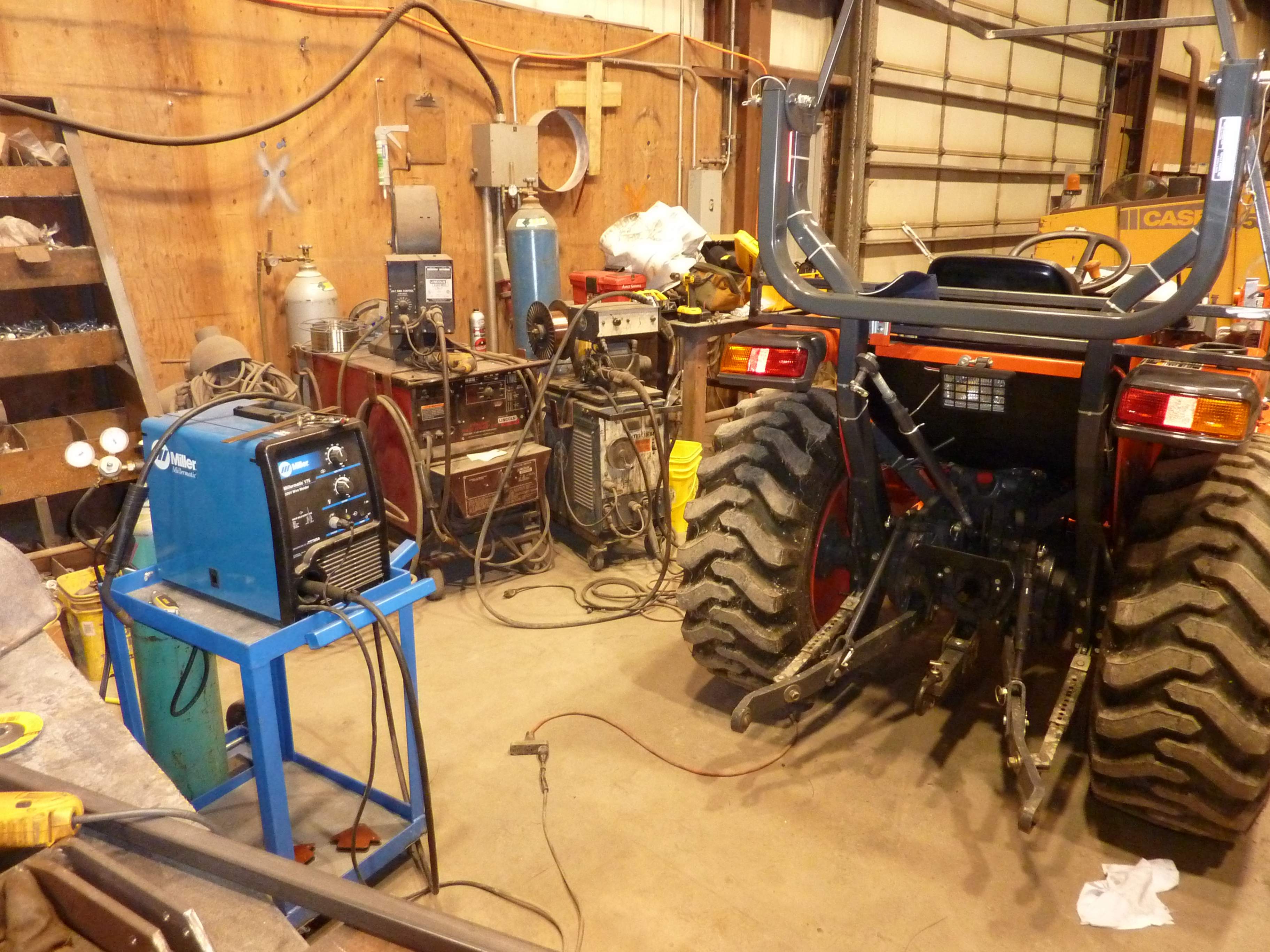

B. Get a decent place to work on it. At home the driveway would be the workshop (never convinced Wifey of the need for a pole barn). Just so happens there is some space in the fab shop at work. More on that later.
C. Get pointers from guys who know their way around steel fab and with my welder, rather than have them make it for me. We have lots of machines at work, but I wanted to be tutored and use my Millermatic 175. Remember the old "give a man a fish / teach a man to fish" thing?

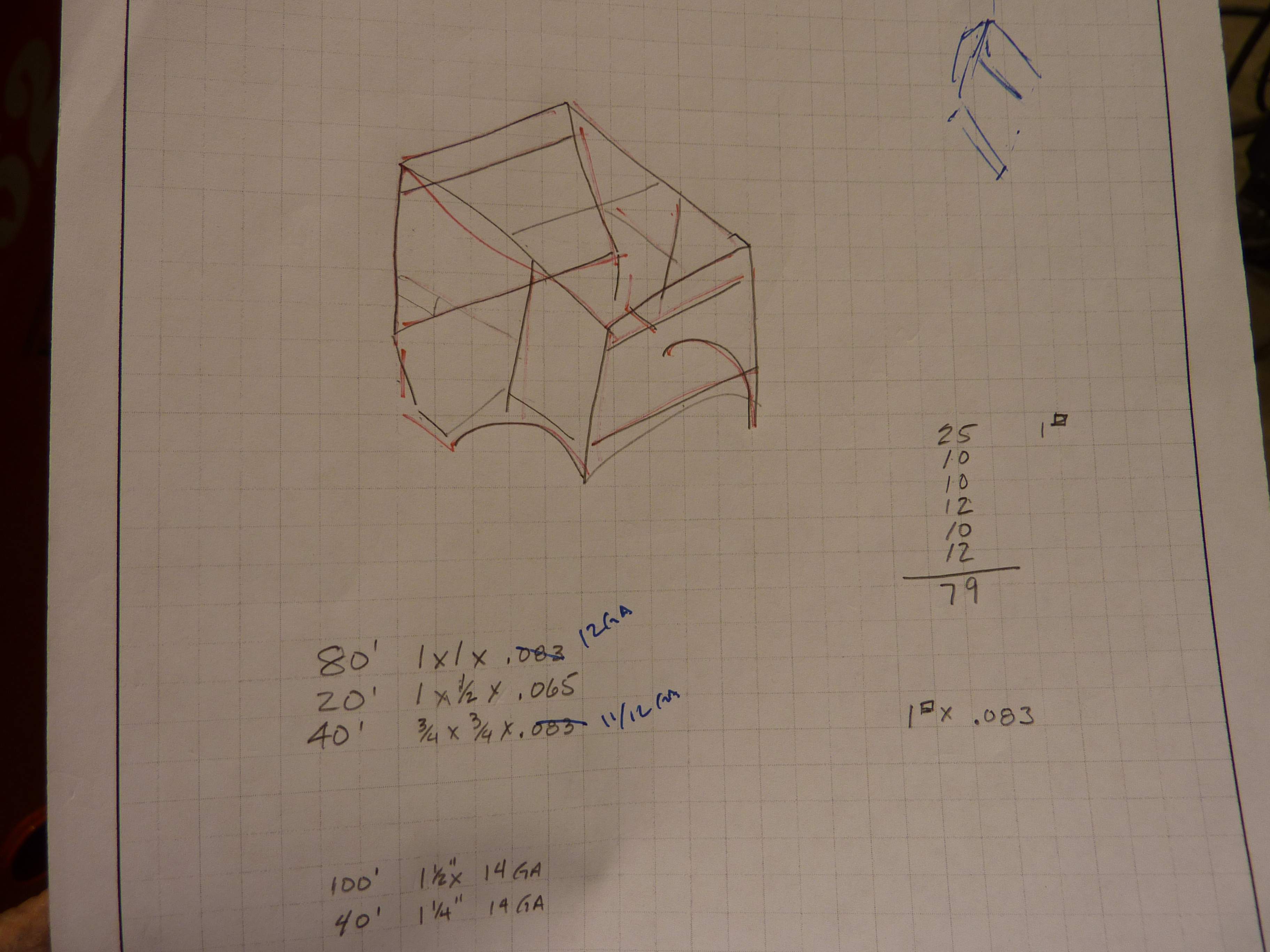

D. Have a plan. The amount of detail may be a lot different for different people. For some things I do it works best to make CAD drawings and have everything planned to the last nut and bolt. For others I go with solid concept, some desired details and a fluid plan. Flew with the latter this time.

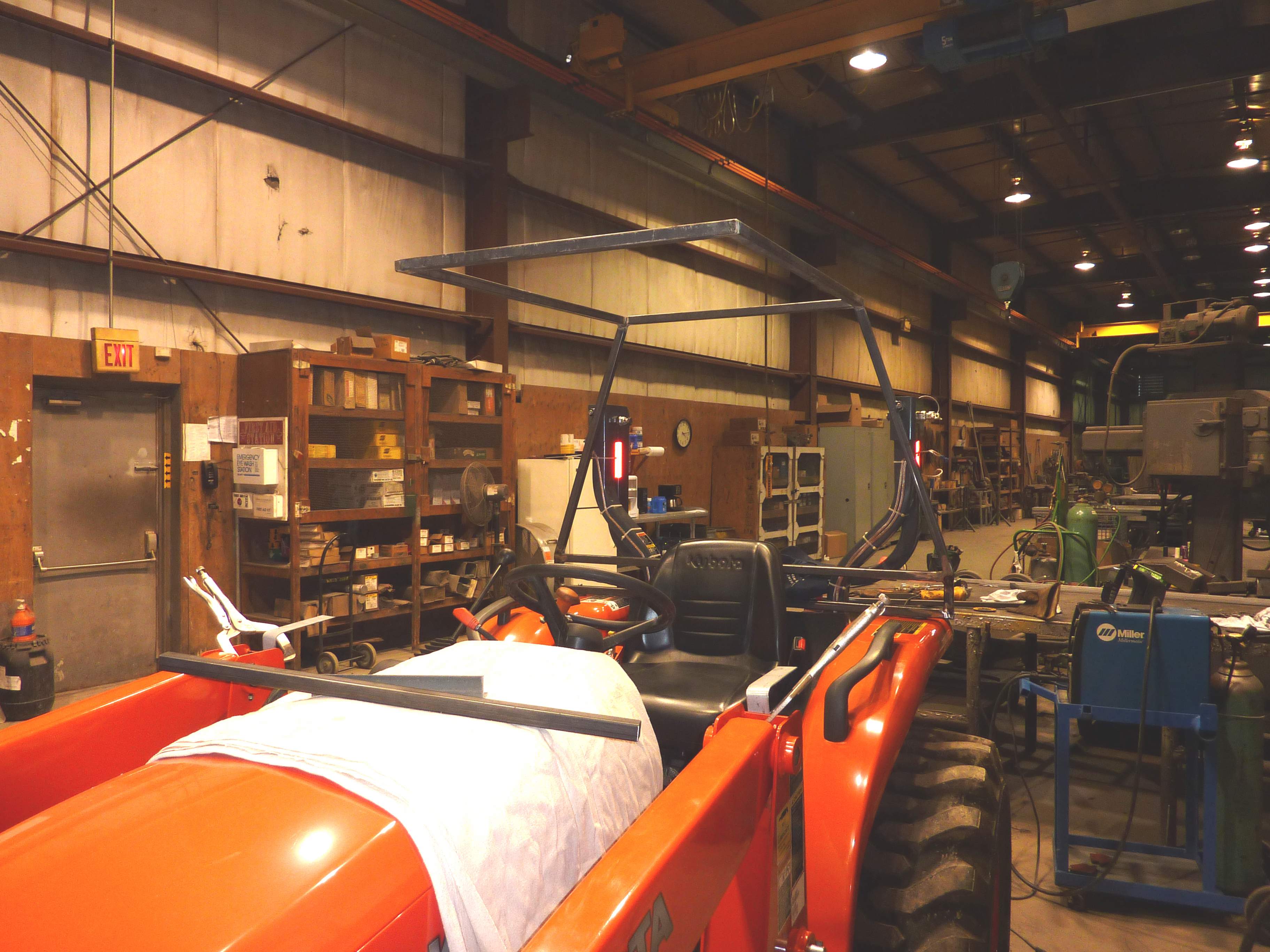

So, the plan involved a rudimentary sketch or two and a list of several items. Deemed necessary were glass (any plastic will eventually be scratched), wiper, heater and an interestng shape. One cab builder posted that the neighbors named his plexiglass cube first build "the Popemobile". Another noted his first build was, in his words "a cab which not only was an embarrassment to myself but my entire family both living and dead". Mine also needs to be sectional and removeable by 1 or 2 guys. Needs to mount to the tractor without scratching it all up.

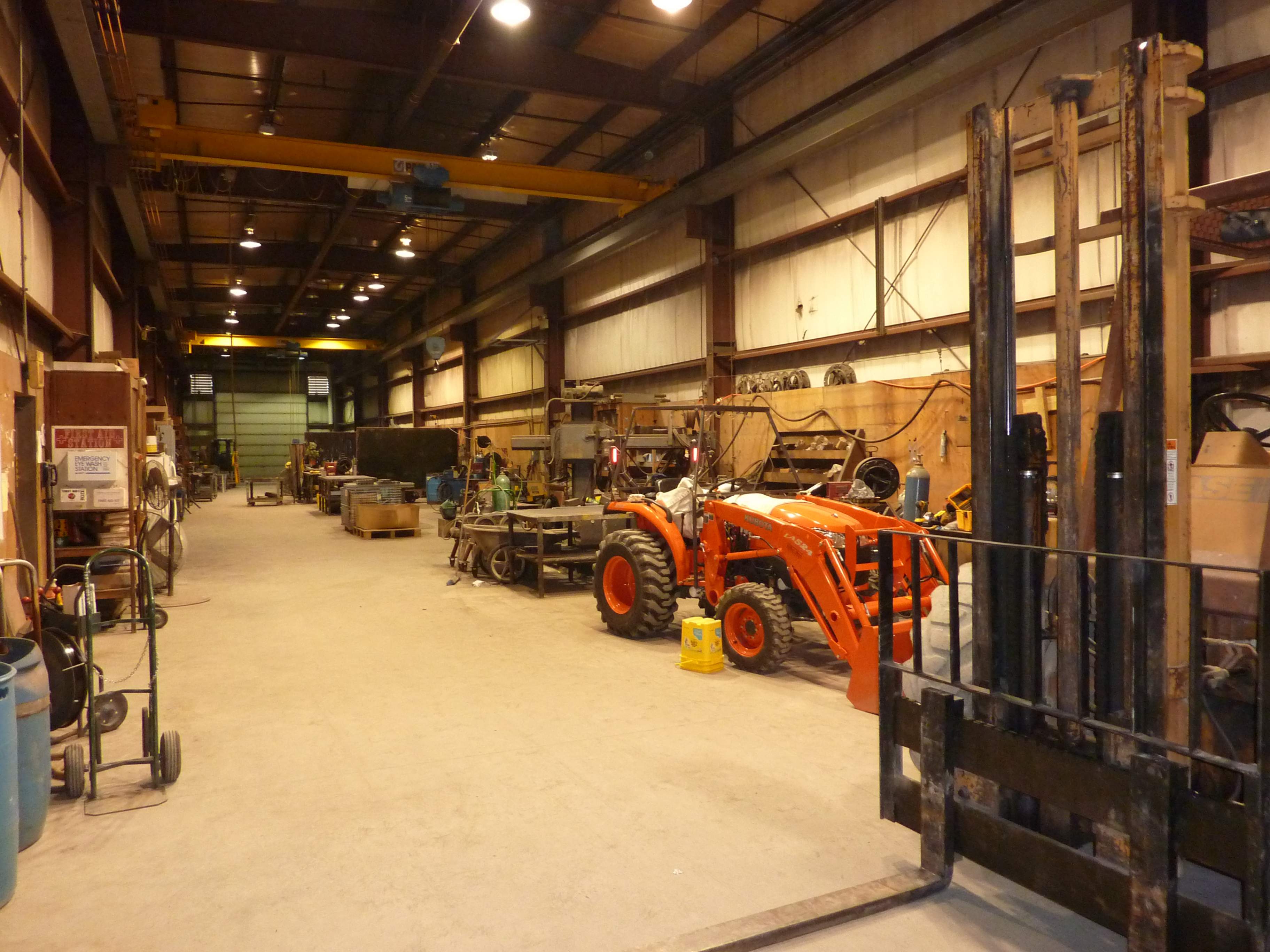

I gathered the steel, door handles, wiper and heater over the past month. This week I moved my stuff into the unoccupied work station in the shop at work. I had the welding super get me going and immerse me in things like what order to tack things to avoid the taco looking piece that should be flat. He worked on the back/top assembly with me and although I have a LOT to learn I'm off to a good start. Today I was able to get the front welded up and the right side all tacked.

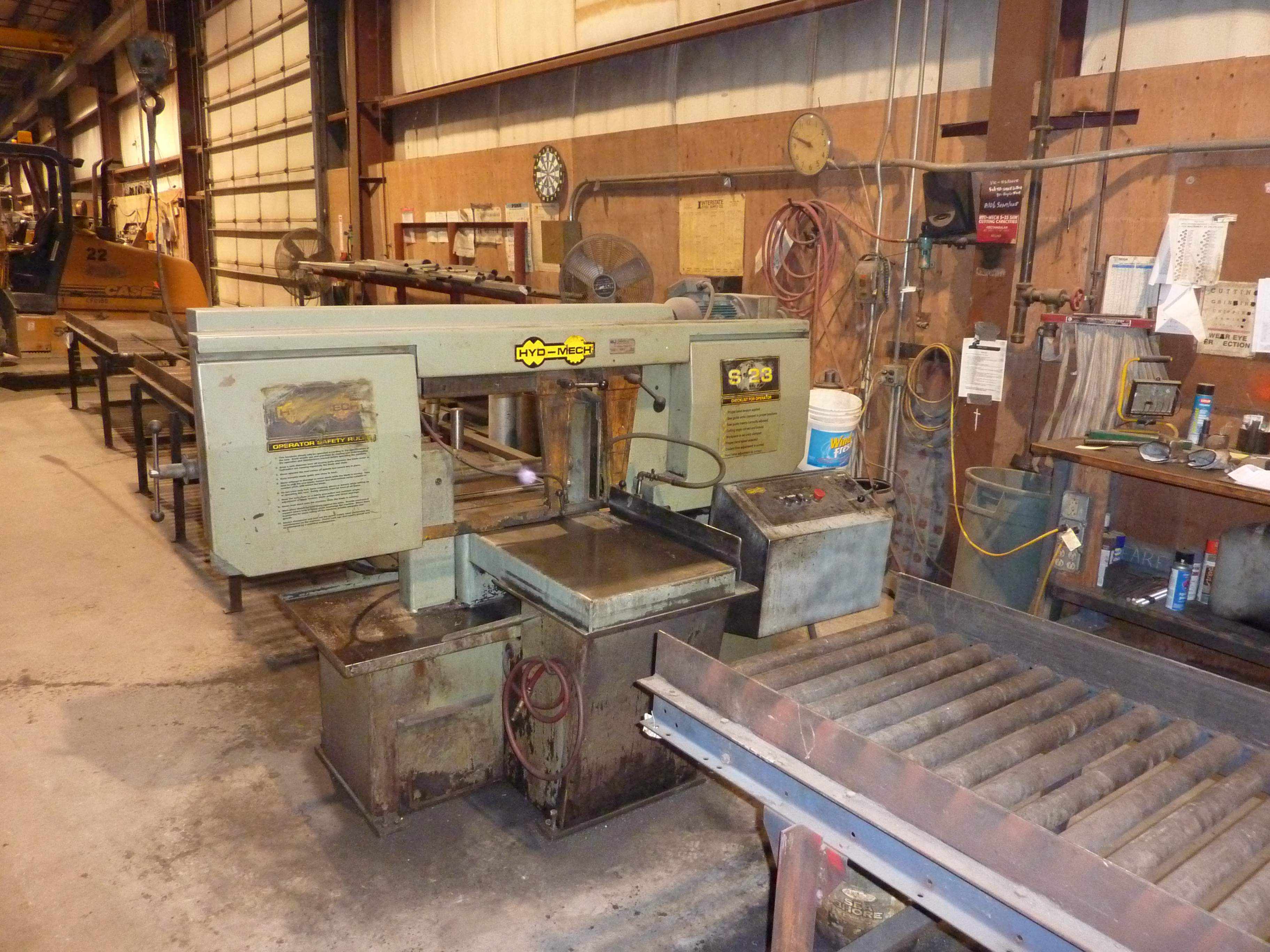

Here are the master plan, a couple shots of the work area and a saw that would scare the daylights out of my Harbor Freight 6x4. It cuts 6" schedule 40 pipe like nothing. One lever works the hydraulic ram that holds the material to be cut. Another lever controls up and down of the saw. Awesome piece of machinery.

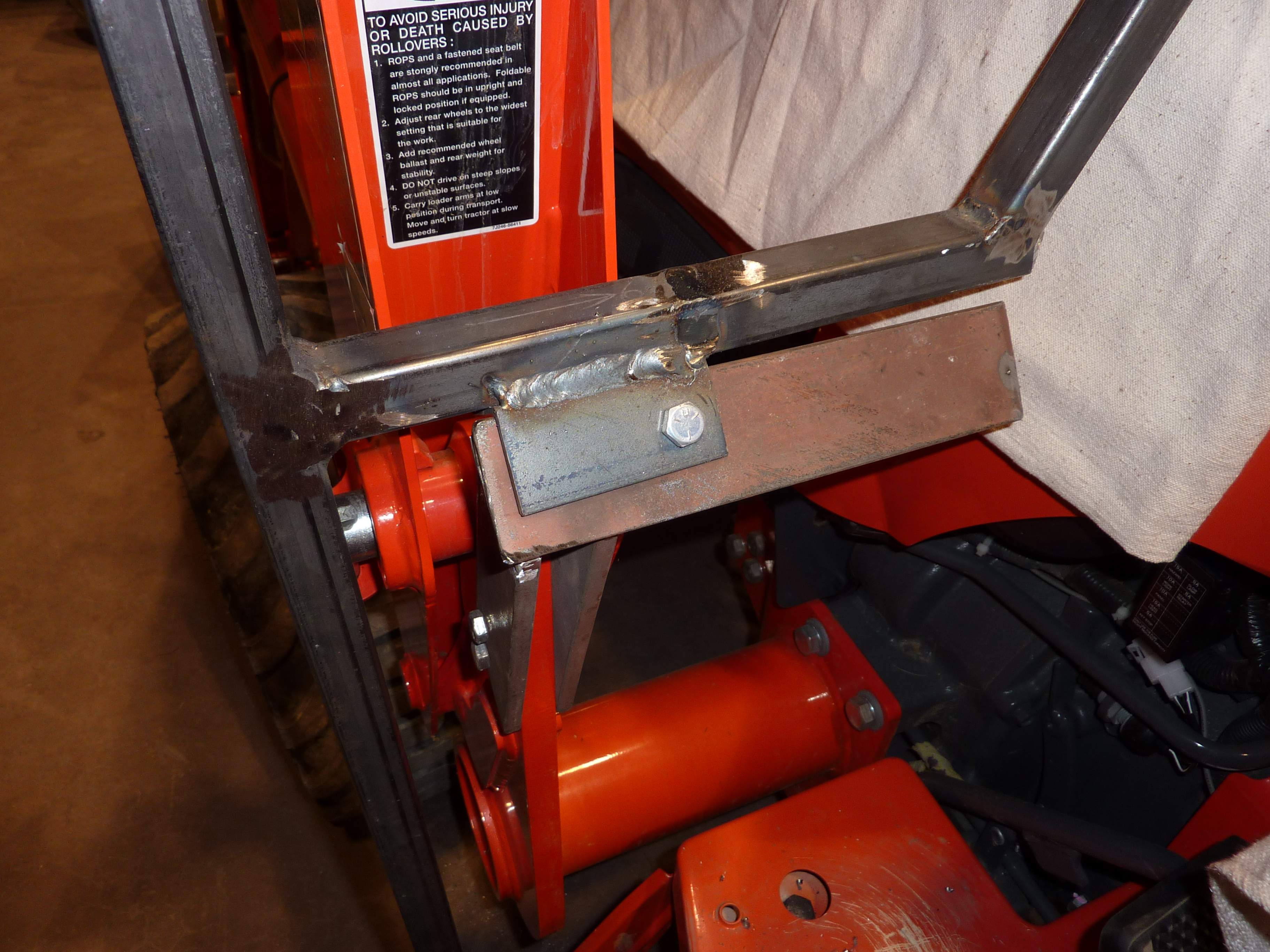

The modular design is roof and rear as a piece, front as a piece and each side as a piece. To start the build it seemed like a good idea to do the back and top. These had readily available anchor points. The ROPS will not fit (and neither will most factory-cabbed tractors) where this needs to go. The welded-on nuts were drilled out to 3/8" and nylock nuts were used.

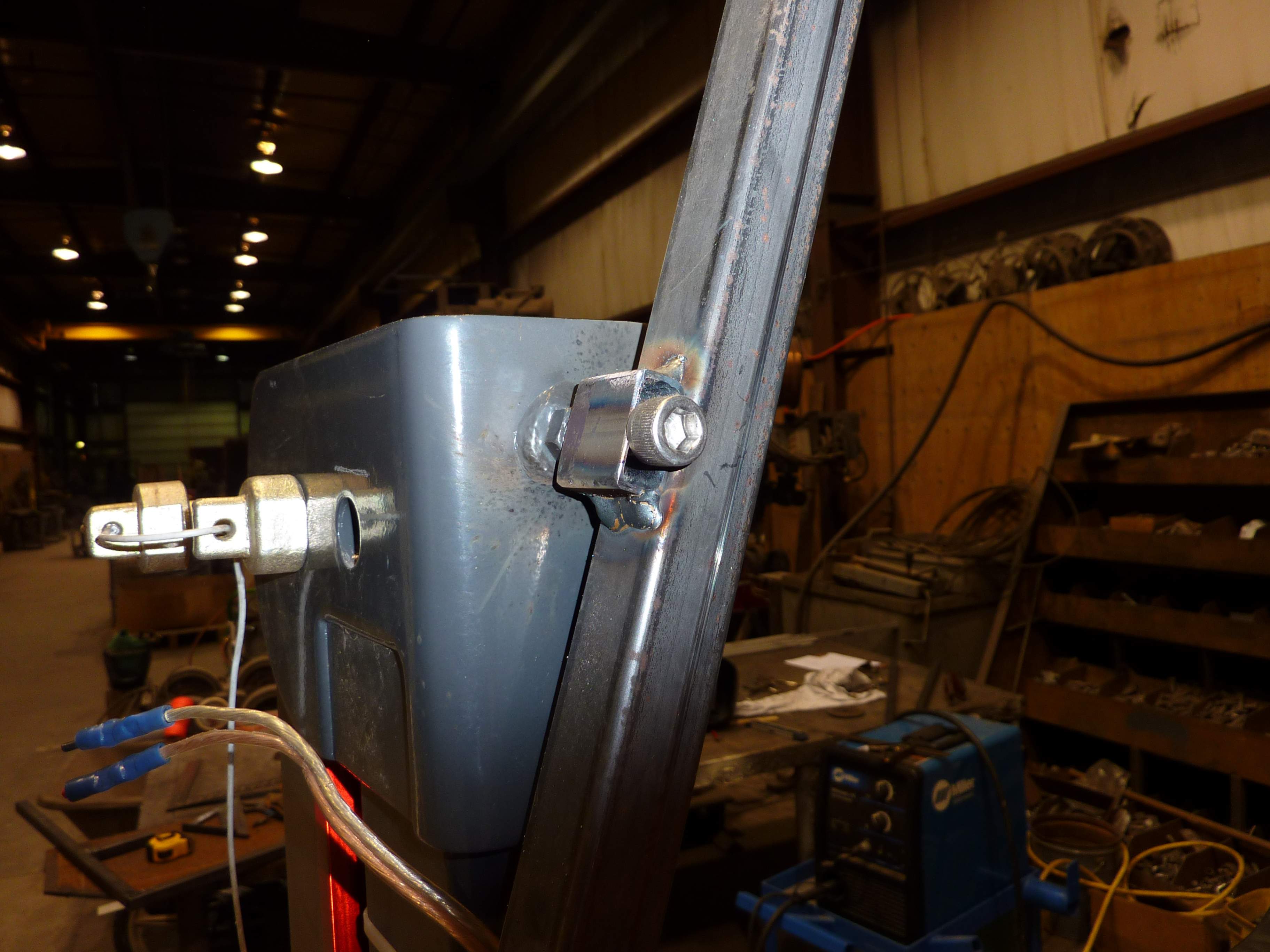

Since the back of the cab wanted to be in front of the ROPS, it eliminated the flashers in their factory position. The existing light holes worked for anchoring the bottom of the back wall. This rubber washers keep the frame clear of the fenders. I plan to weld a couple of blocks onto the back that will help bear the weight.

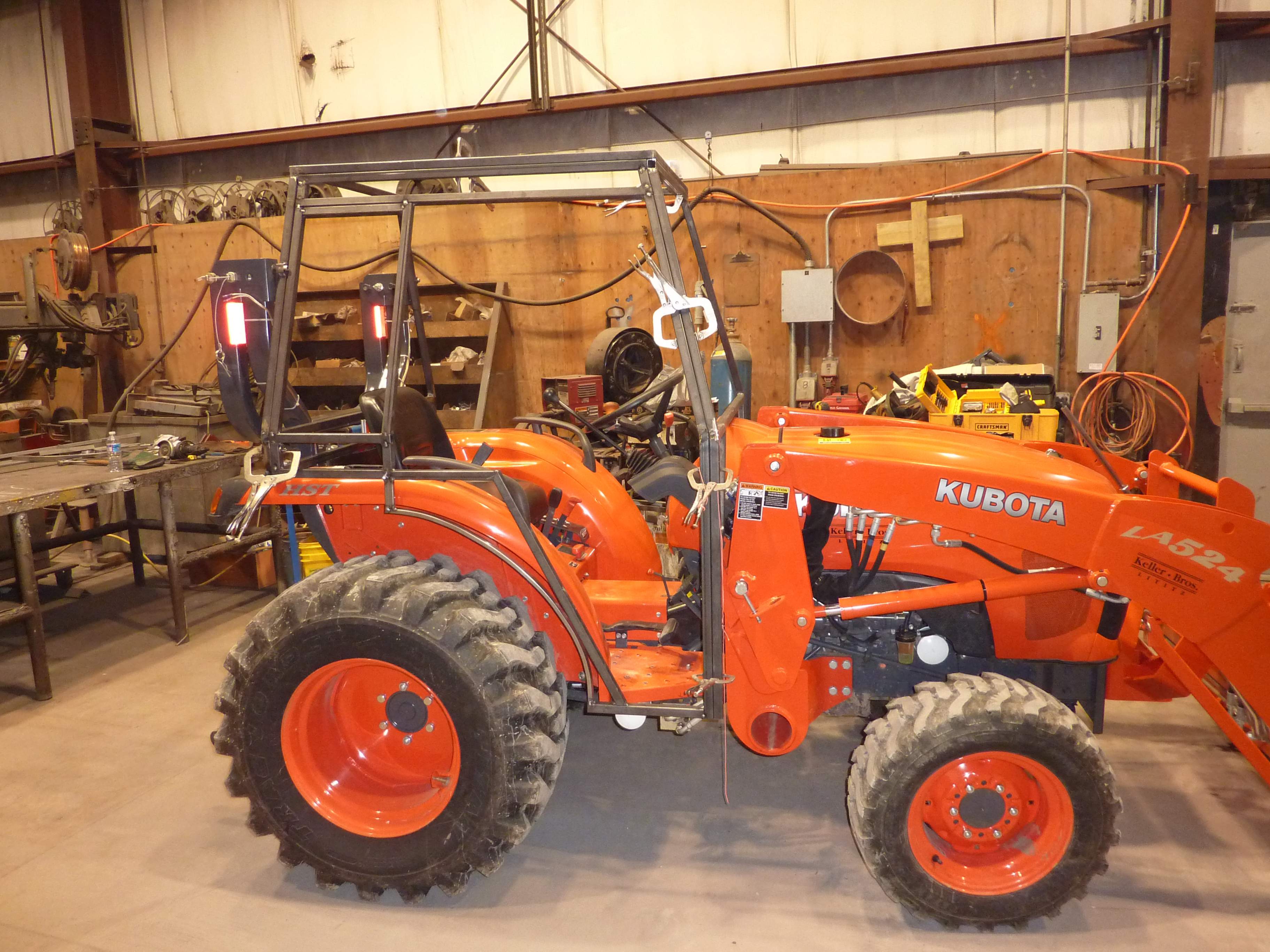

Here's where the project stood yesterday when I left. The rear /top framing was welded.

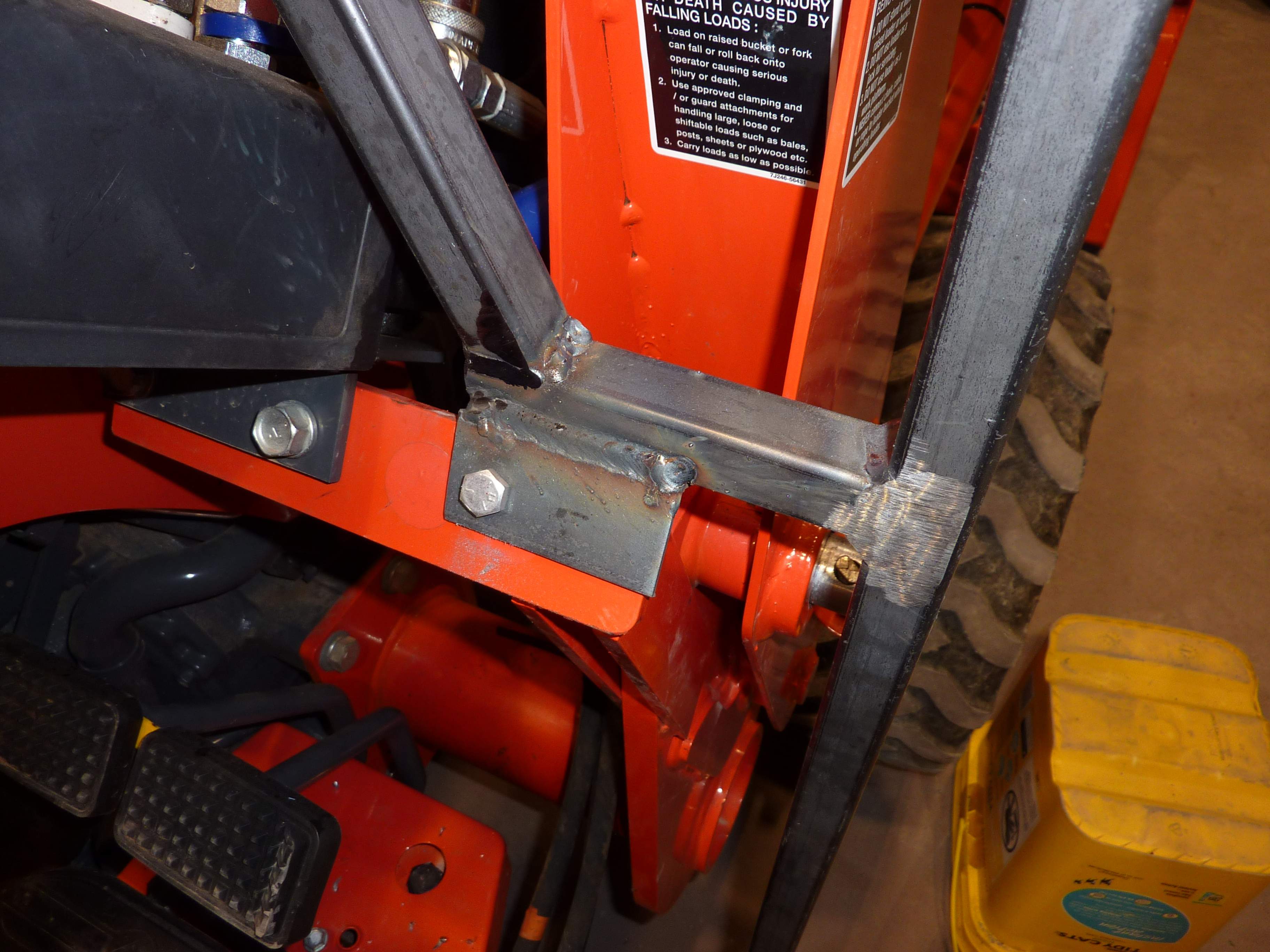

For anchoring the front wall, the heavy steel for the FEL stick looked like a winner. So I added a mirror-image bracket on the left side for support.

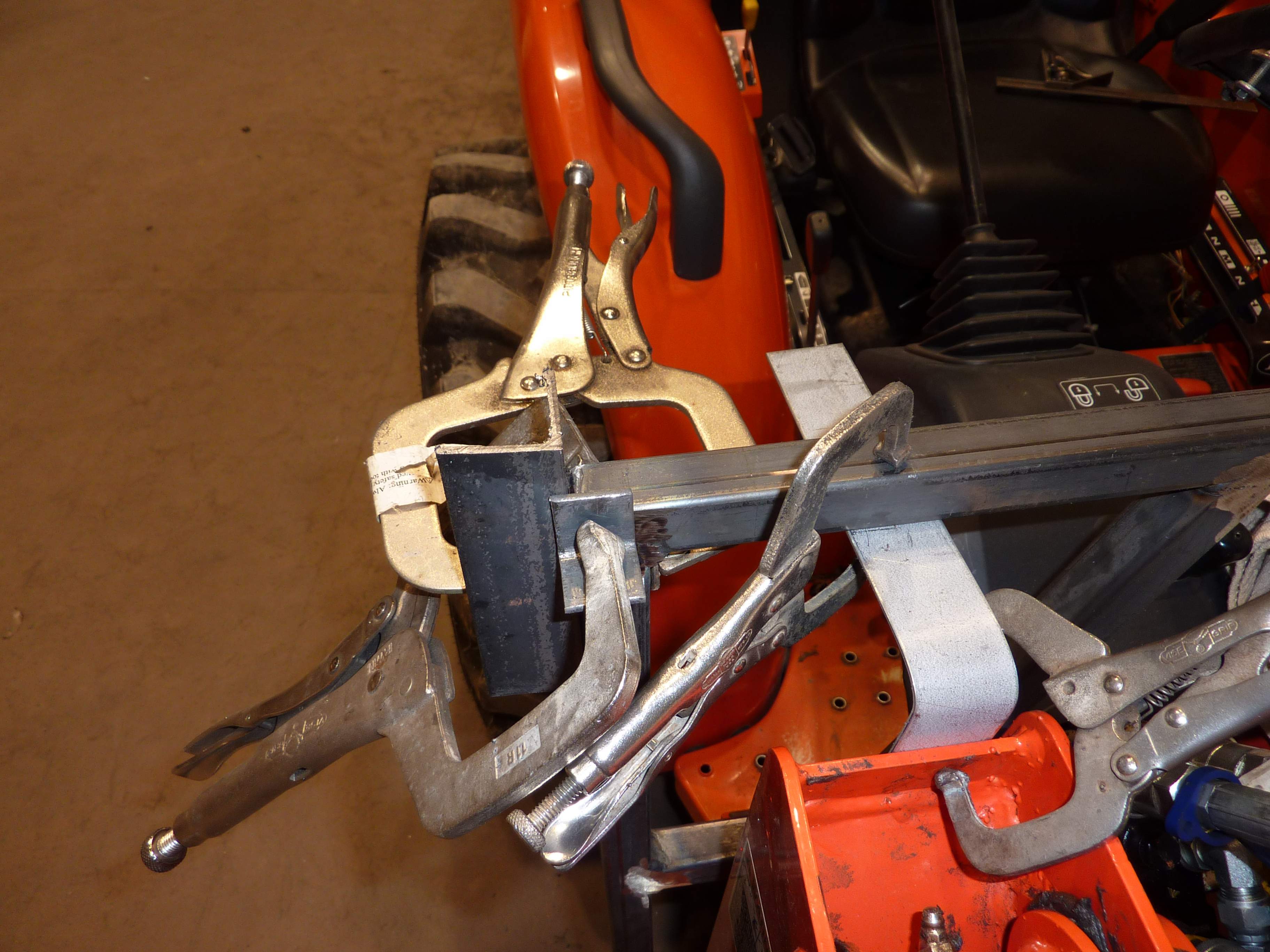

After a full day today, here's what it looks like. Whatever is clamped represents the different sections. The spaces where there are double bars will be filled with sheet metal. This includes the little box over the "HST" on the fender, the odd-shaped spot in front of the rear tire and the long narrow space at the top. Another tube will be added at the top (front and rear) to carry the metal all around the top at the same width. There will also be another at the base of the windshield.
It may be several days till there's any meaningful progress. Still thinking some of the door details through. Oh, but there is one last observation to share - you CAN'T have too many clamps!

Hyd - mec is serious saw material..... I would say one of the best. I have a new 1600 Ellis which for a private shop is a very quality piece. A 252 Miller MIG is also a good choice. With little practice will make you look like a pro.

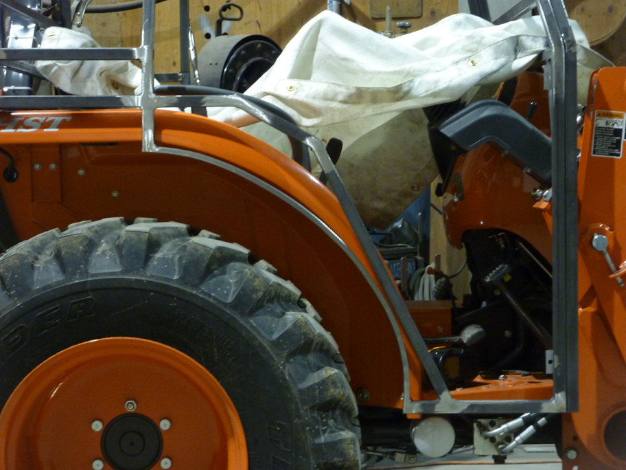

Your doing a great job with layout. Love the wheel arc openings... fancy ! If the cab extends past the fenders how are you going to fill the space between the fender and the steel structure ? Your post proves one does not have to be a professional metals person to construct a cab.

Thanks guys. That saw is awesome. It has a hydraulic vise that grabs the material being cut with the flick of a lever. Another lever raises and lowers the saw.

As the fender curves down the gap increases quite a bit. For the curved part of the framing I used 1/2 x 1 steel tube because it seemed a better candidate for bending than the 1 x 1 the rest is made from. The 1/2 x 1 follows the curve of the fender closely enough I plan to fasten a strip of conveyor belt or similar material to the bottom of the 1/2 x 1. Sort of an ingrown fender flare. That would leave about 1/4" gap between the top of the rubber to the bottom edge of the fender. If it's too drafty maybe a few slices of a "memory foam" mattress topper we no longer use will help.
Things are being laid out to avoid contact between the cab and tractor as best I can. When the cab is removed in the spring the tractor shouldn't have rub marks and scratches.

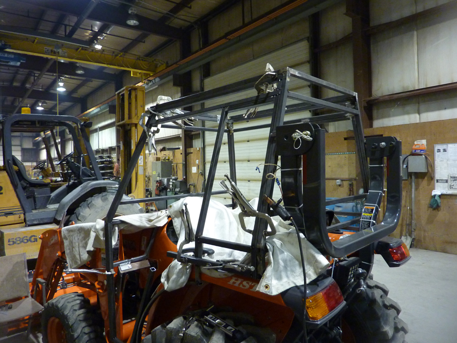

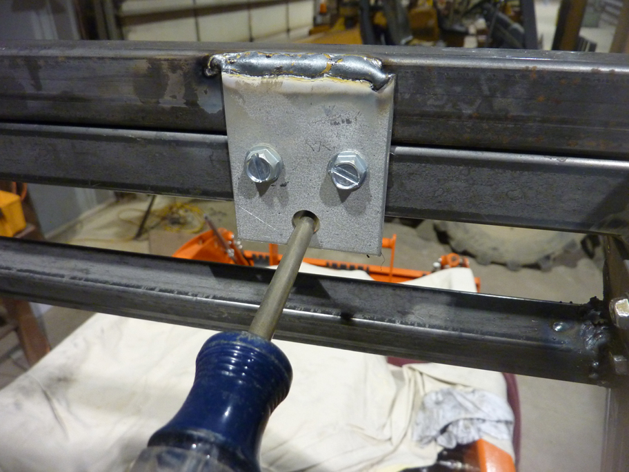

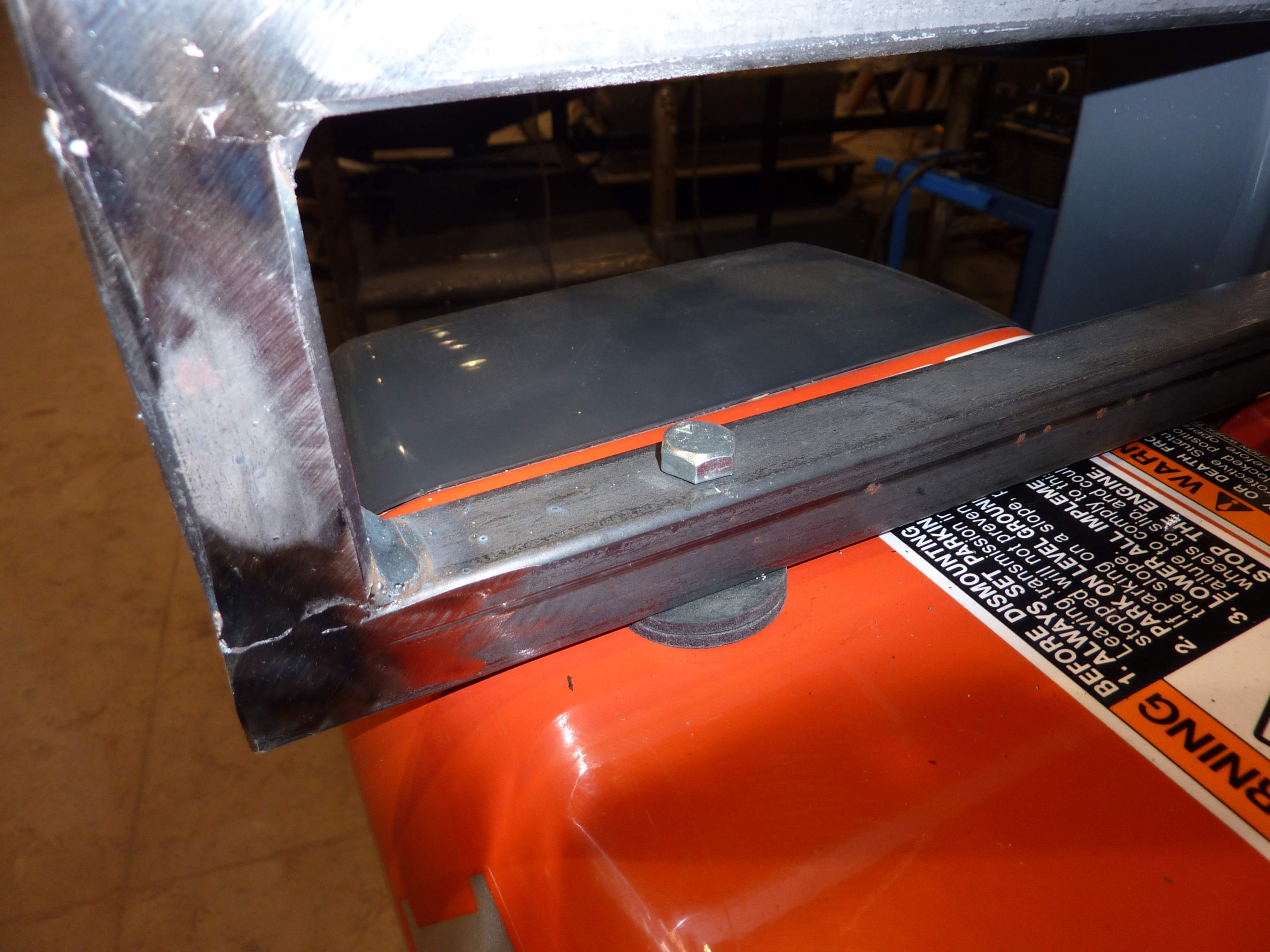

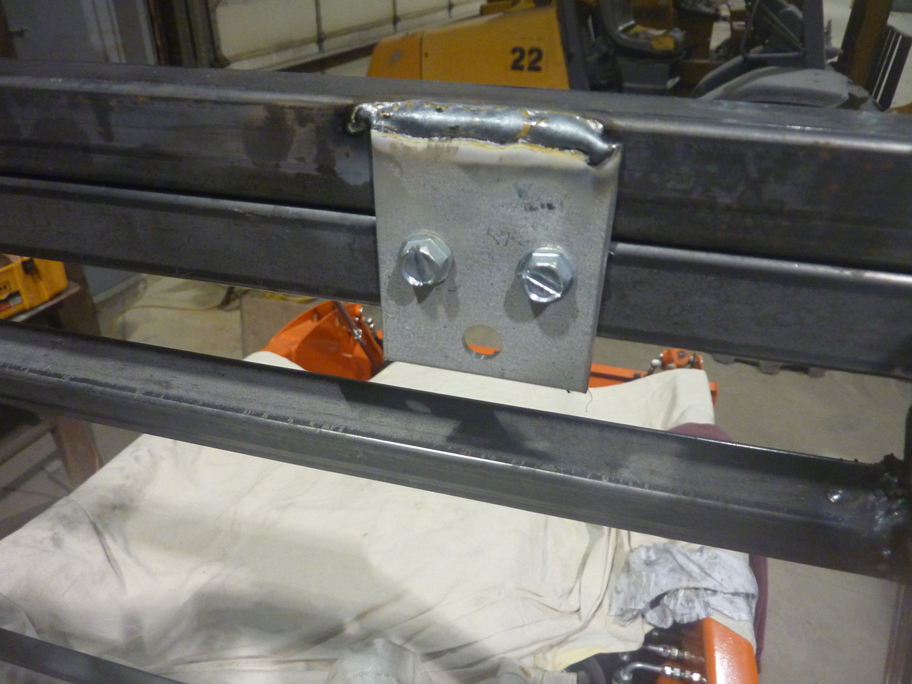

Got back at it today and made some serious headway. I started attaching the brackets that will hold the different sections of the cab together. The plan is to use a gasket between the sections. To help align the pieces and compress the gasket there's a pry hole in the tab.
Another of the photos is taken at a more straight-on angle of the right fender. A previous picture from a different angle made it look like the hand bent radius is a lot worse than it is.
Last shot is of the left side. Just a couple more pieces to frame around the door and then on to door frame fab and adding flanges for the glass.
