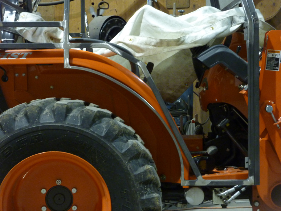

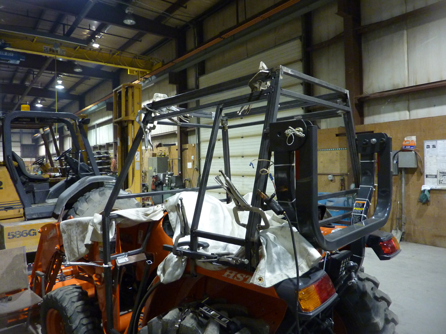

Had another productive day and got one door swinging (picture below). The goal is to paint on Friday. To answer a few questions that came up:
1. Yes it is made in sections. I posted a couple pics a day or so ago showing the connector plates I made up. They're installed with a weld on one side and bolts on the other.
2. The large pieces are the back / top together. Then there is the front section and two side sections.
3. When looking at the right side of the tractor the back/top section is made like an L rotated 90ー to the right. It attaches to the tractor via exiesting holes. The "lollipop" blinker holes were in just the right spot. It's also bolted through the (10mm?) welded-on nuts at the folding point of the ROPS.
3. The front bolts to the steel put there for the joystick on the right and a new matching (opposite hand) steel mount.
4. The cab fastens to the tractor at the six points described above. The lowest point of attachment is the joystick steel. The cab is quite sturdy even in its unfinished state. Today I was climbing the 1x1 steel tube on the right side to bolt up a connector on the far side. It was very solid and I'm no featherweight at 283#.
5. I'll check out those "brooms". At present nothing touches the painted body except a couple thick rubber washers where the lollipops were. I thought some rubber roofing would be good for blocking off the areas on either side of the hood.

Another great day of "Staycation". Finished tacking the left door frame today. I'm glad I did the right side first because of the learning curve. The door that will be used has the benefit of some experience. I wanted "suicide doors" but wasn't able to go that route because of the shape of the cab. It could have worked but the hinges would have looked really goofy.

Unfortunately, the project is behind schedule. After spending all day this past Saturday and getting some assistance from the "elves" things are turning around. All the strips have been welded in for the support of the glass. I dropped the patterns (cut from 1/4" luan underlayment) with the glass guy on the way home from work today. Here's where it stands as of today. The component pieces are reassembled into something resembling a cab. They had been disassembled for welding the window support strips, metal skin, etc. There are a couple small things remaining and then it will be disassembled again for painting. Should have paint done later in the week. I'm doing the frame and skin gray and the top orange. Picked up a couple cans of gray trunk paint for the inside.
Here's a shot looking at the rear:
