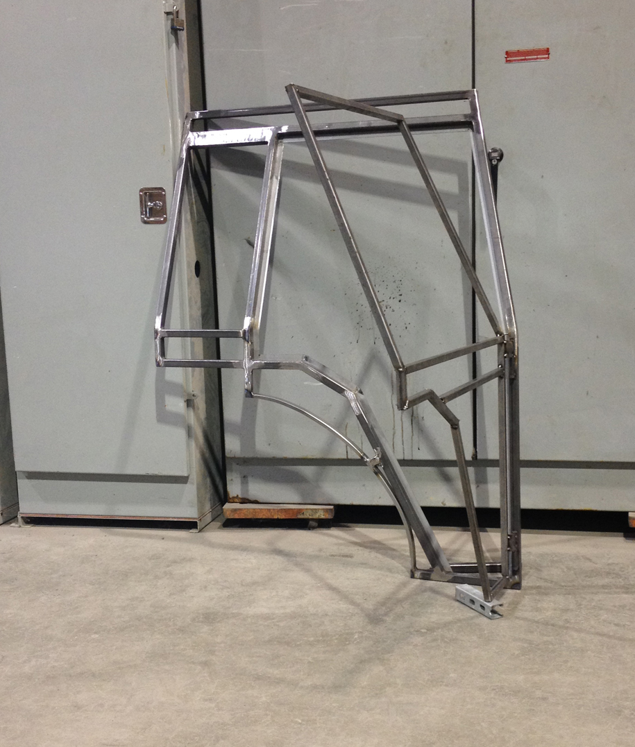

Had another productive day and got one door swinging (picture below). The goal is to paint on Friday. To answer a few questions that came up:
1. Yes it is made in sections. I posted a couple pics a day or so ago showing the connector plates I made up. They're installed with a weld on one side and bolts on the other.
2. The large pieces are the back / top together. Then there is the front section and two side sections.
3. When looking at the right side of the tractor the back/top section is made like an L rotated 90ー to the right. It attaches to the tractor via exiesting holes. The "lollipop" blinker holes were in just the right spot. It's also bolted through the (10mm?) welded-on nuts at the folding point of the ROPS.
3. The front bolts to the steel put there for the joystick on the right and a new matching (opposite hand) steel mount.
4. The cab fastens to the tractor at the six points described above. The lowest point of attachment is the joystick steel. The cab is quite sturdy even in its unfinished state. Today I was climbing the 1x1 steel tube on the right side to bolt up a connector on the far side. It was very solid and I'm no featherweight at 283#.
5. I'll check out those "brooms". At present nothing touches the painted body except a couple thick rubber washers where the lollipops were. I thought some rubber roofing would be good for blocking off the areas on either side of the hood.
