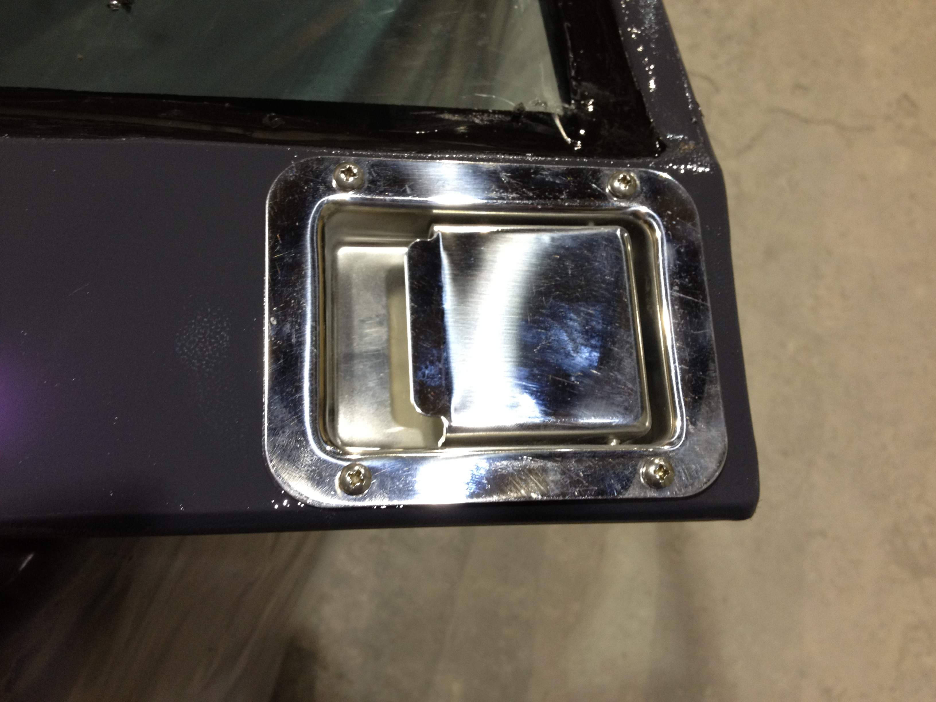

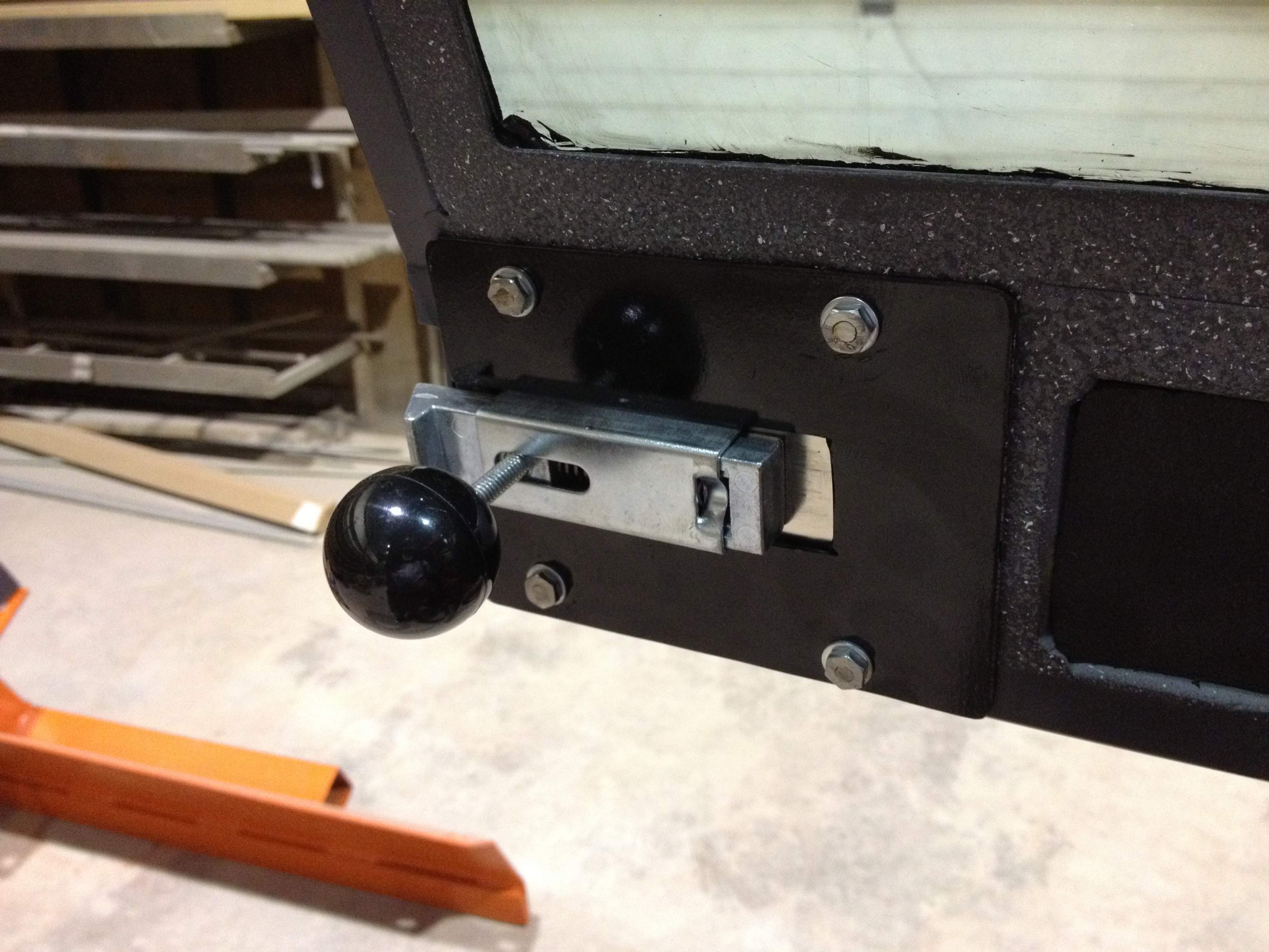

Cab looks great, what an inspiration. I plan on doing something similar to my L48 Kubota.
Can you take some closer pictures of the outside door handles and also, how you attached to the floor? What about the areas behind the clutch and brake pedals, how did that turn out?
Thanks!!!
   / DIY Cab - Finally decided it was time
#129
Thank you. I'm getting ready to pour concrete tomorrow, so things could get a little busy tonight. I'll try to get the pics though.
The whole cab is supported at four points. As a matter of fact, there's a bit of new extended floor that is supported by the cab. The cab is a little wider than the fenders and the sides of the cab are parallel with each other. That adds a few inches of floor area at the front (a small triangle between bottom of the cab wall end existing floor).
I made up clips that take all the weight. Two are bearing on the folded ROPS (tractor won't fit some places w/ the ROPS up). I'm not familiar with the ROPS on your tractor, but there should be some place you can get a solid connection to the ROPS or its mounting hardware.
The front is supported by short pieces of angle that go down over the FEL joystick support on the right, and a matching support I made for the left side. There are no other supports and it is rock solid.
For the summer of 2013 I removed the cab. It didn't take long at all, but I missed the lighting that was attached to it when working after dark. This summer I only removed the doors. To get a breeze going I installed one of those 2 speed fans like our school bus driver had when I was a kid.
The area below the glass in the front is made of plastic strips that are used on large refrigerators they drive forklifts through. That worked OK, but I recently picked up a piece of Lexan in hope of cobbling up something better.
#130

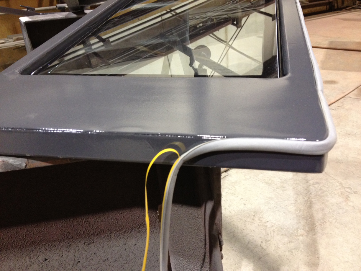

Weather forecast made me leery about pouring tomorrow, so I cancelled it and had plenty of time for a good meal and pictures. Support details are in the thread. Here are some closer shots of the inside and outside of the door handles. There are also pictures of the extra floor space. One with the cow mat flooring in place and the other with the mat lifted up to see the framing that is attached to the bottom of the cab frame.

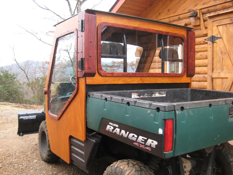

HI Folks,
I saw the DIY cab and wanted to show mine, though not a tractor.
   / DIY Cab - Finally decided it was time #132
Nice! Any more pictures?
   / DIY Cab - Finally decided it was time #133
Nice, don't have to worry about it rusting.:thumbsup:
   / DIY Cab - Finally decided it was time #135
Thanks, very nice.
   / DIY Cab - Finally decided it was time #136
Real nice cab, excellent instructions for building a similar one, and extremely helpful for those who want to be covered from inclement weather, which I must admit these days is quite appealing to me! Well done.
   / DIY Cab - Finally decided it was time #137
Ah-ha! Another woodworker!! Really nice, in any case!
   / DIY Cab - Finally decided it was time #139
HI Folks, I saw the DIY cab and wanted to show mine, though not a tractor. <img src="http://www.tractorbynet.com/forums/files/build-yourself/403819-diy-cab-finally-decided-time-doorandback-jpg"/>
That looks really good. I never even thought of a plywood cab, but I defiantly have the skill set to build one of those! Did you have a tread detailing the build?
