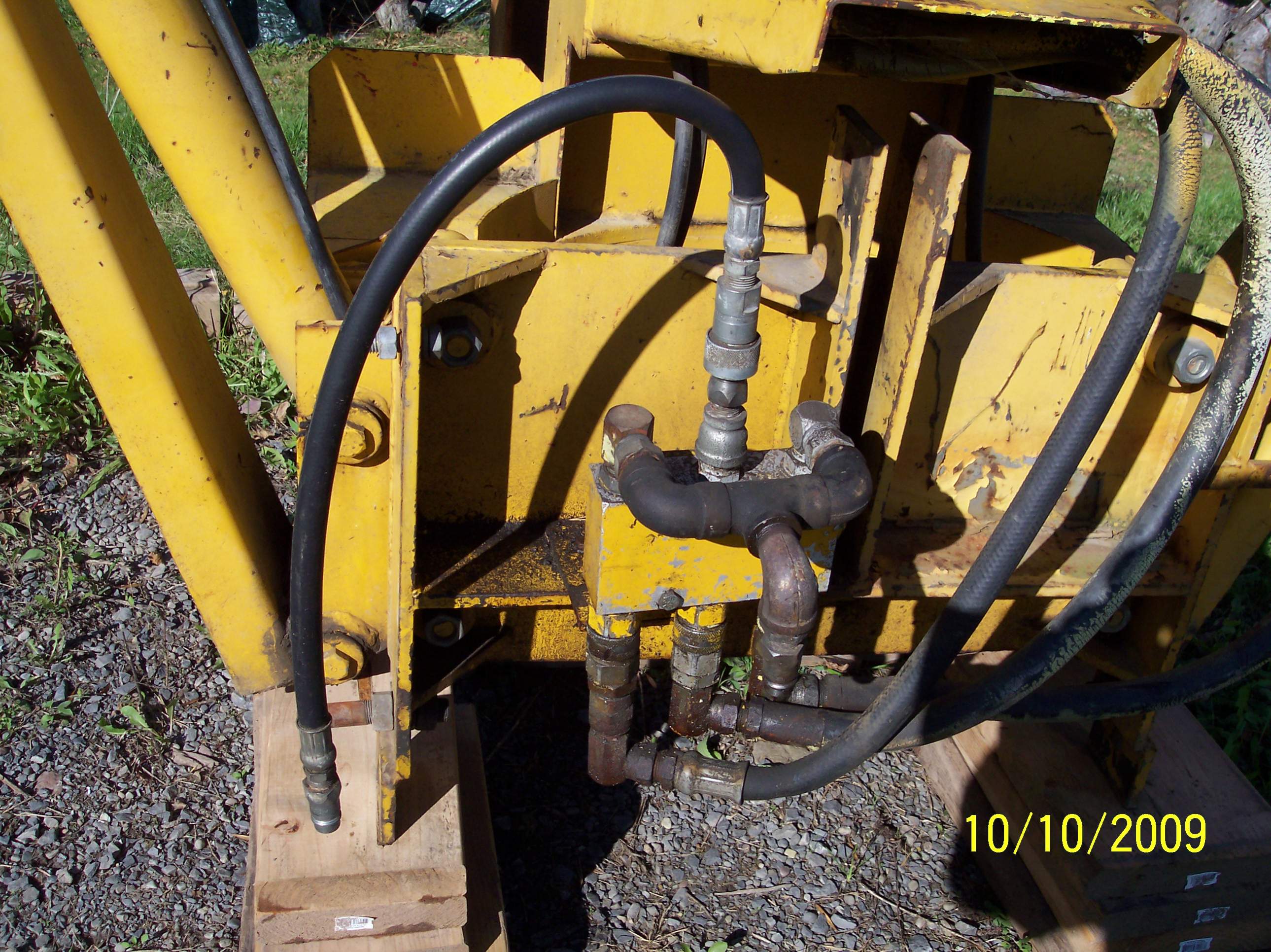

here is the photo of the supply and return ports,there are three hoses comming out of the bottom of the block ,there is a quick disconnect going to the two outside ports on the top of the block, and then the hose going to the center of the top of the block, Im stil unsure which is the supply and which is return. Any help would be great! thanks. J

If your sitting in the tractor seat there is one line going into the right side of the actual valve body and ther is two lines on the left. does this help at all?

Sorry John, I missed your picture before...
I am not sure why here are three hoses...there are usually just two. I would "assume" the single line is the feed but I am just guessing on that. I am also not sure of the purpose of the block at the rear either.

Thanks for trying, I was able to get a hold of ditch witch and they gave me the info I needed. The supply was the one in the middle on top and the other two that were tied together were return. I hooked it up and all is good. I was able to pick up a subframe not for my tractor but I can make it work with some modifications. Now I just need to see where the correct mounting points for the subframe are so I can not be scared about using the hoe. Does anyone have any pictures of their sub frame on JD 4310? Thanks to Kenny all. :)

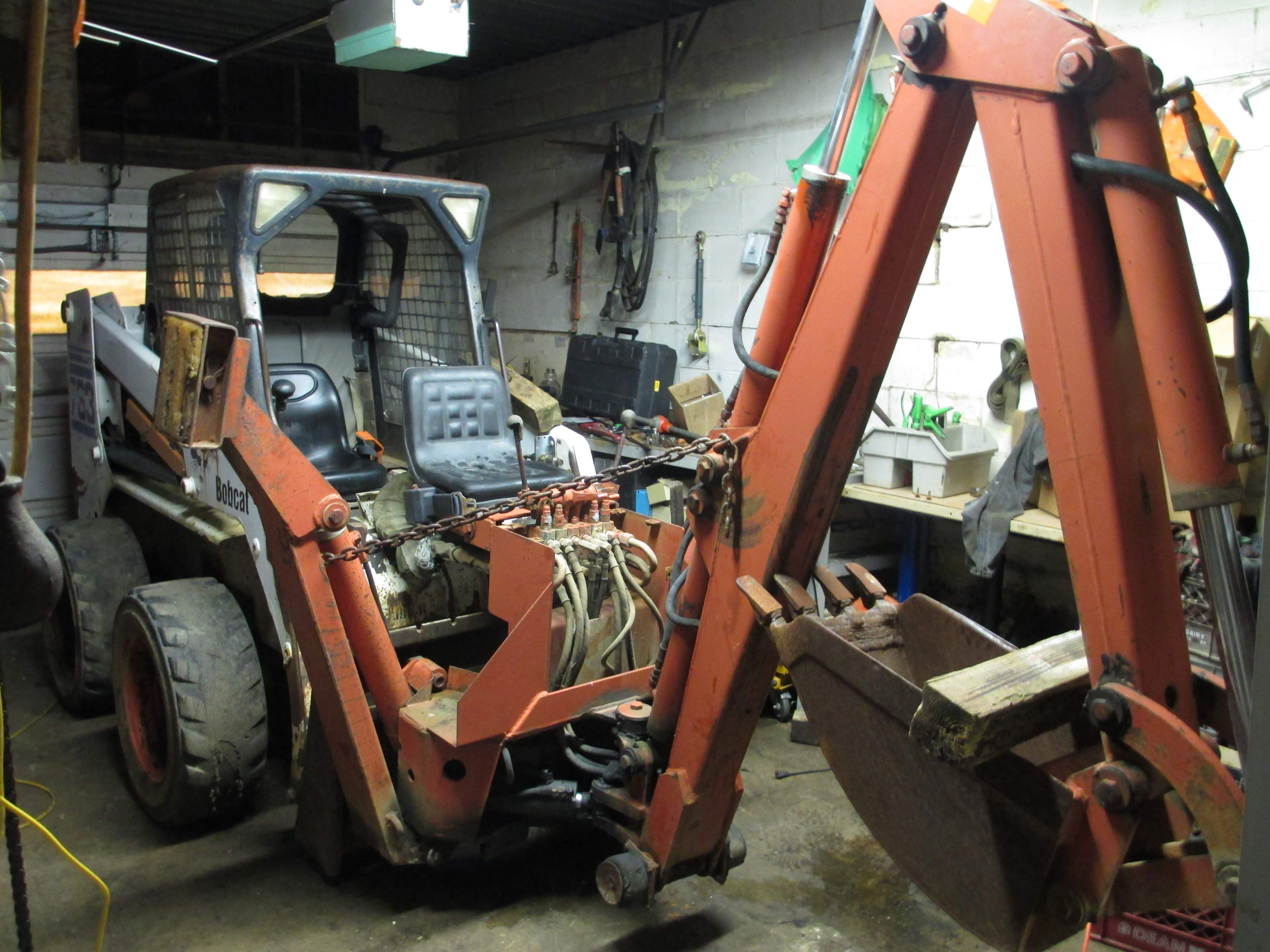

I have a Ditch Witch 140 Backhoe that I mounted to a Bobcat 763 Skid Steer.There are 3 Hoses coming off the Ditch Witch.I am guessing that 2 hoses are a return line and can be connected together however I am not sure what line is the pressure line and which are the returns.I have included a photo of the hydraulic manifold on the Ditch Witch.Also I do not know what is the high pressure connection on the Bobcat.Top or Bottom.
Thanks
