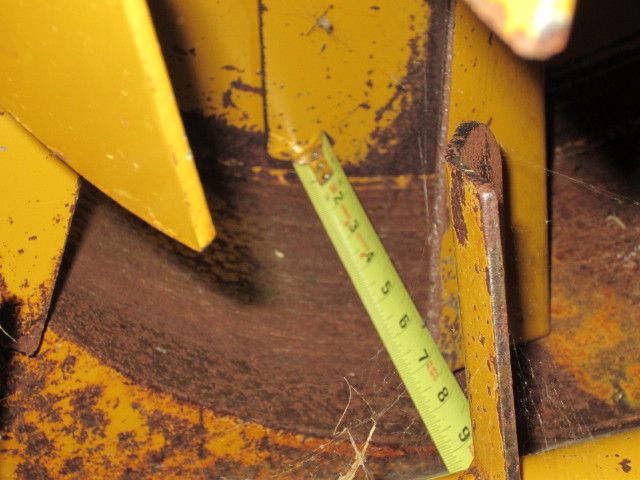

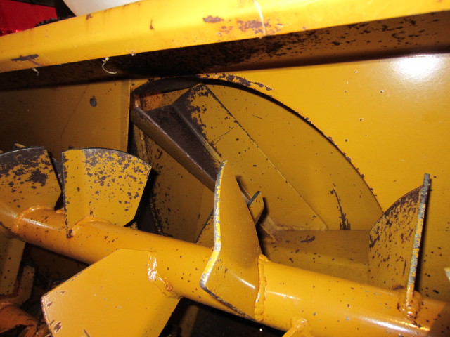

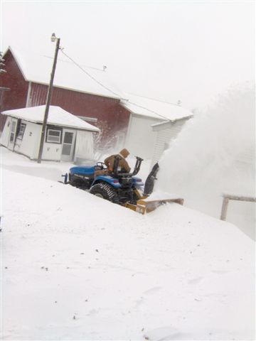

I had the throttle wide open and the tach needle was well past the 540 mark. It never came close to bogging down or slowing the engine even a little. It absolutely wasn't a hp issue. I felt it was a velocity problem. The distance did not change if I feed less snow into the blower. My dads little case 446 with a single stage blower easily tossed the same snowfall two to three times as far. I guess I was expecting it to do better. If I blew from the center of the driveway I couldn't blow it over the edge and would end up double blowing everything. I'll wax up the fan housing and spray her down with some silicone spray and add some rubber sweepers to ends of the fan then hopefully give everyone an update of how much better this performs. We'll see on the next snowfall, thanks for all the responses guys!
Something seems wrong. My little belt driven 4' Belco on the front of my LX280 lawn tractor throws 3x farther. Like others have said: Either fan is slipping because of broken shear bolt, gap between fan and housing is too big , or gearing is too slow. From the picture it almost looks like auger is slow too (i.e. not keeping up with feed). It would take 2 people, but wonder if someone with a 540 pto blower could tell you the gear ratio / fan speed of a good working blower. As in, 1 revolution of the pto shaft = x revolutions of the fan. I think a truer comparison of 2 blowers would also compare the fan tip speed, or the distance the tip travels on 1 pto revolution, where that distance = [3.14 (Pi) x Fan diameter). Thus, if fan diameter is 2 ft and 1 pto shaft revolution = 2 fan revolutions you can say that blower fan is 3.14 x2 ft x 2revs= 12.56 ft/PTO rev, then use this number to compare against another blower.

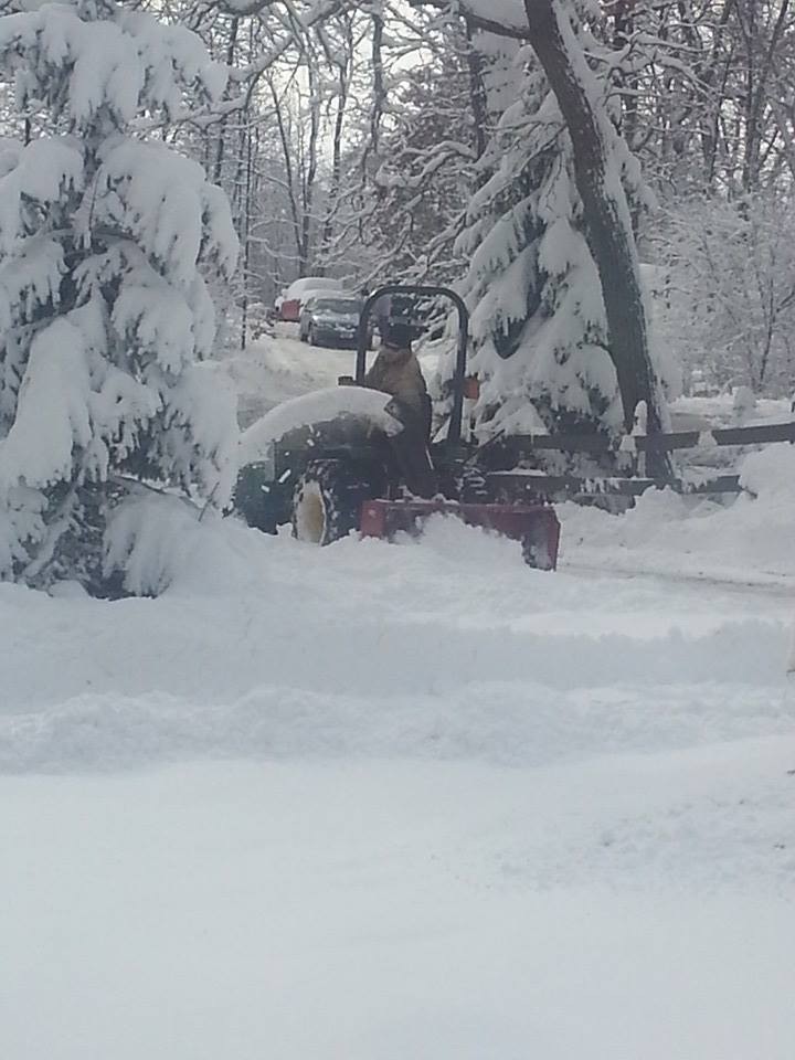

Found a pic the wifey took while I was out
Can you lift the deflector on the end of the chute any more? I was working on a Craftsman 11/30" last week and moving the tip of the deflector down 1/2" dropped my range from 15' to 5'
Looked like a smaller version of the snow coming out of your chute.

I dont see much wrong there with a heavy wet snow.
Wet being key.
Just count yourself lucky its not packed tight as sardines!
Im guessing, that its a RAD industries unit. Likely very close in design to my Kubota that is a RAD unit. What you have happening there is basically what happens with mine in very wet snow.
Advise is to run it a full engine RPMs. Also make sure the upper deflector is all the way up. You can also tighten up the fan to housing clearance to reduce any bypassing with rubber or UHMW plastic.
But in all honesty the RAD units arent great throwers. Adequate but not great. Even in dry snow it only throws maybe 25'. My Honda walk behind absolutely destroys it in distance and accuracy. I bet it throws close to 50' in the right snow conditions.
