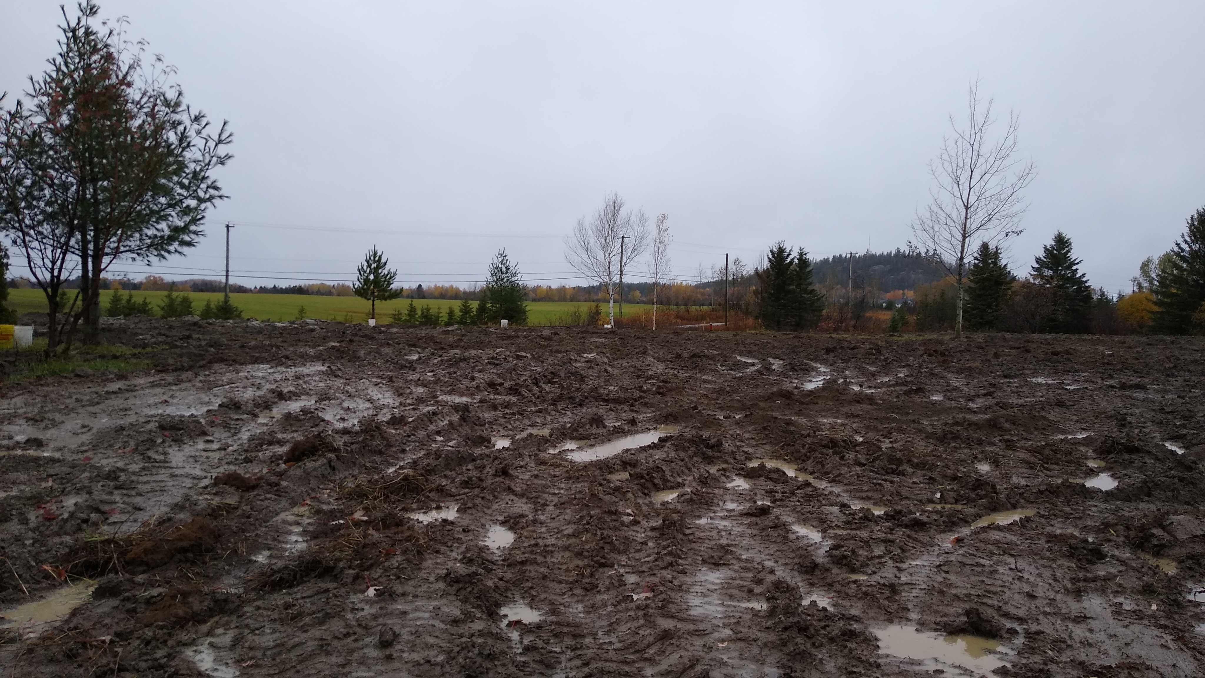

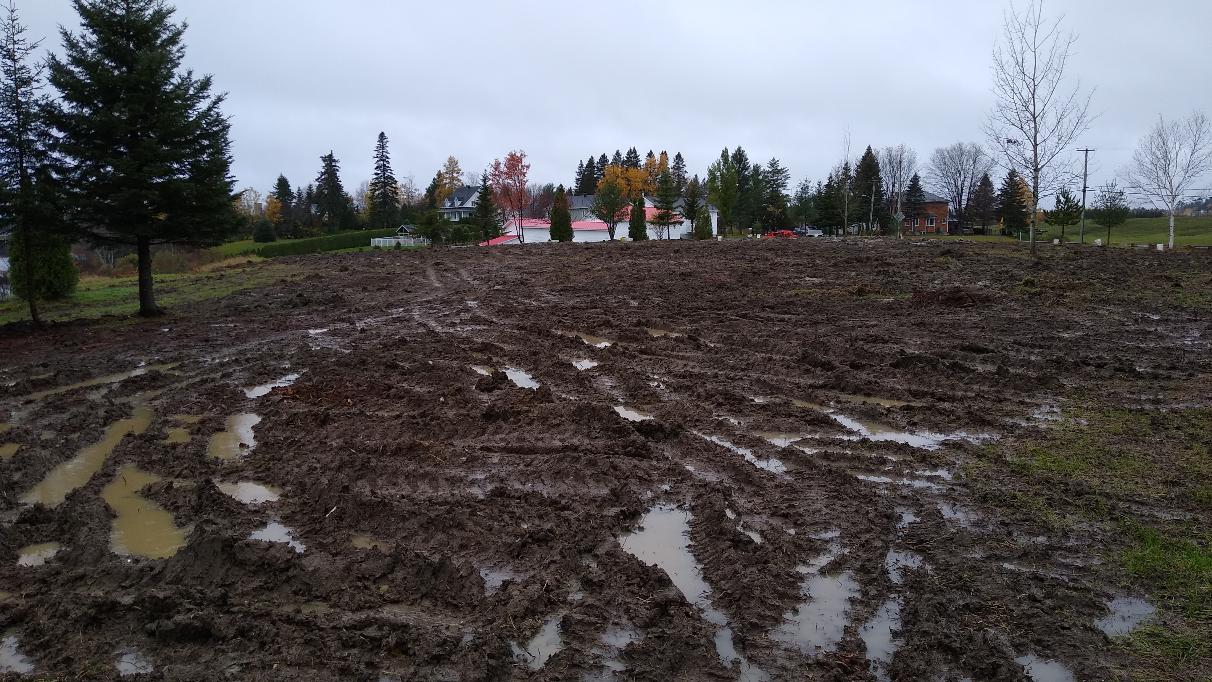

Now it is rainning all day long and winter is coming. Cannot work the lot anymore in full wet Clay as the wheels are spinning with attachment up, not able to move foward or reverse. will have wait next summer.View attachment 673778View attachment 673779

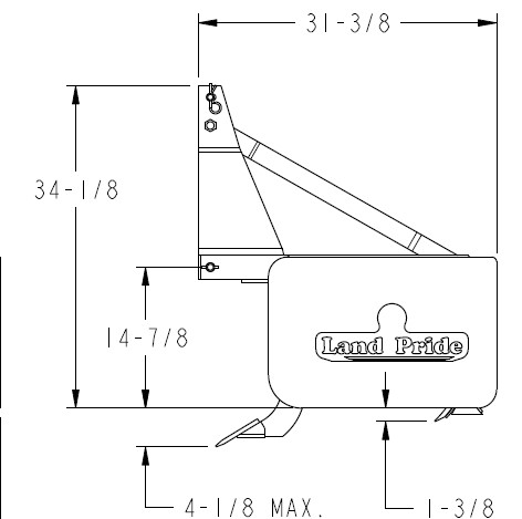

Hi Egon
It is very hard already to pull the Land Pride Box Blade BB2560 471 lbs behind my 3500lb tracter loader HST L2501 full throttle 4WD at low speed with only the Ripper , Shank , Scraper or Scarifier touching the ground being setup all way down and angled foward to prevent the cutting blade to touch down. It is a good thing that at last minute i changed my order from 66'' to 60'' box blade both with still 5 shanks on itView attachment 673771View attachment 673777
I had to weld the tips on 3 of them already as they came off by hitting the rock. So yes i could may be go deeper by tilting forward the box blade further to have the ripper go down more. I guess the more passes i go through the easier it will be for the Tractor as the ground would become looser. For now it is big chunk of solid grass with some small thin roots. But the more i go over the smaller they'll get.

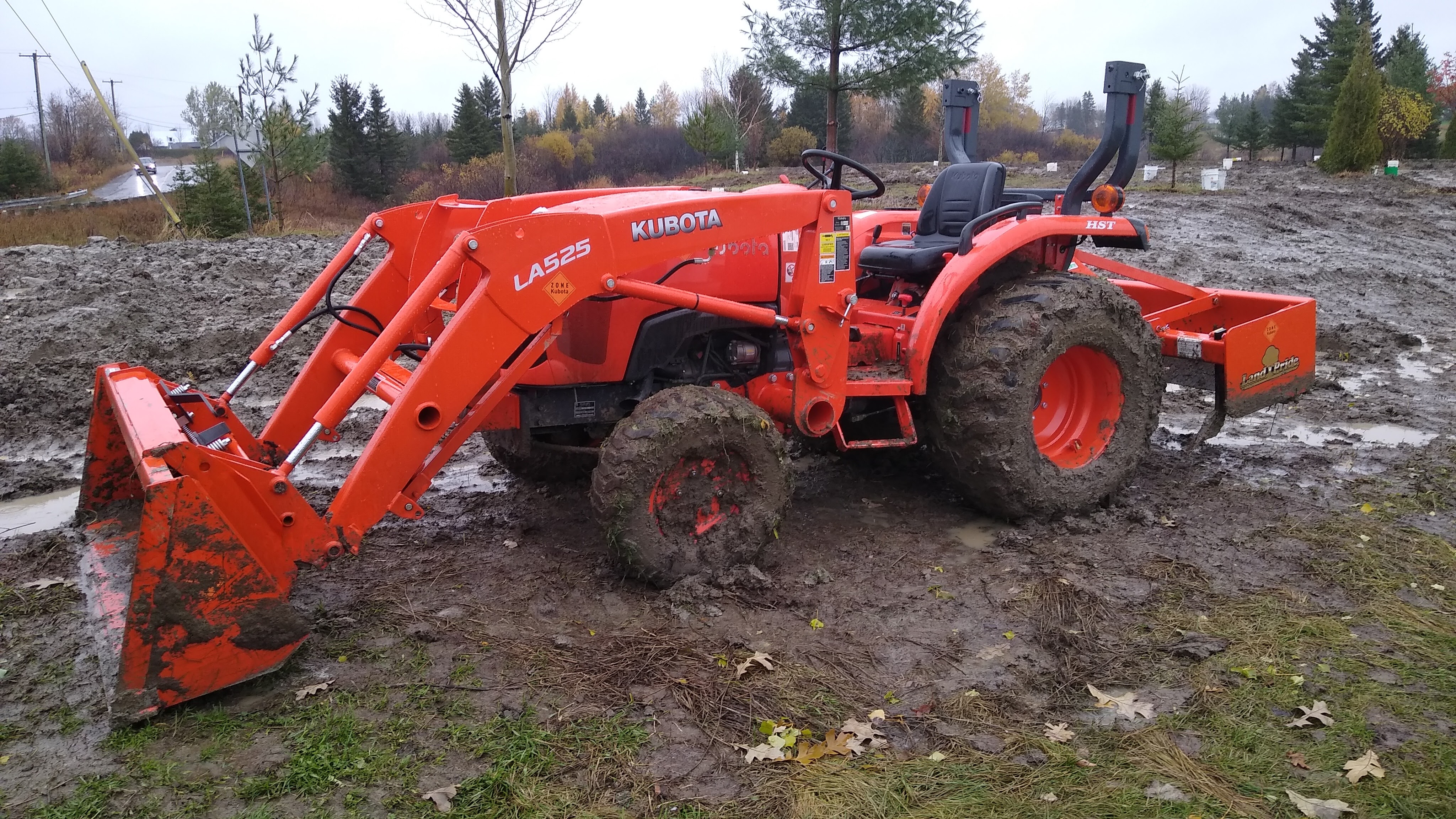

Start shallow and keep going deeper as you stated. Adjust the three point so the rippers want to dig in but limit the depth. This adds more downforce for better traction.

Clay ground shouldn't be worked when it is wet it will compact from being worked,
as such plant roots have a hard time growing in it.

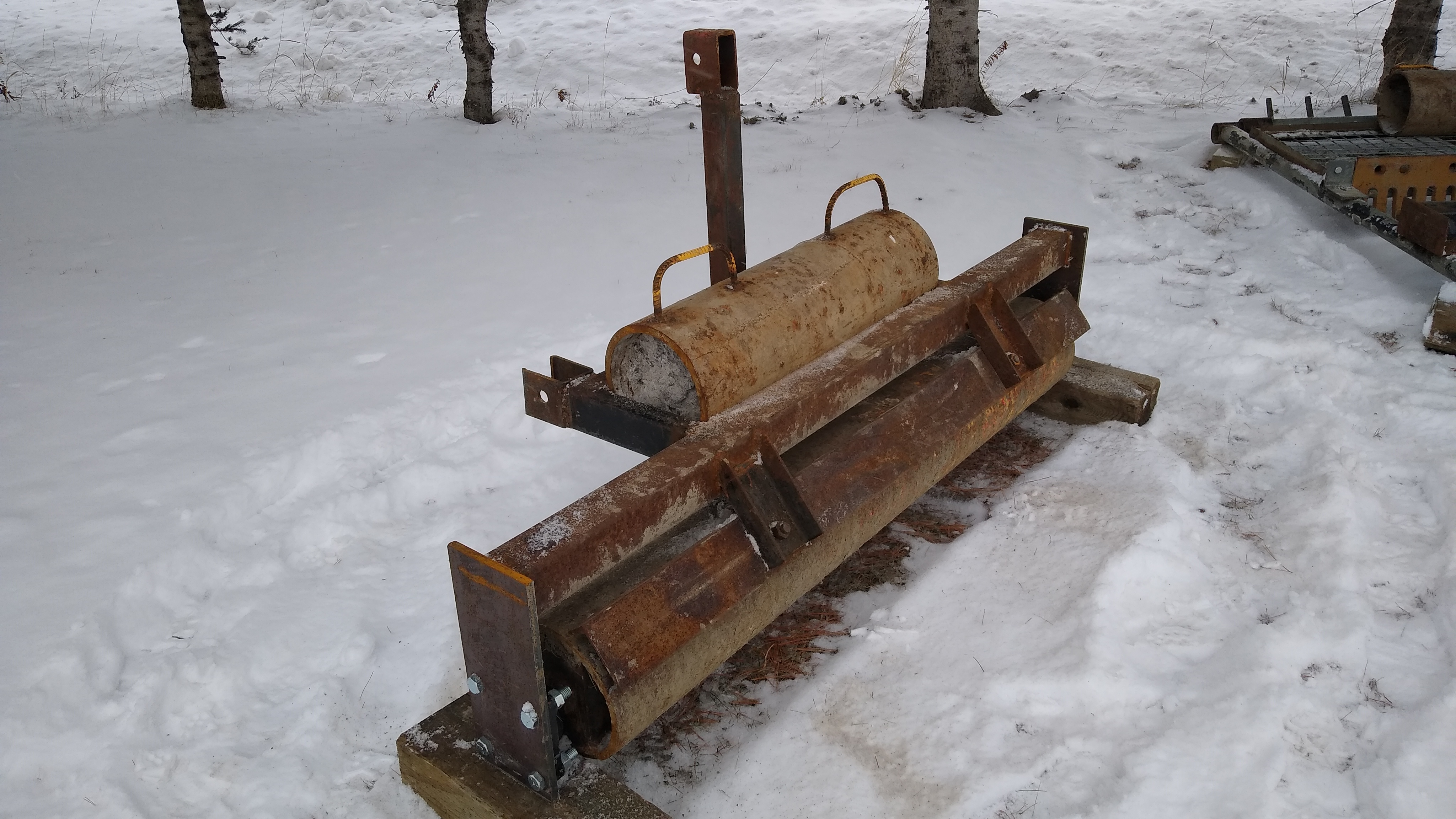

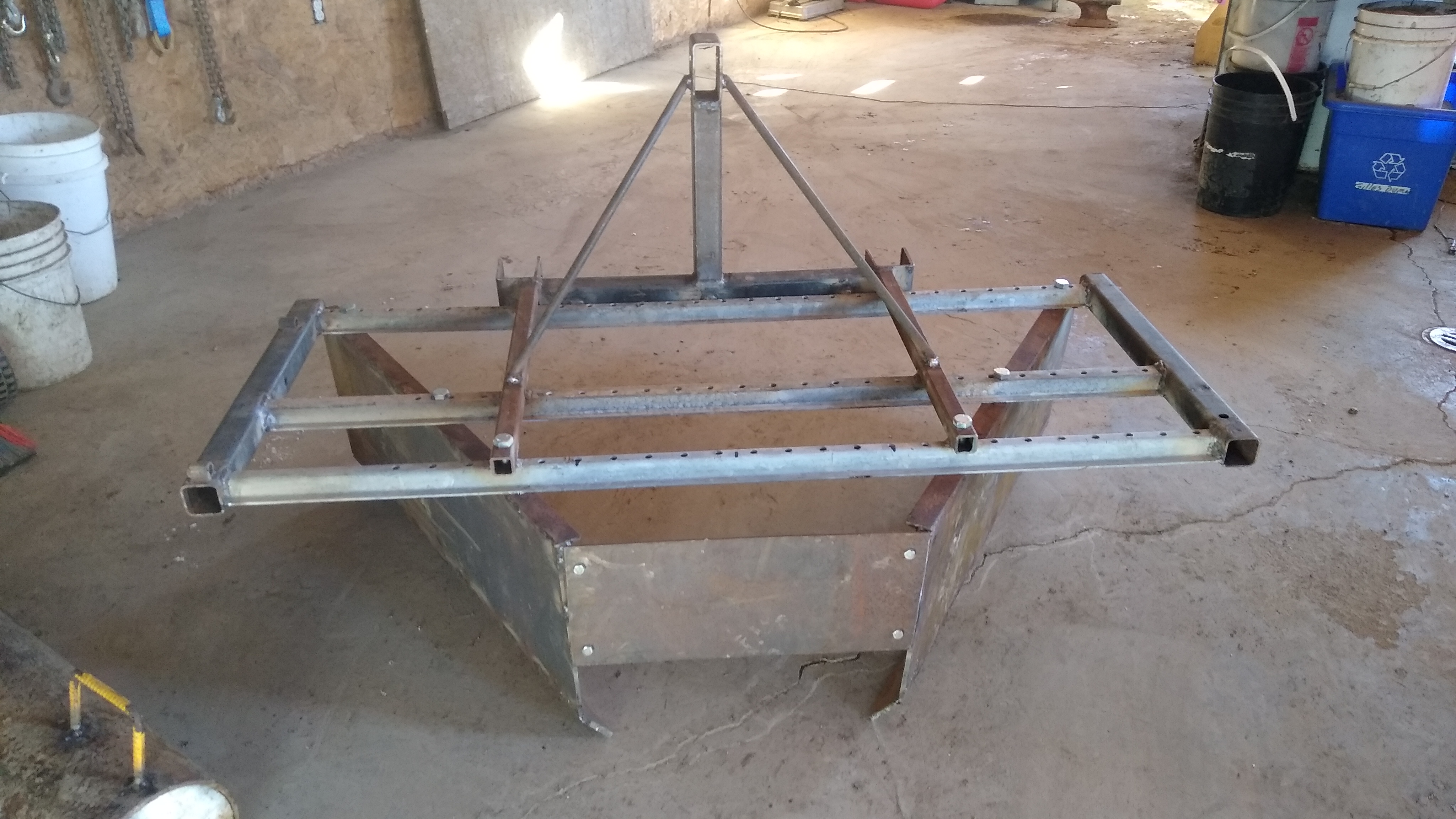

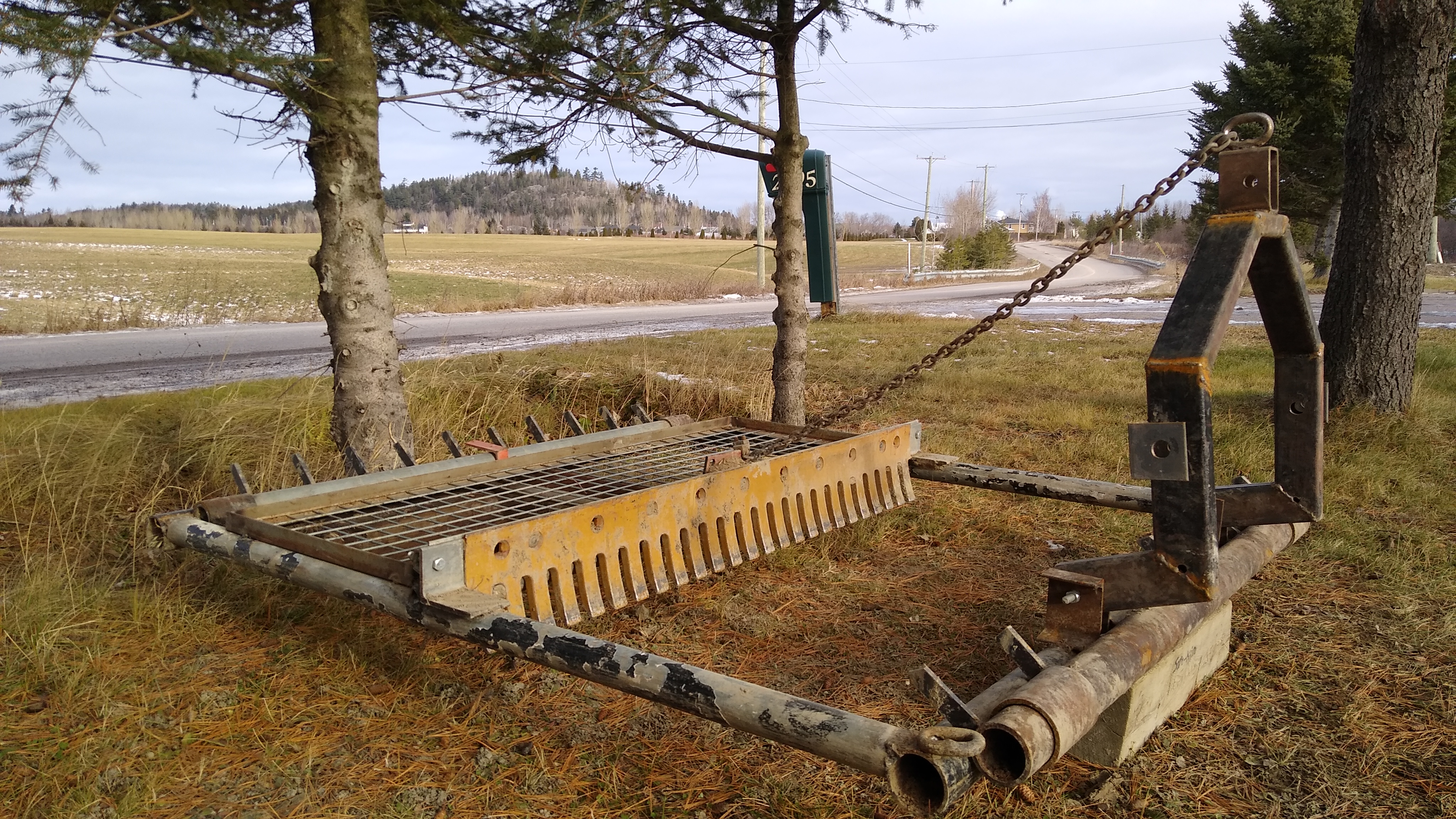

i got most of the rock out already with my homemade grader, i will seed then apply a Roller homemade again. build a garden 3000 sqaure foot and make the row with my homemade bed former that i made last week
