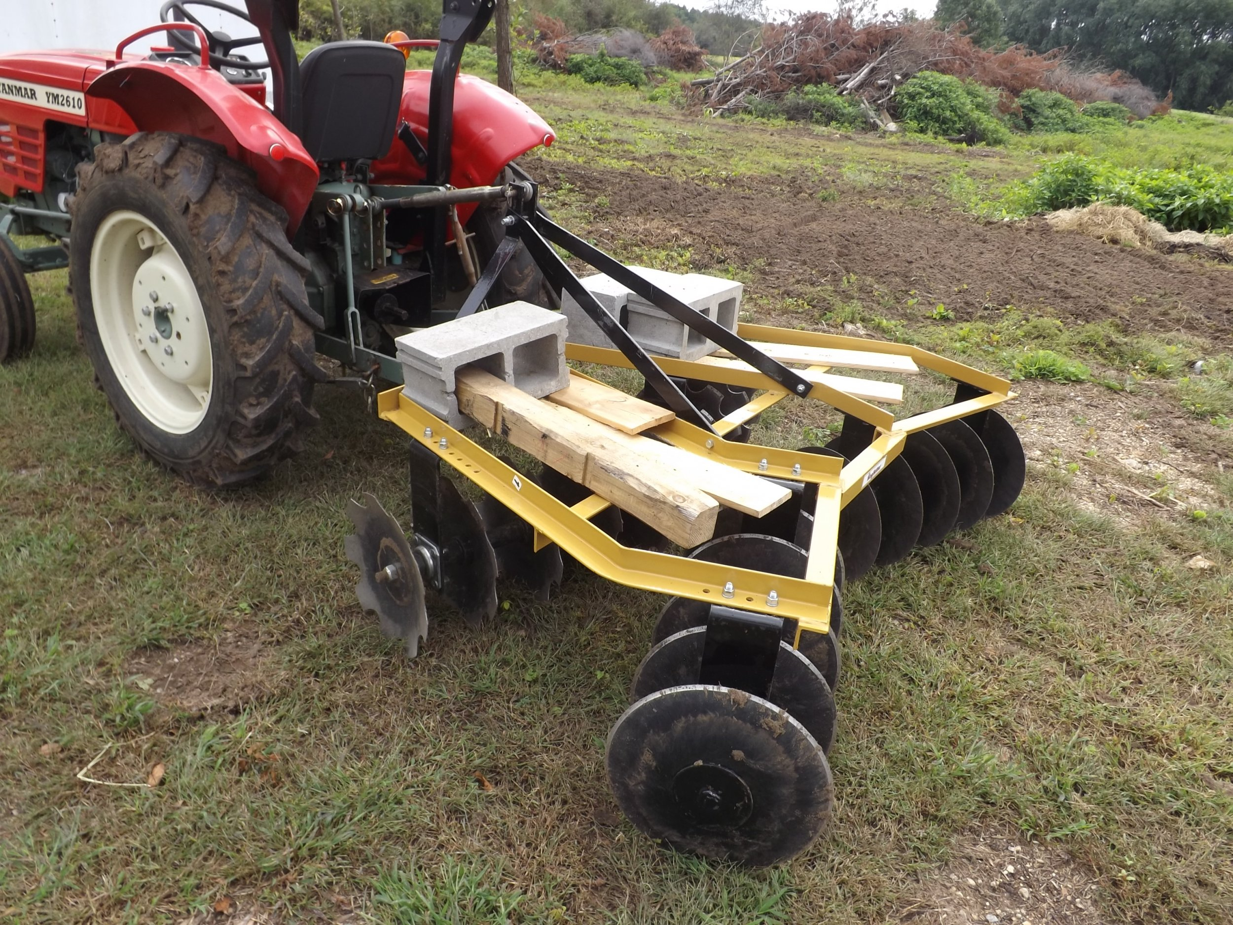

Got rocks or had the land cleared from trees then its a disc harrow with the front gangs as being notched.
I too wanted a PTO tiller, but the logger said, not for 5 to 7 years work of a disc harrow first and the roots to rot out and die off with keeping the pasture cut.
Also after a few years on your property with a disk harrow, you'll be able to mitigate the rocks out of any future garden plotting areas before buying a PTO tiller.
Nice you have the 1720 3-cly vs. the 1700 2-cly. Thus a PTO tiller is in your future. :)

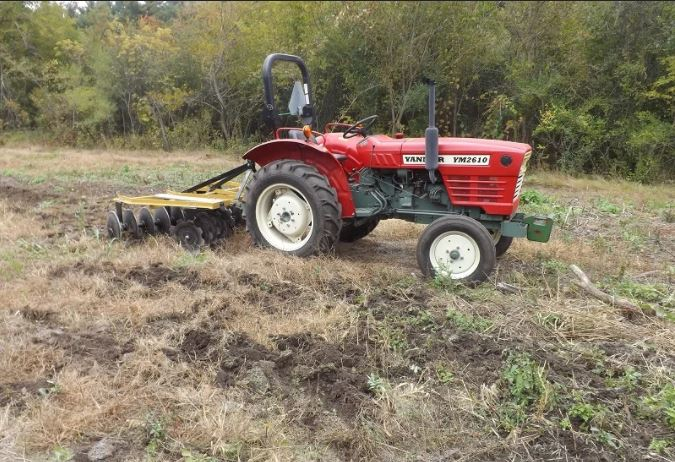

Here's the KK model listed in my sig. This is the first year after the major clearing.

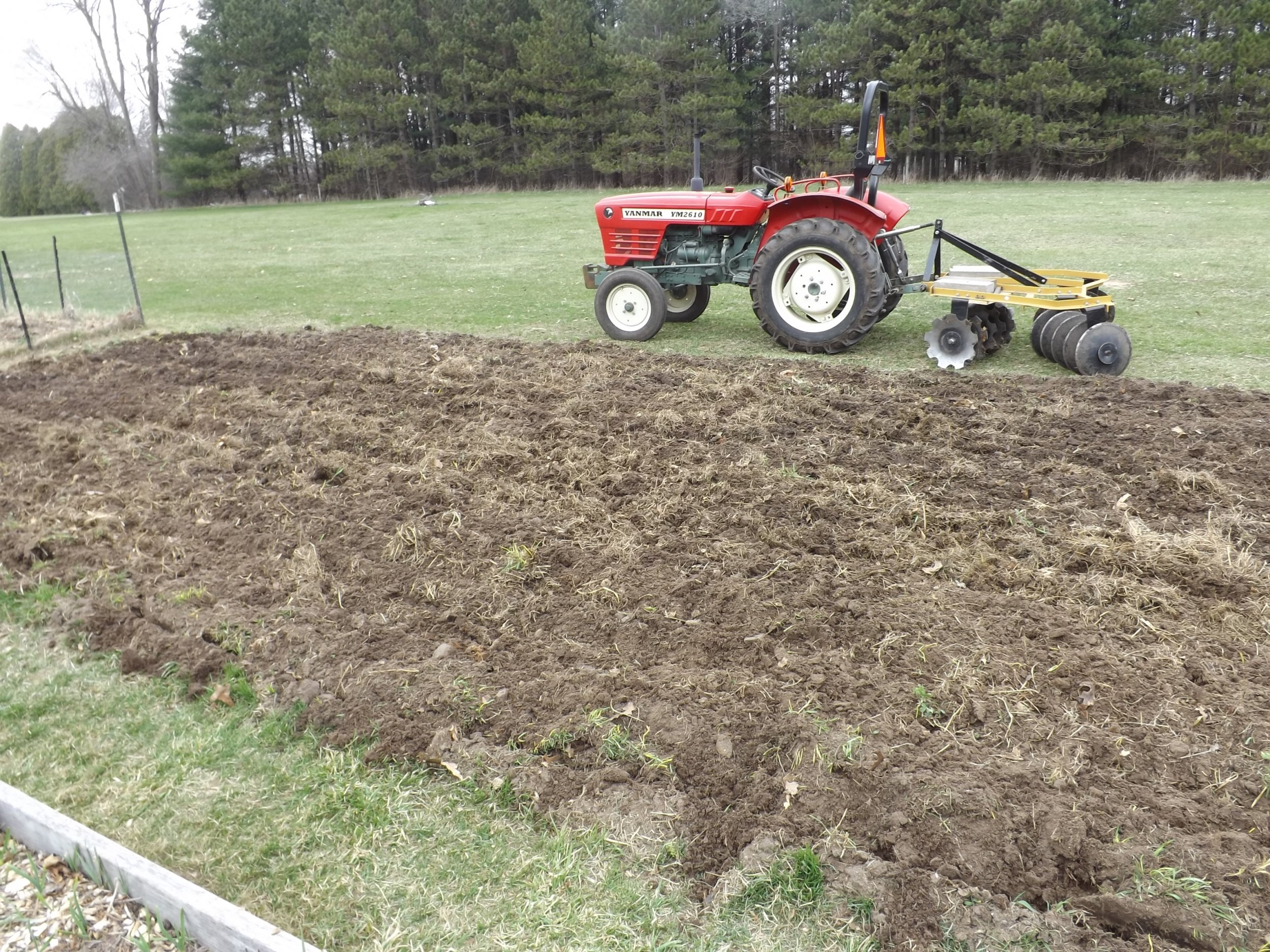

Here is the 2nd year.

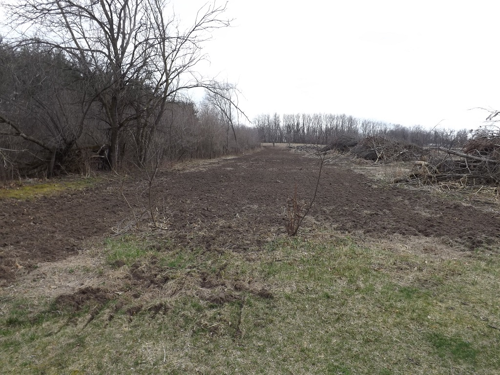

In the 3rd year things are looking GREAT!

Yep, that's why I had to disc harrow because the depth reached 8-inches. Amazing how old roots are still stubborn and all the snapping under the ground level. Good size rocks are kicked out and are now easy to pick up. With a FEL, with forward fingers, rocks are EZ to remove.
