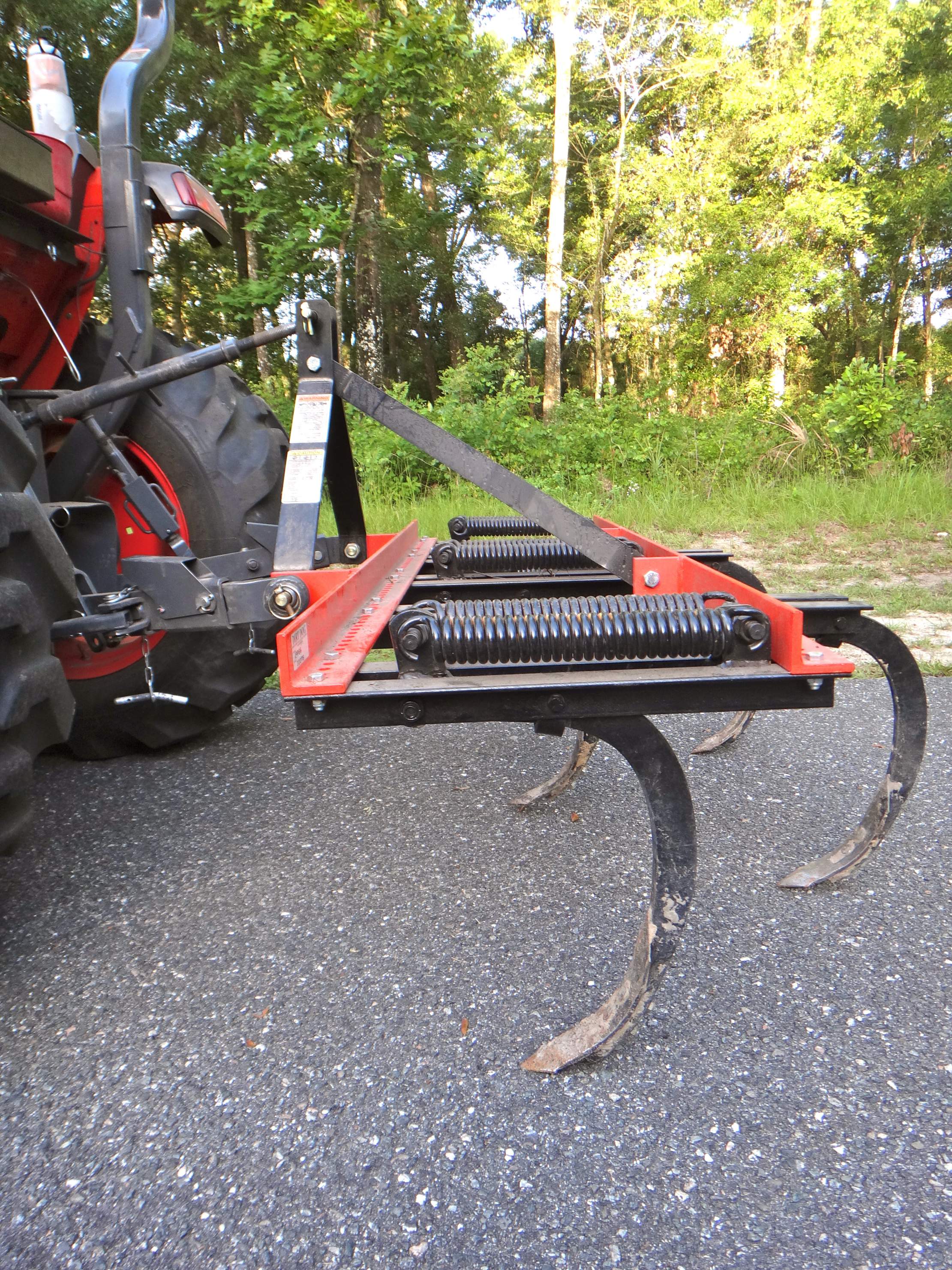

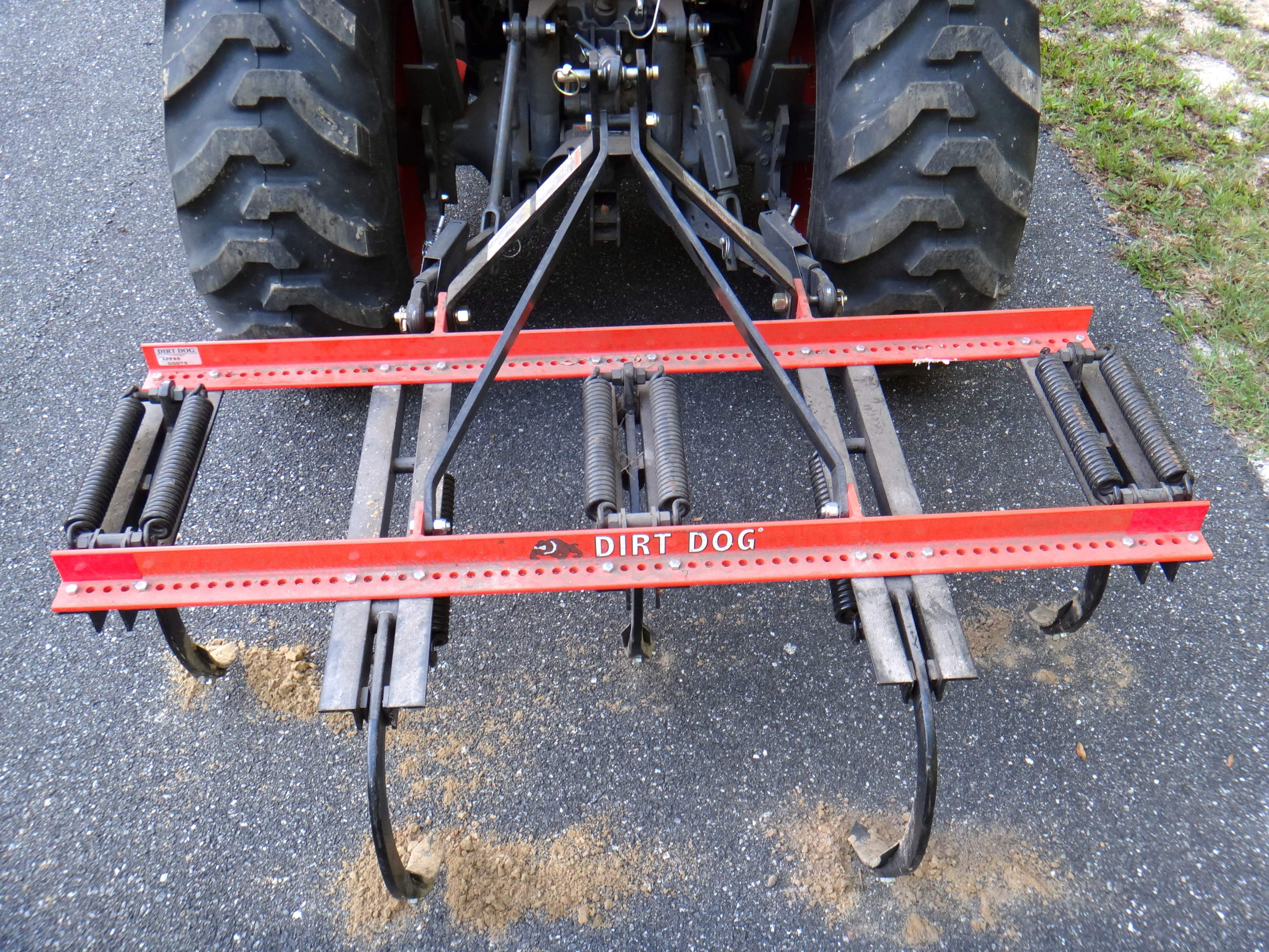

The Dirt Dog APP will penetrate 14" deep if your tractor can maintain traction, but spacing between the tines is wide.
(Photo #1 + #2)
