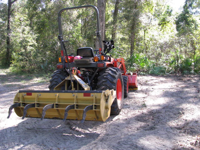

I have a Kioti CK3510. One of the things I liked about it was the relatively high weight (2700ish) for a relatively small tractor. Rear tire ballast helps further. The CK2610 seems like an excellent value tractor all around to me.
I have a field cultivator as well. Many of them are in essence to long pieces of angle iron with a 3-point frame and multiple individual shank sub-units attached. I found a very good deal on an old 7-foot, 9-shank cultivator. My tractor could not pull it, so I removed several of the shank sub-units. It works well with 5, but really penetrates deeply with 4. If you get a field cultivator it may be worth insuring that this customization if possible with it. I see old cultivators on Craigslist for a few hundred dollars frequently.
