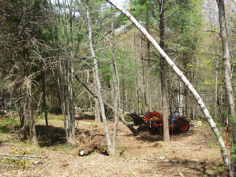

I can't comment on your soil of course, as it's different than what I have, however, I can assure you that a grapple will be able to loosen the soil much better than a bucket with teeth can. The grapple has all of it's force concentrated on just the teeth of the grapple, and the narrow tines of the bottom of the grapple, whereas with the bucket, your actually digging all the soil up, and using all that surface area of the bucket, making it much harder to dig.
There are many trees that I had to loosen the soil with before knocking them over, and I do believe that even with harder soil, and having to spend more time loosening the soil, it will still be faster and more efficient to use the grapple than it would be to setup with the backhoe, dig it up, knock the tree over, turn around, and grab the tree with the grapple. I do think you'll be impressed with what it can do.
The best way to figure this out of course, would be to buy both, and try both, and let us know what works better, but I am going to go out on a limb here and say that you'll end up using the grapple anyways (and of course I could be very wrong :laughing:)

oops, I don't know what I did, I meant to delete the pic, but I think I deleted the post? The picture I posted was from the thread I posted earlier, and he used the backhoe to loosen the roots first, not just the grapple.
Here is an example of what you can do with just the grapple alone.... (in my soil conditions of course)
