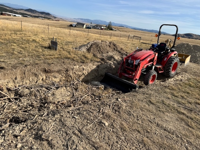

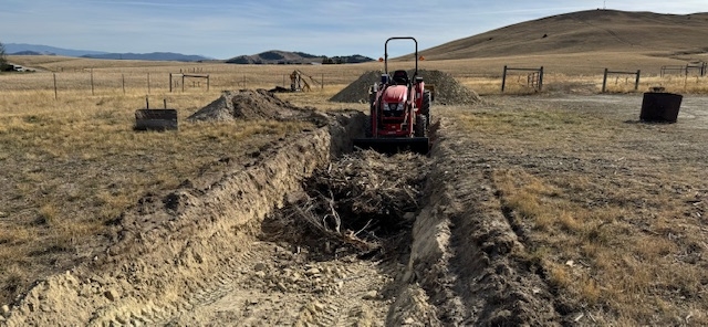

I did exactly that last summer as I had quite a few branches/stumps to dispose of… fortunately I had some help…
Our “soil” is predominantly shale with just enough dirt mixed in to call it soil…🙄
Used the rippers on the BB to dig, however, when the “scoop” part came along the bucket edge would catch on enough solid stuff it made me nervous as to what it was doing to the FEL…
I got the job done then seriously began thinking I needed some teeth… 95% of the tractor work I do on our property is maintenance… the majority of that work doesn’t involve digging anywhere as deep as last summer’s trench…
