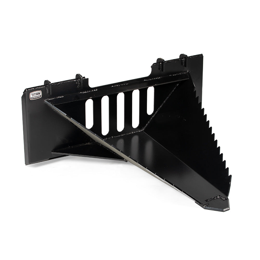

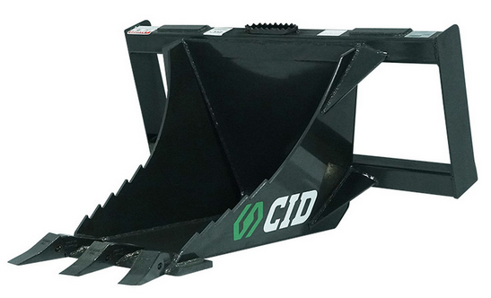

Many stump buckets are flared at the base. Try to find one that is straighter as it's better for trenching.
More like This type:
As opposed to this kind:
Last piece of advice is don't skimp on one of these.
They take a lot of abuse and subject to side, upward and downward force stresses in a more pounds per square inch way as opposed to a regular bucket where the forces are more spread out..
1/4" thick sides would be minimum from what Ive experienced.
Something like this would work nicely. Not too long but stoutly built:
