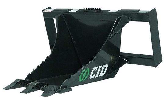

I'm planning to get a 1.5-2 ton mini excavator for a variety of projects around the property but can afford it just yet. This spring I want to bury some 4" gutter drain lines and build about 100' retaining wall along my driveway. I have no experience with an excavator so renting one probably wont be very productive while I learn how to operate it so thinking a $900 narrow stump bucket with teeth could be a good alternative for my Branson 3620h. I have a very HD subsoiler that can be run along each trench and wall footing before digging down with the stump bucket. Anyone have experience doing this and were you happy with the results?

Please provide more details on length and depth of drain to be buried along with nature of soil ( rocky, sandy, clay? ) and whether flat or on slope.
What is the thickness and height of the proposed retaining the wall and what is the grade like beside driveway that requires a retaining wall? Are you trying to prevent earth from sliding into the driveway or the driveway from sliding downhill?
In all of the above you would be better off with a backhoe or excavator for footing and a trencher for cutting trench to lay drain. A stump bucket on the front end of a tractor is a very limited tool that is not intended or designed for digging trenches nor excavating footings.

No question the proper tools would work best but just trying to get opinions on how successful I might be trying. The slopes where I want to lay drain line and wall are relatively flat and I can line up the tractor/bucket directly along each run. My thought is making a few passes with the subsoiler will loosen the ground then the stump bucket could finish digging and scooping out loos dirt.
The retaining wall will run along the high side of the driveway and be approx. 30" high to hold additional top soil I'll bring in to level the front yard. It will be built with something similar to Allan blocks and only be 3 block high. I don't think the footing will need to be any deeper than 24" for a 1st course gravel bed and maybe 30" wide to accommodate a drain/weep line behind the wall.
It may not work out but I still plan to use the stump bucket for other small stump and rock digging.

The trick to digging a trench with a stump bucket is to dig it backwards. Start at the end of the trench and move backward while digging.
So now you ask, but, but,but what happens to the dirt that isn't going into the bucket and gets piled before the bucket while digging backward?
Every ten-fifteen ft or so, take a "clean out" sweep down the trench then back out.
This technique works for short throw trenches and not so great for 100' ones.
In Georgia, its not like you're having to dig down 4' by code for water lines like up north.
For longer stretches, Ive used a 2x12 as a plank to back over the ditch so as to not collapse it.
It can be done if you use your head about it.
Many stump buckets are flared at the base. Try to find one that is straighter as it's better for trenching.
More like This type:
As opposed to this kind:
Last piece of advice is don't skimp on one of these.
They take a lot of abuse and subject to side, upward and downward force stresses in a more pounds per square inch way as opposed to a regular bucket where the forces are more spread out..
1/4" thick sides would be minimum from what Ive experienced.
Something like this would work nicely. Not too long but stoutly built:

Thanks for your experience and I agree with your stump bucket recommendations. The one I've chosen is relatively short with a flat bottom and narrow to help minimize the loads on the loader arm and help with leverage.
/ Stump Bucket vs Mini-Ex for Shallow Digging #15
Take into account that for ditch digging, if the bucket is of short throw, you’re only going as deep as the quick attach frame will allow.
The deepest I’ve seen these things dig is about 2’ and that was with a longer throw bucket.
It is a knack that usage will help acquire.
For digging purposes, you’re better off with a curved bottom however. You get a bit more leverage with a curved bucket.
Your tractor should handle a stump bucket better than the 25-30 hp medium sized cut.
These will certainly work in a pinch for shallow trenching and the thought of spending almost ten times less than for a hoe is rather a fringe benefit.

All great info thanks. I started this thread primarily to get opinions and experience about digging a shallow footing for a 3 block high retaining wall and to trench for 4” gutter drain lines. I think the footings may be doable since the depth needed is only about 18-24” here in north Ga. and not any wider than the width of the bucket. I can also run the subsoiler to loosen the ground before digging. My tractor tires are set wide enough than I don’t think it will collapse the cut as I dig almost in a straight line.
I don’t think this is going to work for running 4” corrugated drain lines so I’ll just rent a ditch which trencher for the day.
