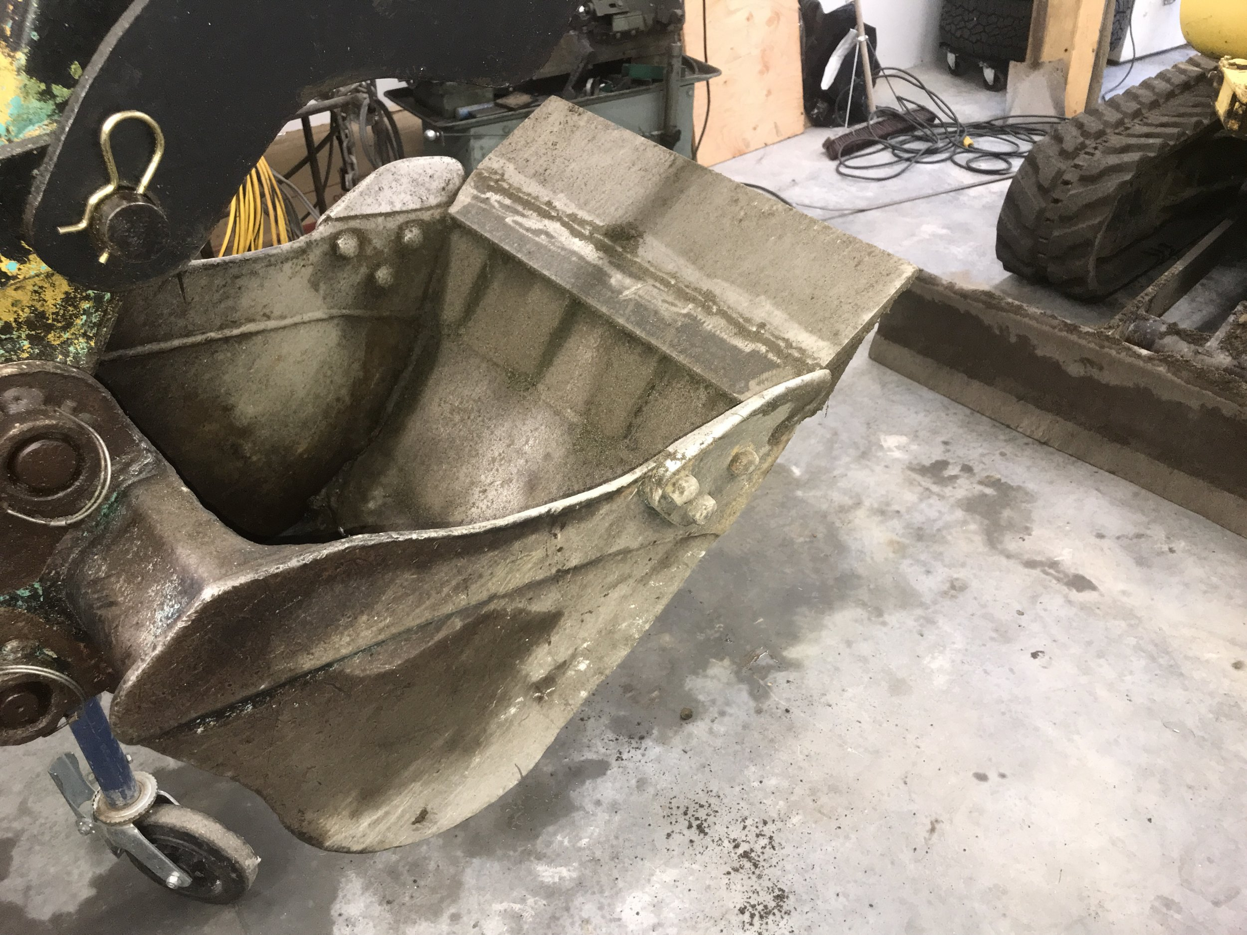

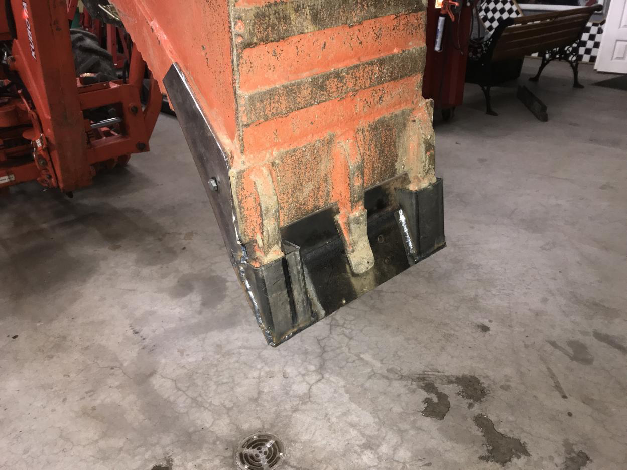

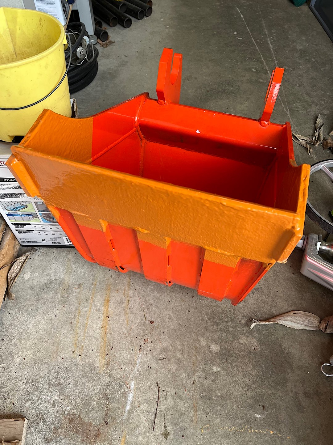

This is an older project but I just duplicated it for a mini excavator and it is a lifesaver. I apologize if such a thing already exists but I was not able to find any examples. Hopefully this is useful to someone else.
A couple years ago I was trying to dig a footing for a foundation with my 7510 Kubota and 4672 backhoe and was frustrated I couldn’t clean out the trench with the bucket I had. The large digging teeth work well to break the ground but always leave material behind that you have to shovel by hand.
I searched the forums and Google for something like this and came up blank, maybe because I have no idea what it is called, if it already exists.
Since I have only one bucket I made a solid plate that fits over the teeth and provides a smooth edge like a cleanup bucket. I’ve used the bucket many times in rough material, even for digging with no issues. I made the first one out of scraps… the flat bar rests agains the teeth so it isn’t exposed to much force. I cut rectangular tube to slip over 2 teeth and two bolts hold it in place. All the force is carried by the teeth it rests against, the bolt is just so it doesn’t fall off.
As mentioned at the top, I built one today for a 3500lb mini excavator I’m using to cleanup after the creek overflowed the yard. On this one I used 3/8 x5 flatbar and another 5/16 2-1/2 flatbar welded together and some 3” square tube.
It seemed to have a pretty tight fit so I thought I’d see if it stays put without the bolts snd so far no issues digging, scraping and pushing material around for almost 8 hours.

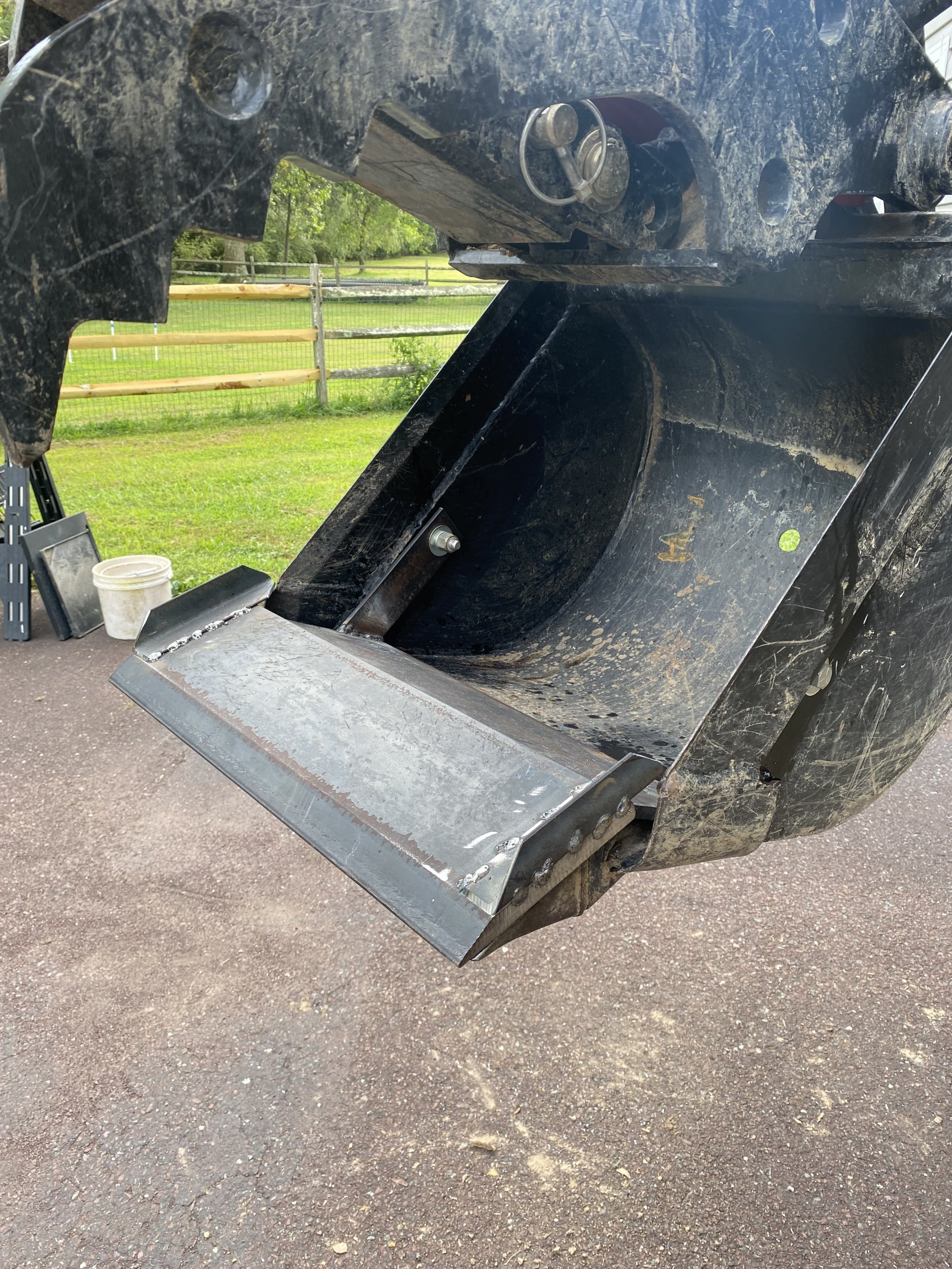

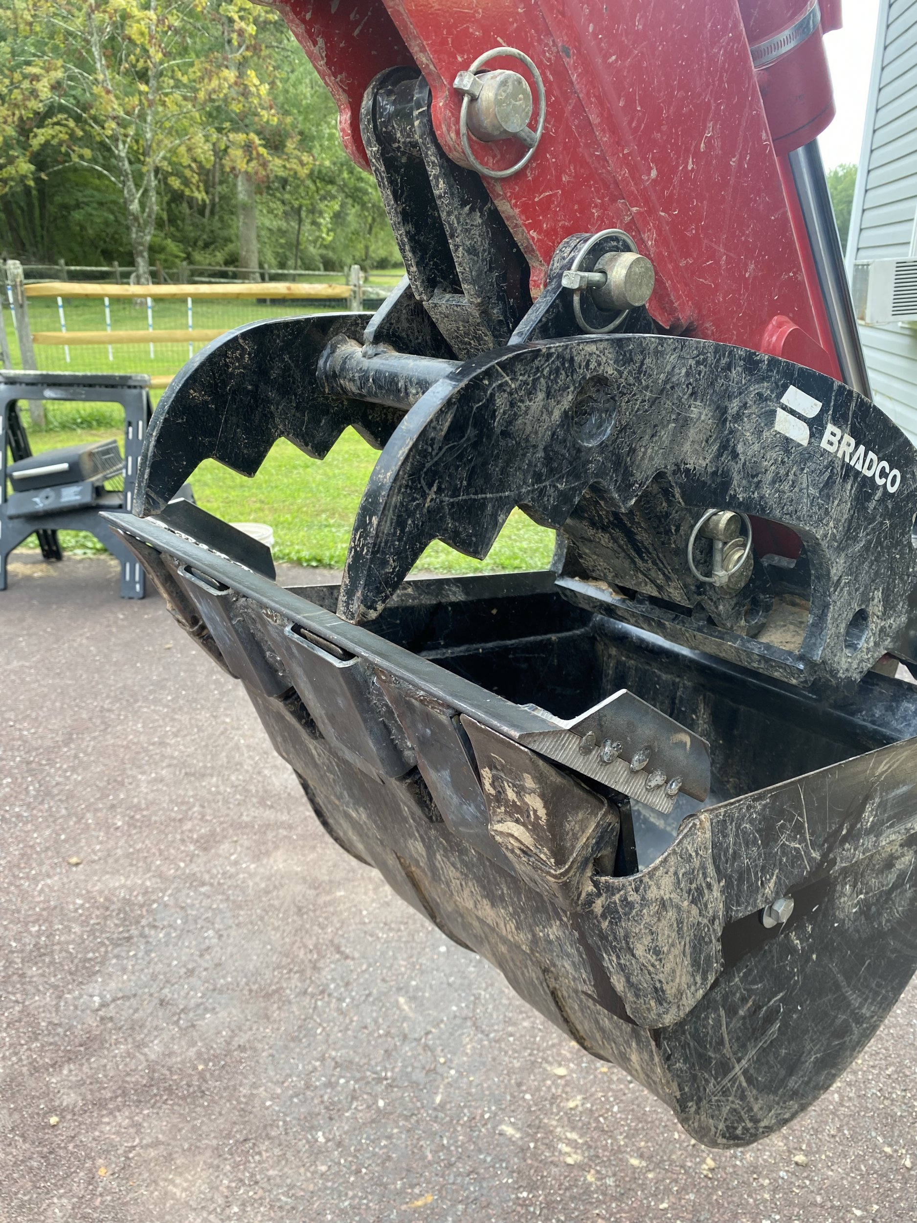

Here’s the one I made for my 20 inch bucket

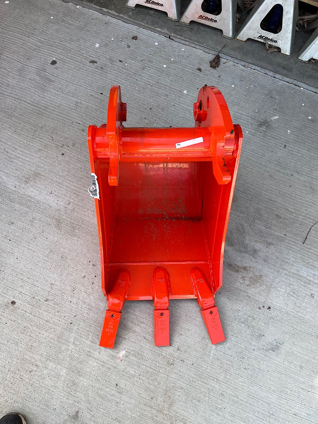

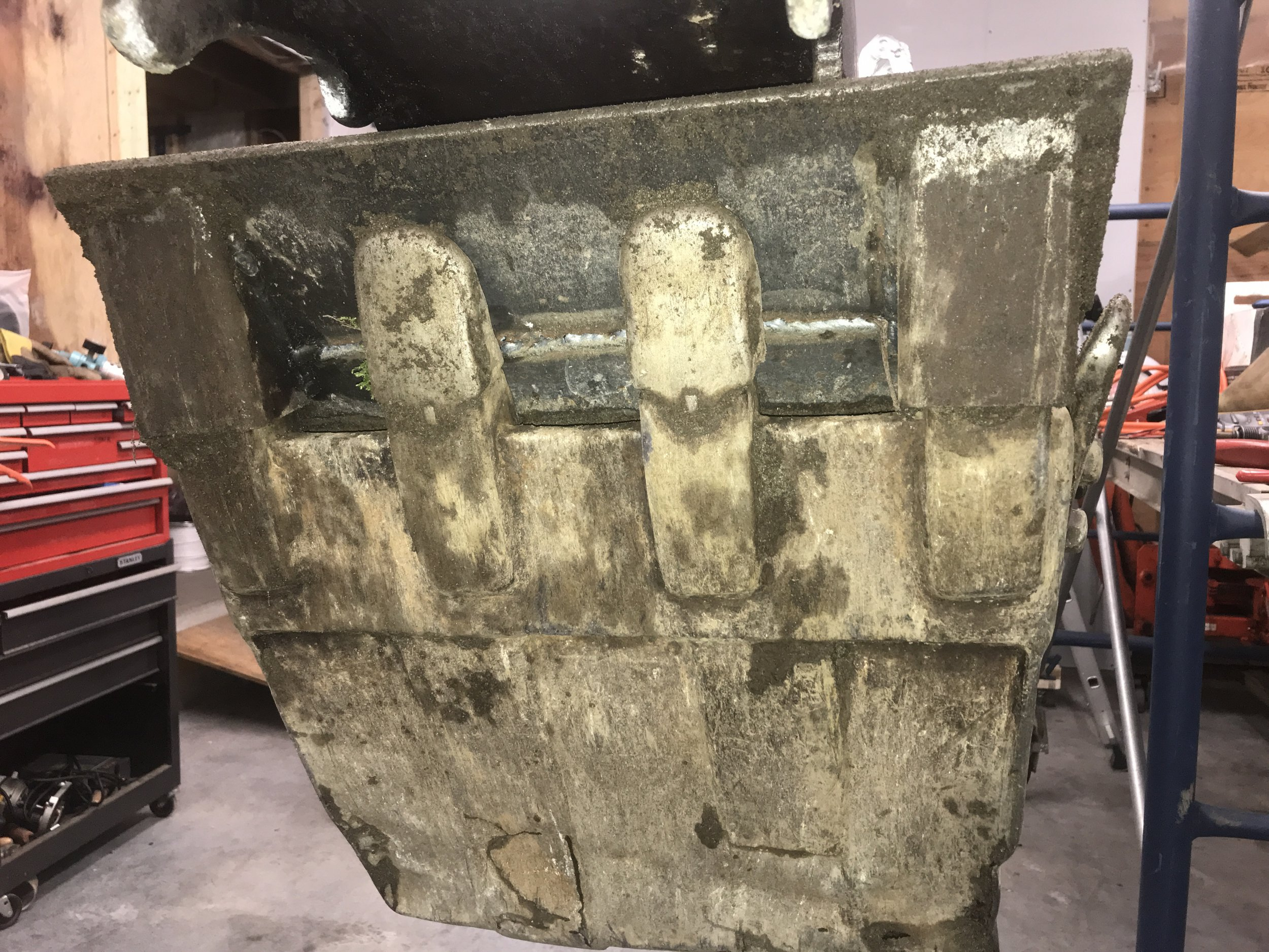

Bought a toothed bucket and had the teeth cut off.
0A3C6599-BB3B-44C3-99CD-885D6702A70B.jpeg 28607B43-7A26-4A28-805C-32BF4B660ECE.jpeg D4A42095-2D64-42CE-B2D0-244759D75EEB.jpeg

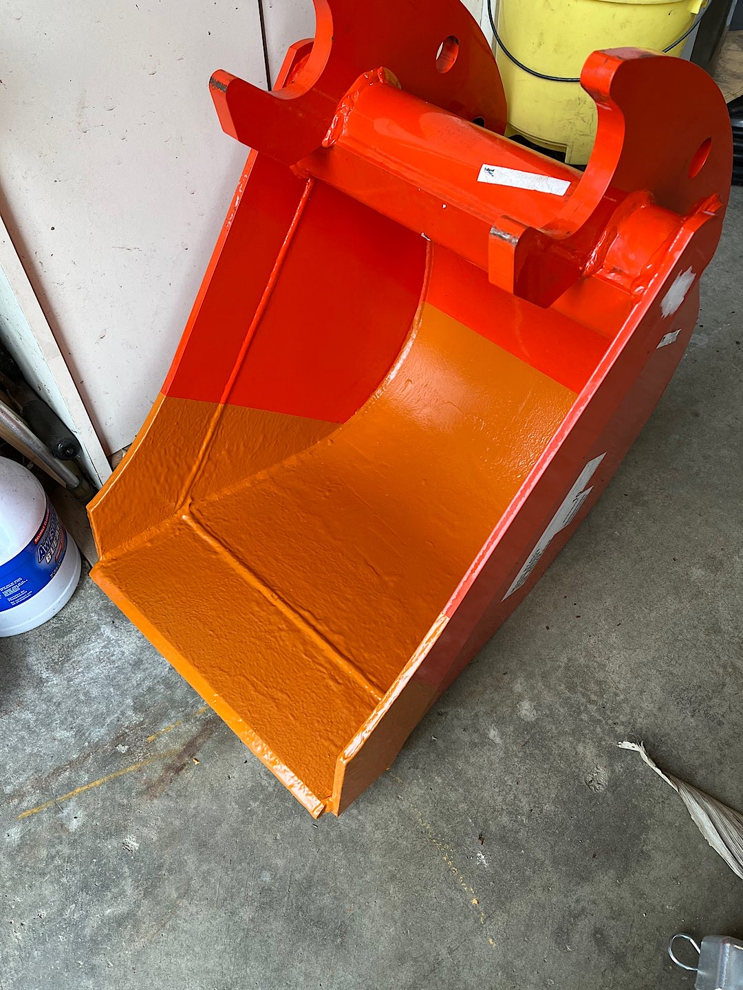

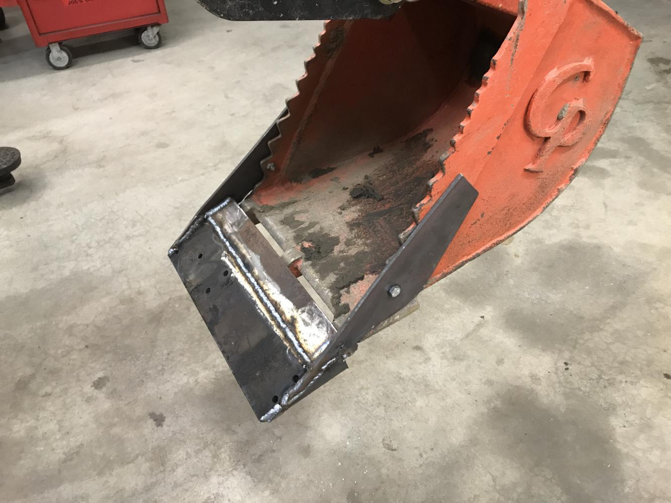

In the commercial earthworks world everyone who does trenching has at least 1 bucket with a plate welded onto the teeth. the trick is to make sure you can hammer out the pin that holds the toothshell on so you can easily change to a tooth bucket and back as required.
