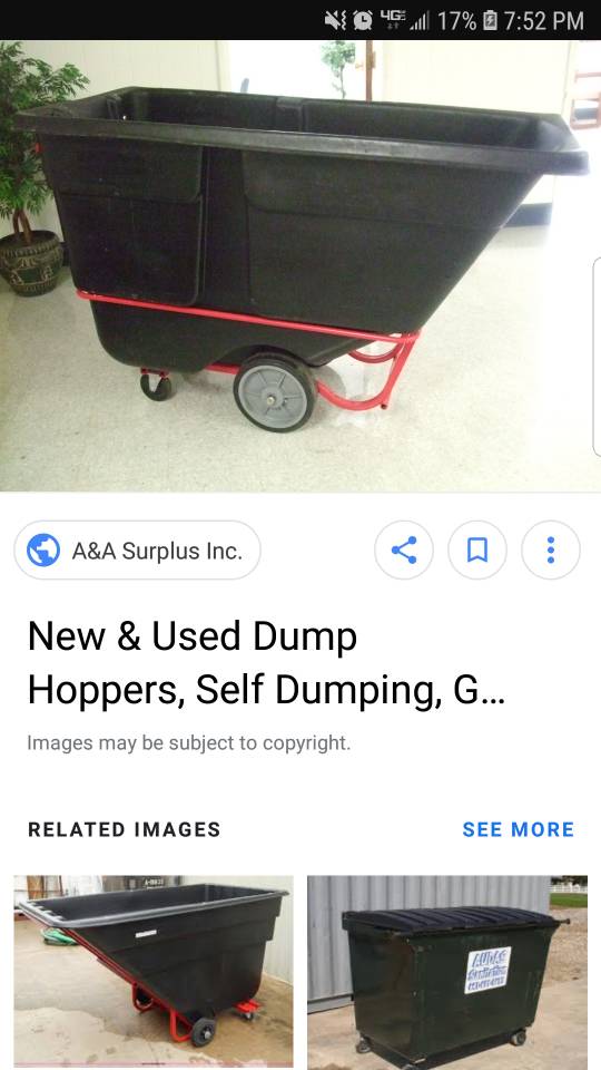

   / Designing a bin tipper, sizing hydraulics. #27
He doesn’t want to use forklift to lift it.
The ones I'm talking about are not for a forklift. Pretty hard to get a forklift into a 36in door in construction sites. Something like this and maybe raise it up higher Screenshot_20180720-195238_Google.jpeg
   / Designing a bin tipper, sizing hydraulics. #28
Those can only dump on the ground or over a ledge.
#29
yeah i definitely need the lift height so the auto tippers like that wont work form me. I guess for the single i need to calculate how big a cylinder i need. Typically a bin will weight 800-1100 pounds. so that lift you referenced is right in my range.
   / Designing a bin tipper, sizing hydraulics. #30
Are you guys not reading my posts much? Like my last one said (#27) last sentence. Lift it up higher.
