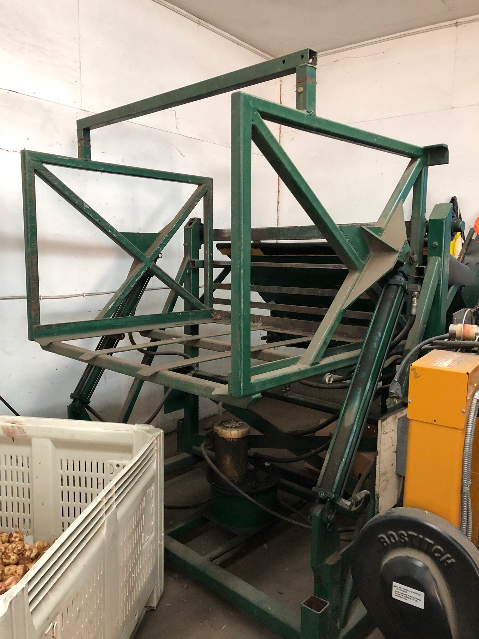

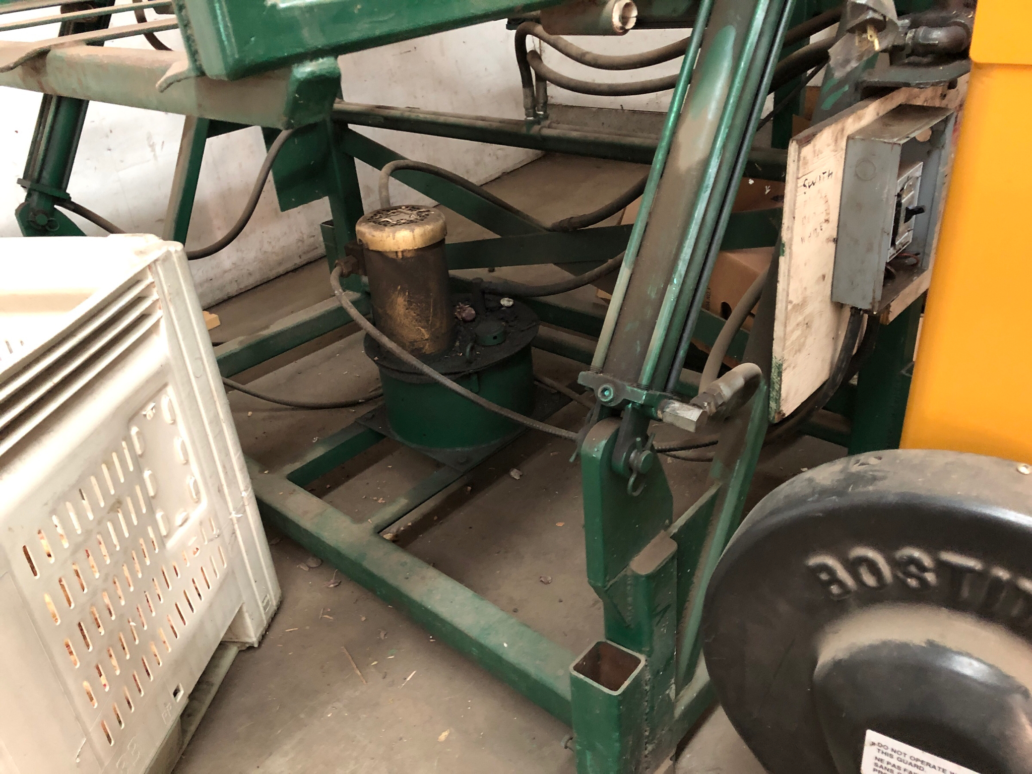

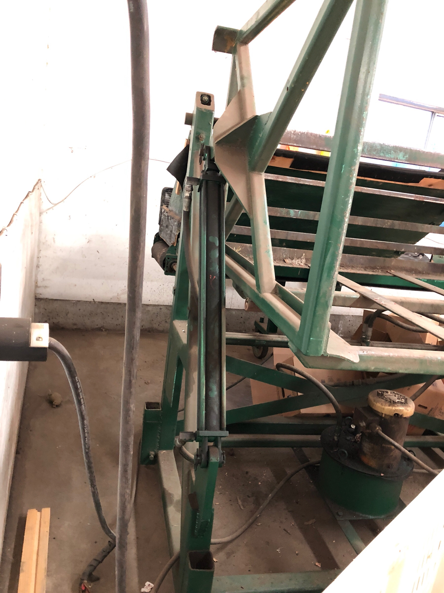

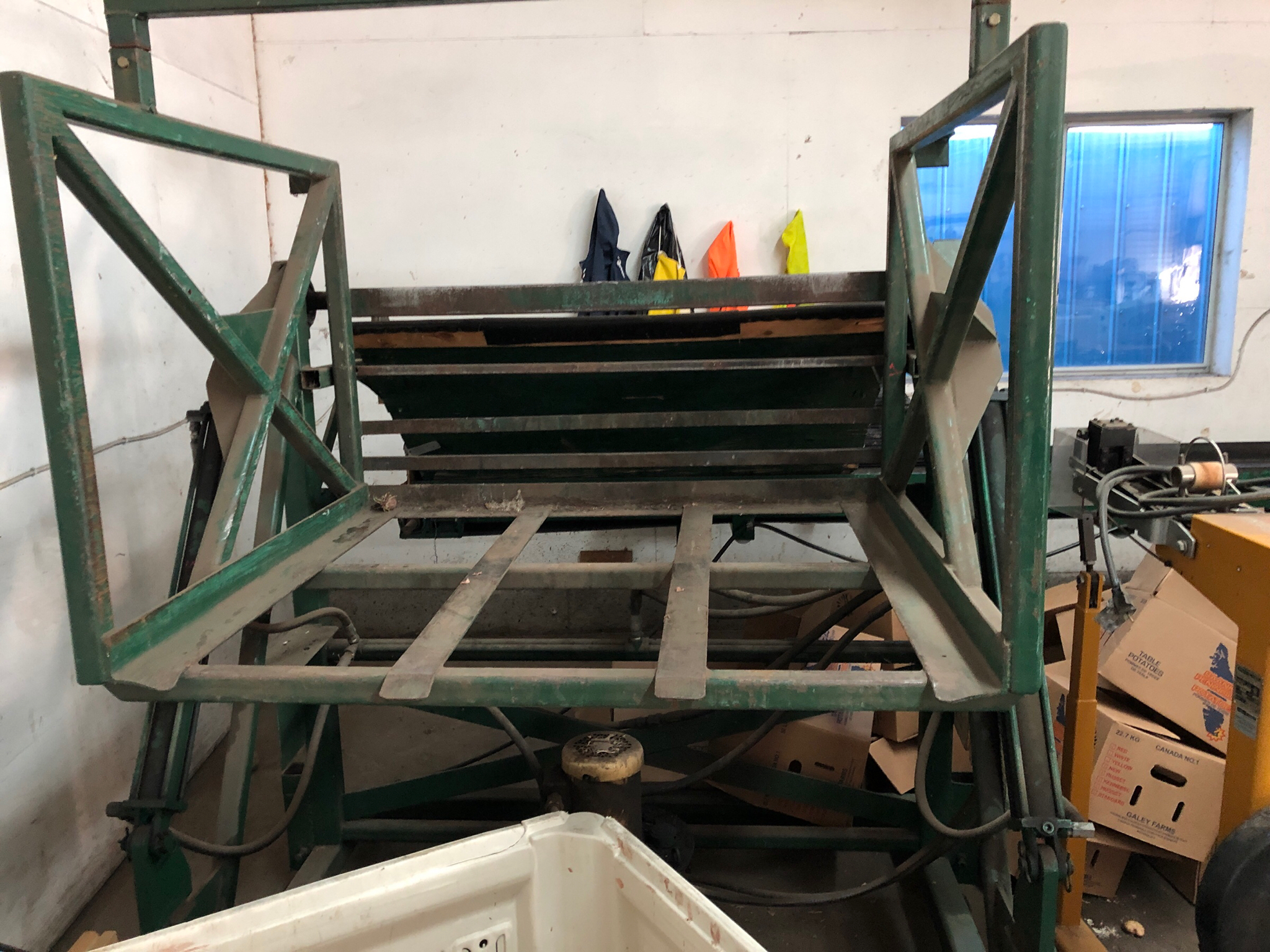

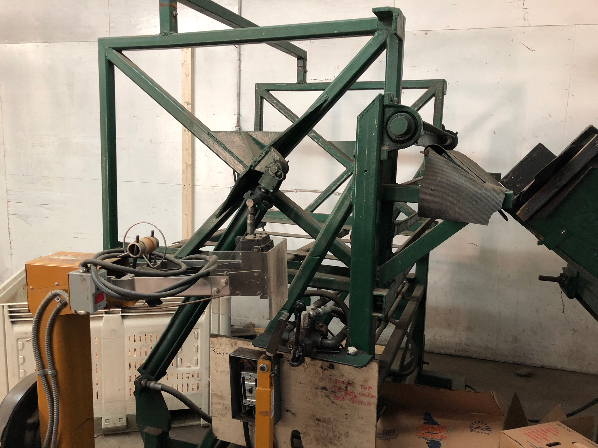

We never used bin dumpers on the farm.
I’ll go over to my neighbor’s later and see if I can grab some pics of his.
   / Designing a bin tipper, sizing hydraulics. #19
Okay I grabbed a couple of pics.
A forklift is required to load the bin onto the dumper. Hope this helps.
#20
Awesome pics, thanks for grabbing those. I see they have the pivot much higher in that design. That really mitigates the need for long stand out legs to help the tipping. It also looks REALLY burly, more so than I thought you would need. I suppose though it's a heavy duty commercial version so that makes sense. Built for constant use. Also noticing the pillow blocks for the pivot, I had wondered if i was going to need that, or a bushing / pin would suffice.
