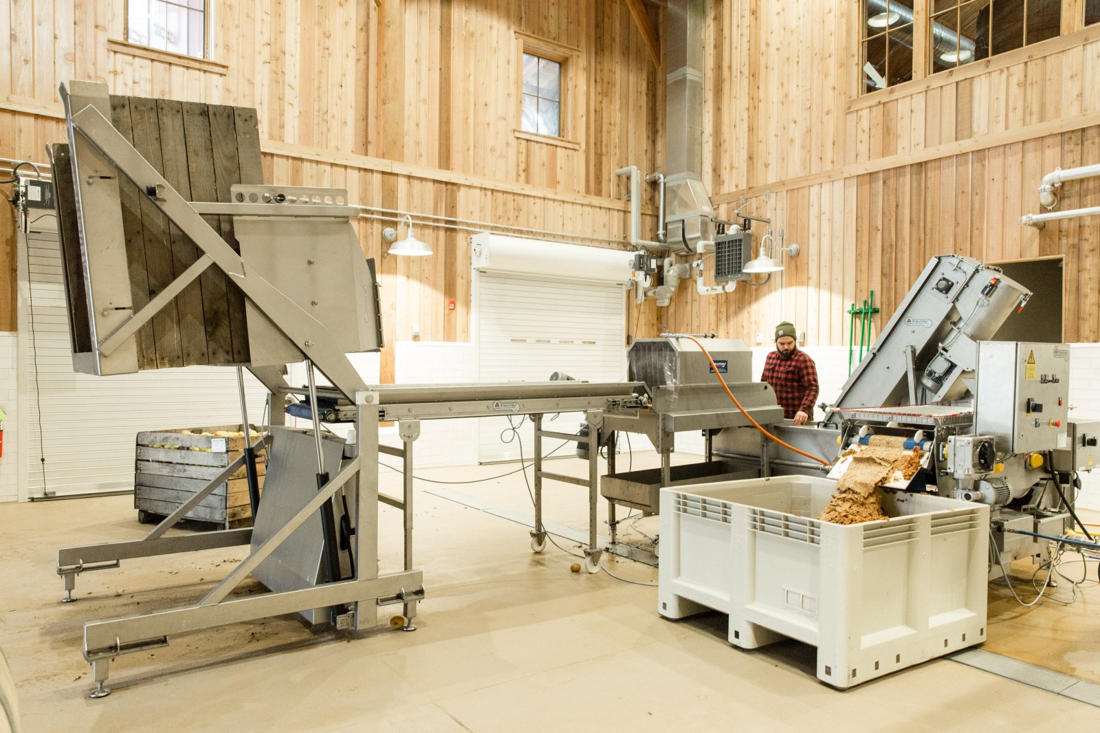

Ran across a commercial standalone bin dumper picture today and thought I would pass it on:
attachment.php
Source: A Year In The Life of A Cidery – Angry Orchard – Medium
