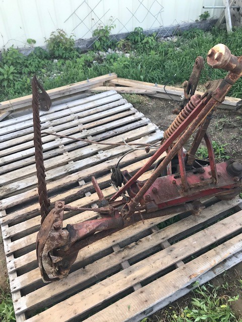

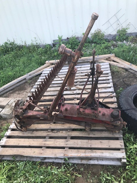

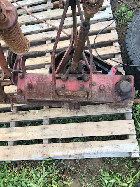

Hi all, I recently picked up a Dearborn 14-15 7 sickle bar mower for $200. I have the manual and I致e been looking it over, it appears that there is supposed to be a bracket on the right hand side. I have a Mahindra 1533 tractor, I thought this would just be a standard 3-point hookup but now I知 wondering if I知 over my head. This is my first go at this and I知 finding myself learning a lot of lessons the hard (expensive) way. Any help on how to hook up is appreciated, the manual only references hooking up to a 8N/9N style tractor.

There's a bracket that clamps to the right side 3pt arm. It creates another pin to fasten the trip mechanism to. I'll try to get a pic of mine today.

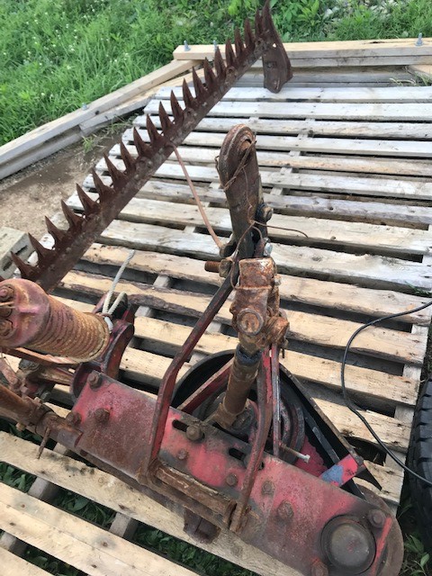

Yes, I知 pretty adept at most 3-point hookups, this breakaway bar has me stumped though. I can稚 seem to find a way to attach it since I don稚 have the original bracket. Was hoping that someone had some experience with this particular model. I don稚 have a lot of tools for fabricating, unfortunately either.
That would be great! Thank you!

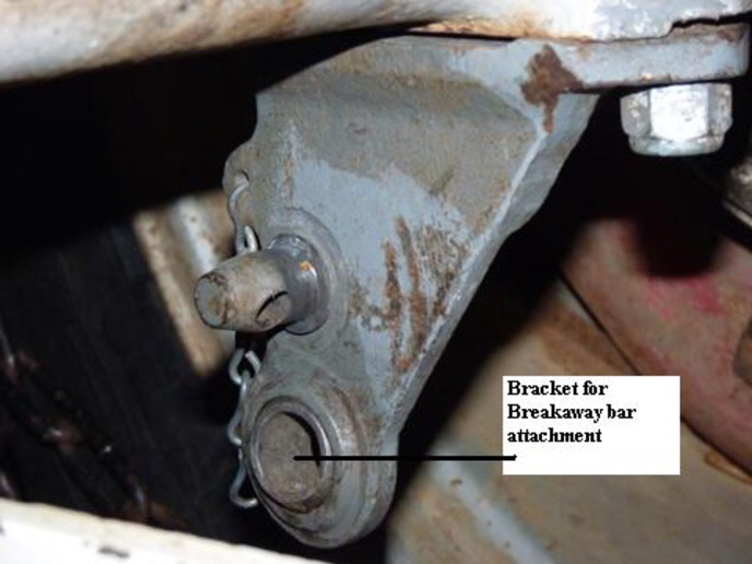

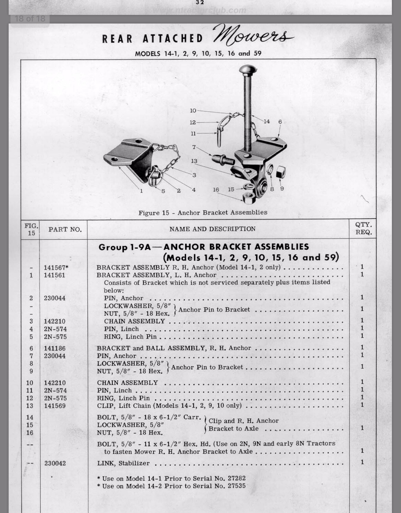

Are you talking about the anchor brackets that attach to the tractor? IMG_1108.jpg

You only need one, depends on the setup, but yours would need a right hand side bracket. For yours it will not be a bolt on part, you will have to hook up the three point and then see were the arm ends up on your tractor and fab a mount for it. I’m not sure what your talking about as for a stabilizer on the left side.

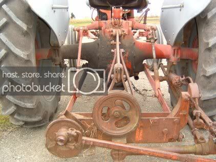

If your talking about this pin that I have circled, that’s were your left hand lift arm mounts. IMG_1111.jpg
/ Dearborn 14-15 on new tractor #12
That left bracket is a standard for those old Fords. They used them on both sides on the bottom of the fender bracket bolts and allowed for bars to be attached to those stubby pins (other end over the 3 point pin on the attachment). TSC still sells those generic bars, but you won't need it on the left since your Mahindra has it's own stabilizer.
/ Dearborn 14-15 on new tractor #13
There you go, a bit better explanation.
