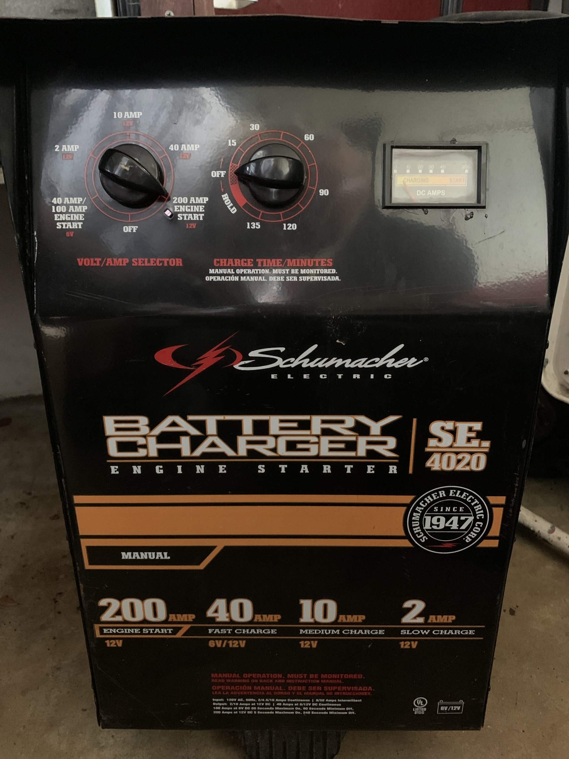

I’m trying it now, turns out I had a charger with the 200 amp setting.
Buried and didn’t know I had it.
The battery I’m trying it in was seemingly dry when I took the caps off.
I filled it to just below the proper level and hooked up charger.
The water immediately started bubbling and coming out over the top.
I wont fill the next one as much.
My cables are getting warm, I’ve turned it down to the 40 amp setting, the battery is still bubbling/boiling but I feel more comfortable.
Big numbers difference between 40 amp and 200 amp but maybe if it’s still boiling at 40 amp it means it’s still working?
Anyway I’d rather do it a few more times at 40 amp and not burn up anything if at all possible.
I started out at a 12.68 reading on my multi meter before I started, not sure why at over 12 volts it wouldn’t even hardly make the lights come on for my Kubota?
Anyway will keep you posted
You’re not putting current into your battery at a 200 amp rate. Your charger probably has a 200 A on it for advertising peak current when using it to start an engine. Most likely your charger is rated 10 amps and is outputting less than that when charging your battery, especially since you measured 12.68 volts

#26
Charger

200 amps is what could theoretically flow into a starter motor with almost a short circuit resistance. 14-15 charger volts on a 12 volt battery is only a potential 2-3 volt differential. It won’t flow 200 amps. Trust me
/ Dead battery
#28
I understand
